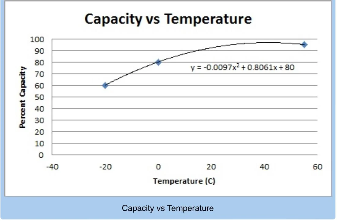

Yeah, fair, some stuff online says less than 1% but who knows what test conditions. Still, less than 10% loss down to 14F sounds pretty good. If you live in a place that gets to -30C, well, that's just poor planning. ;)
Hopefully for long trips where the battery heating is amortized, the hit won't be 30% on the Lightning. I don't think I'd consider buying one in a cold climate if the loss was that great.
3,925
5,095
The change in battery capacity itself is more than 10%.

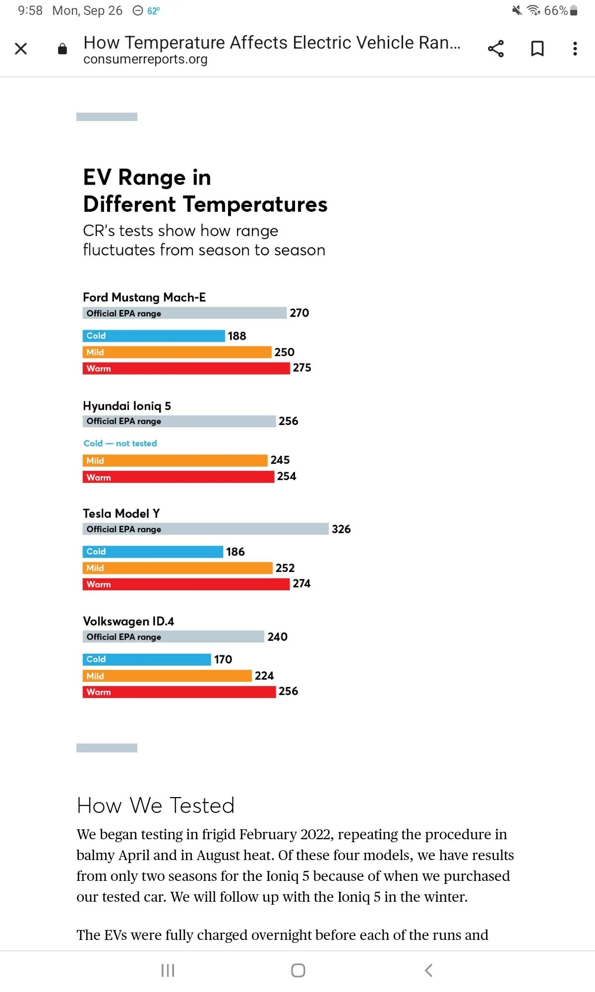

Tesla's only lose 1-3% of range in the winter (supposedly). The mach-e loses 28% in the same conditions which is absolutely terrible. If the Lightning loses 28% too, that would be a major blow to its utility. Hopefully they've improved that. We should know soon.
No true. Consumer Reports just tested. For those interested in the full article, you should be able to access CR for free via your library's website.

Tesla's these days with heat pumps don't lose as much and I'm a fan boy, but they will lose more than reported. Real world experience as an owner is likely around 15% in North Texas, but if truly varies for every owner and situation. How harsh is the winter, garage kept, pre-conditioning, how hard is it still being driven, how many starts do you have during the day that you preheat for. You'll get some averages, but never a real number.
