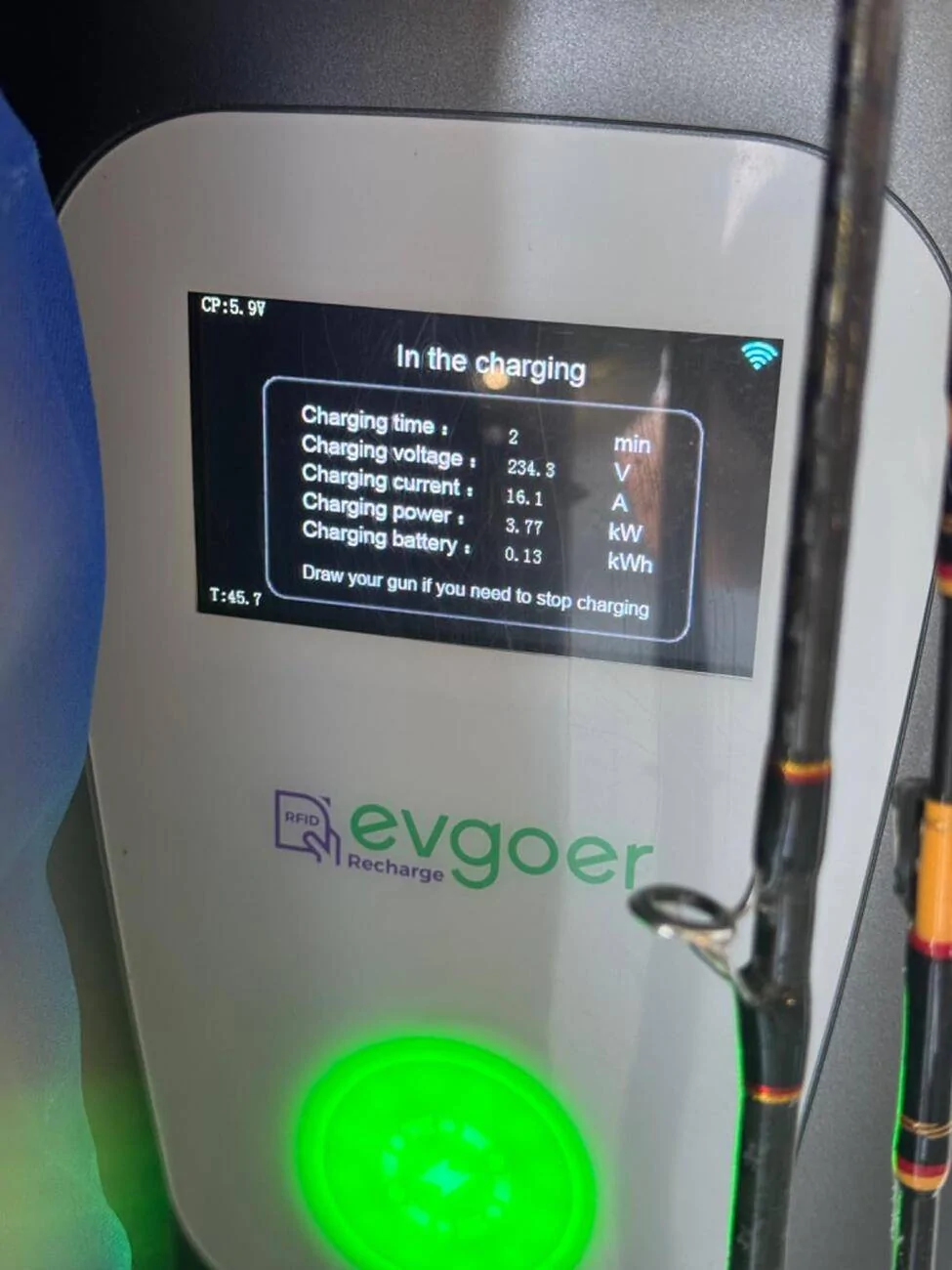

Found this on the Amazon reviews. I may live in Texas, but I think my neighbors would frown on me drawing my gun every time I want to stop charging.
