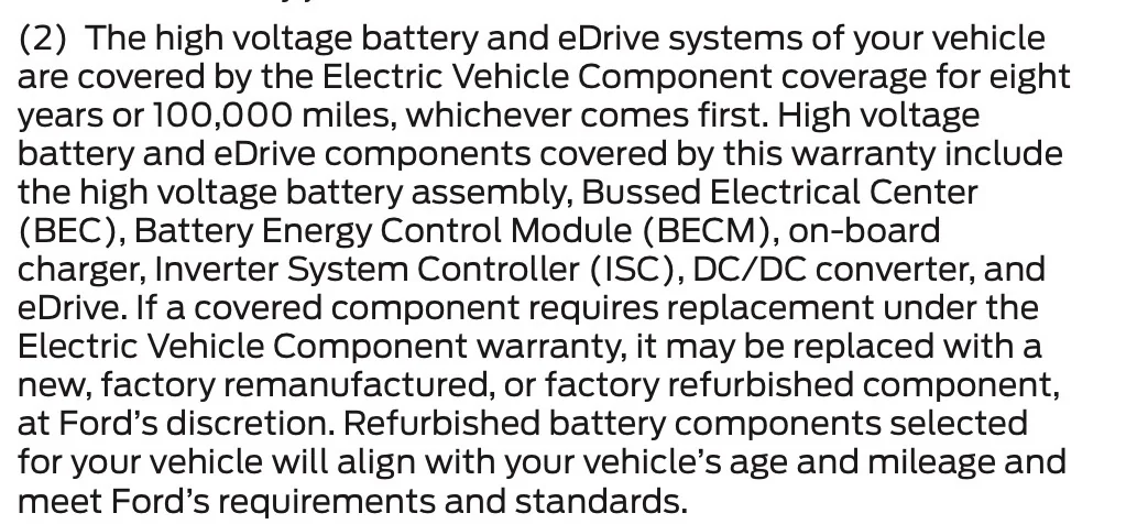

Basically the only thing Ford will fix/replace under the EV Powertrain warranty with no questions asked is the drive units and battery.
That‘s not accurate. Here is the from the warranty booklet:

My charge port and associated wiring on my Mach-E was replaced under the EV component warranty. I didn’t even have to ask. When I picked the car up, the service writer told me it was covered. The car was past the 3/36 warranty.
Thanks for posting this, but I have heard of both the DC/DC and SOBDMA both being paid for by customers under 100kmi,, I DO think it has a LOT to do with the dealer. I'm sad that this dealer wasn't interested in helping the OP. If he'd have just had some more time I think he could've got this 100% covered.

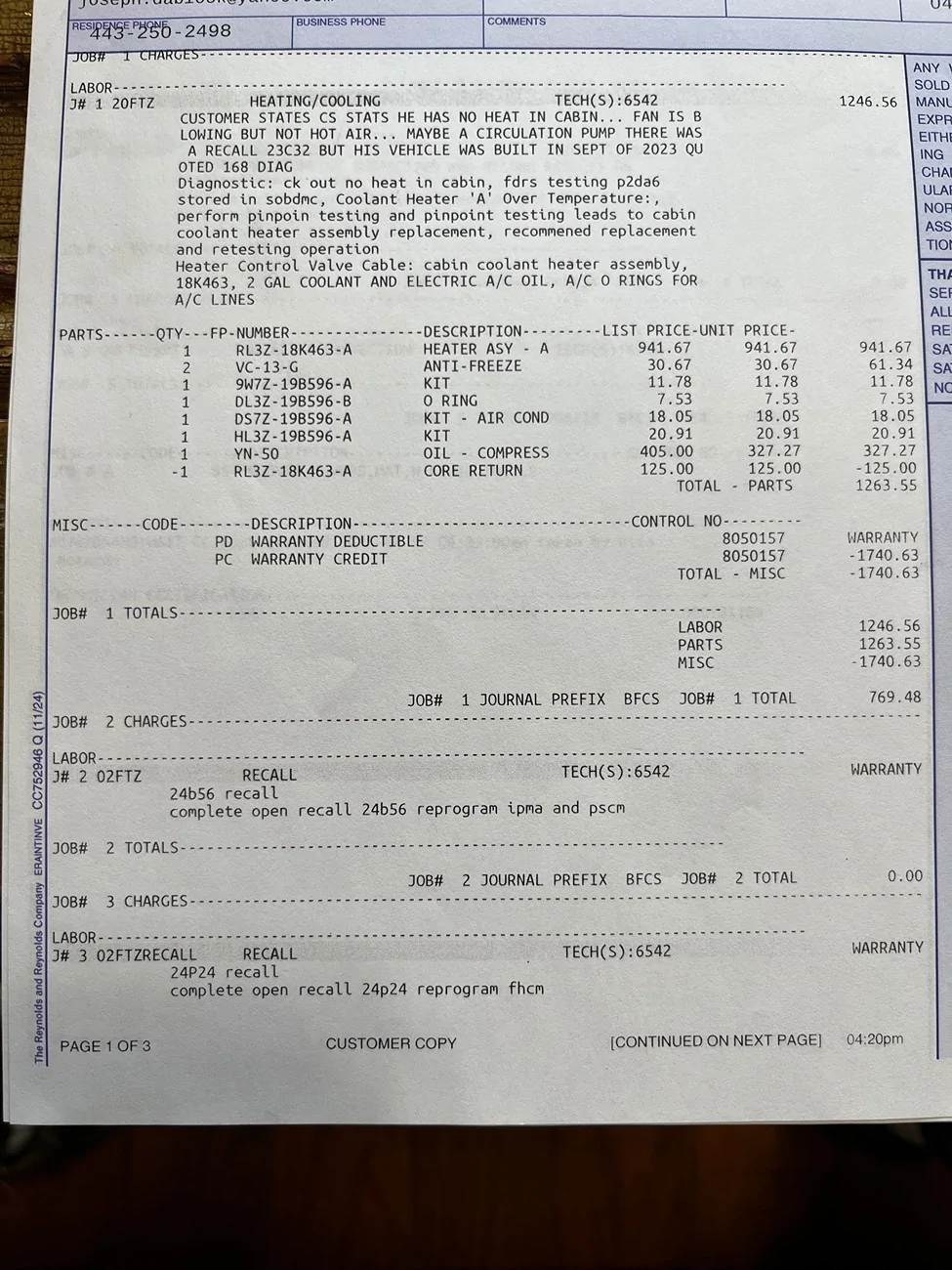

This probably too late to help you , but here is a photo of my invoice with the heater assembly replacement. Mine was at 36,800 miles and missed recall by one month. Ford showed some mercy and covered 70 percent ($1,740).
So it looks like they do indeed do a coolant flush when they replace the heater according to the 2 gallons line item.
Geeze, they charge almost double for that heater than what It sells for.

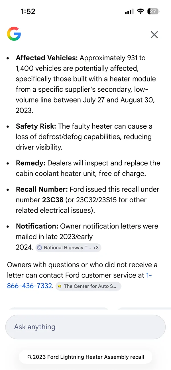

It says it found a stored code. Wonder what the date was for the code? Might have been while under warranty.
