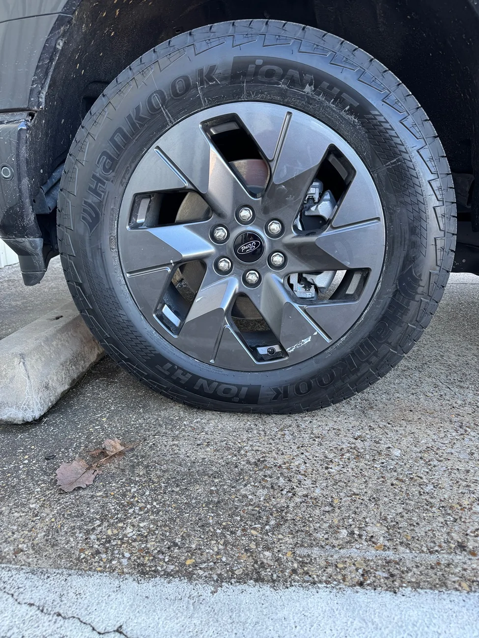

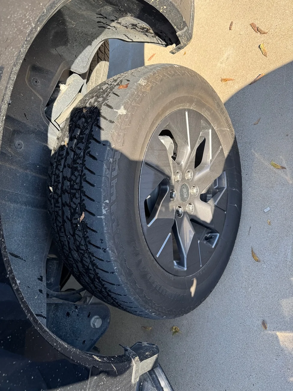

:O your old ones are almost slicks already
Yeah, back ones weren’t as bad as the front but not far off
A little over 27,000 miles on the OEM is pretty poor but these have an 80,000 mile warranty so hopefully better!

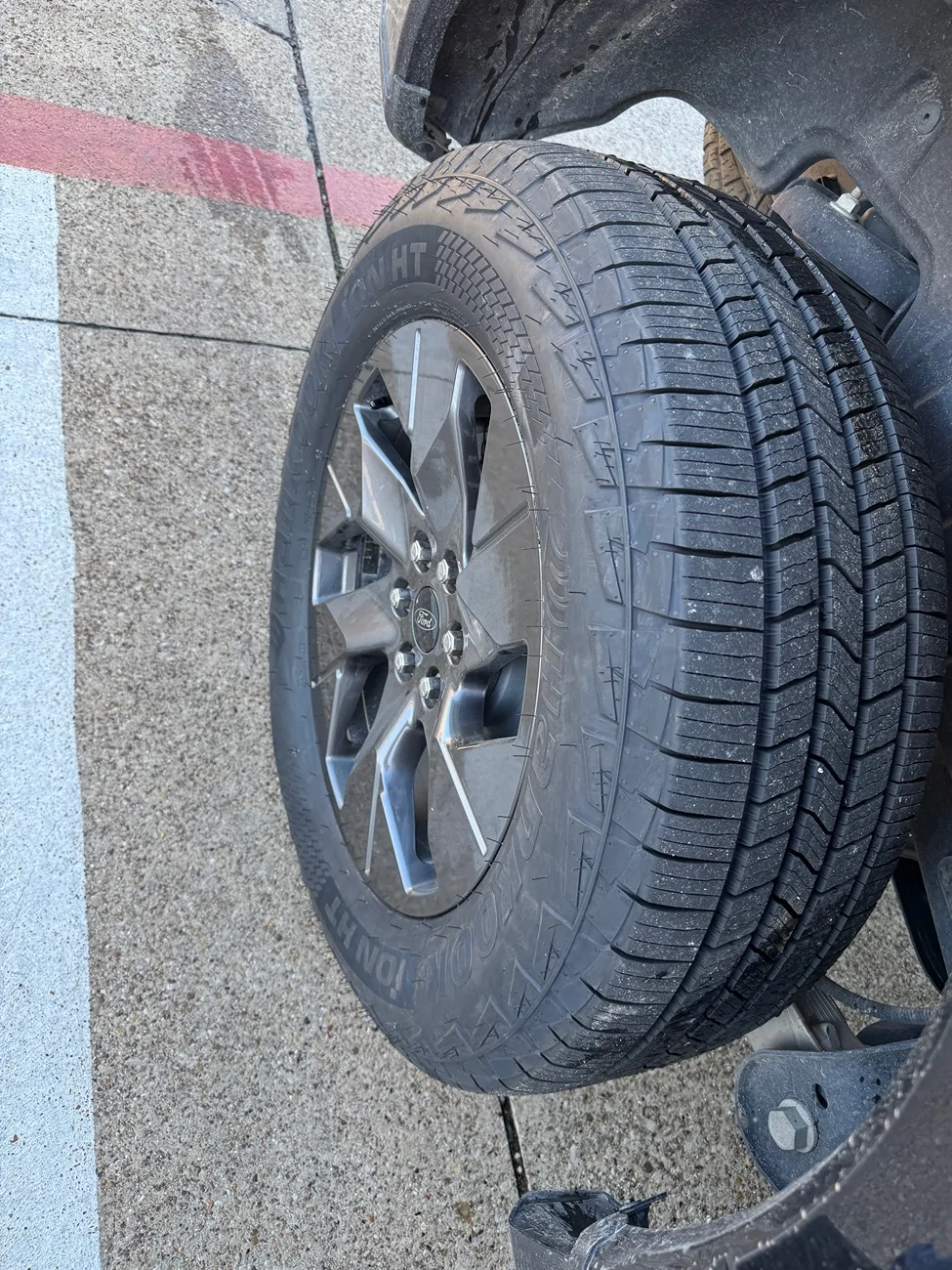

Not much in the way of updates for these tires on any forum or reddit post, so I took the plunge and ordered them from SimpleTire, was $955 shipped. Should be delivered in the next few days, but can't get them mounted until RockAuto ships some new tire pressure sensors as they're going on some VR601s.
Hoping to preserve as much efficency I can.
Looks like they needed more air based on the wear on the outer edges. Door jam sticker lists 36psi but that's way too low on the Hankooks. Have almost 20k miles now and seem to be wearing great. Certainly better than the oem goodyears on either of the Tacomas I've had.

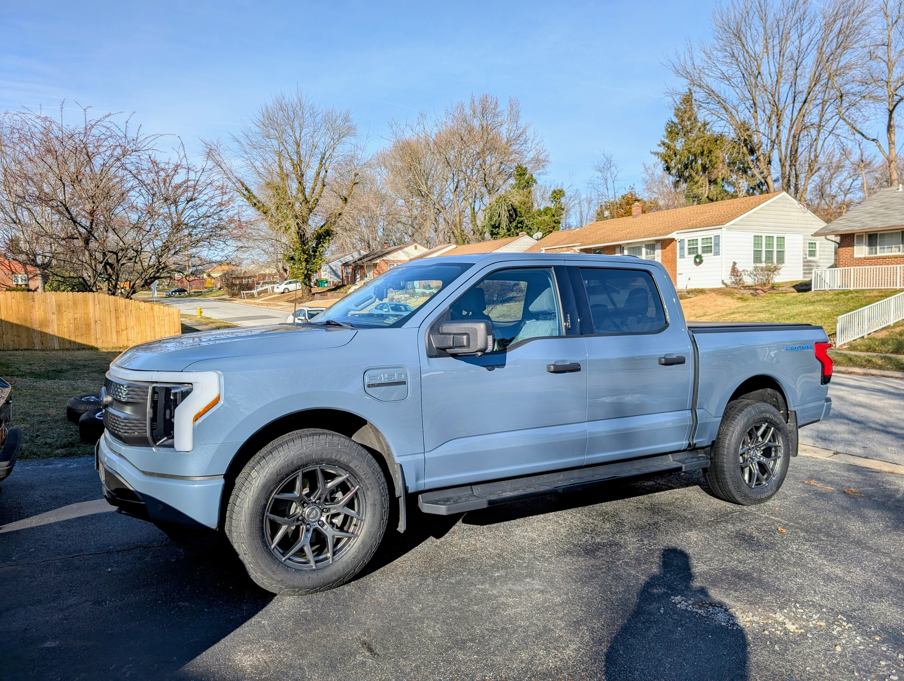

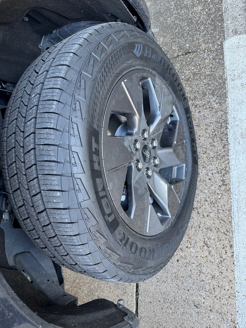

I was an idiot and didn't catch that I ordered 275/65s until after they were mounted, but just got them thrown on my wheels today:
Ford F-150 Lightning 100 miles on Hankook iON HT EV tires - review & range / consumption data D3RfXek
