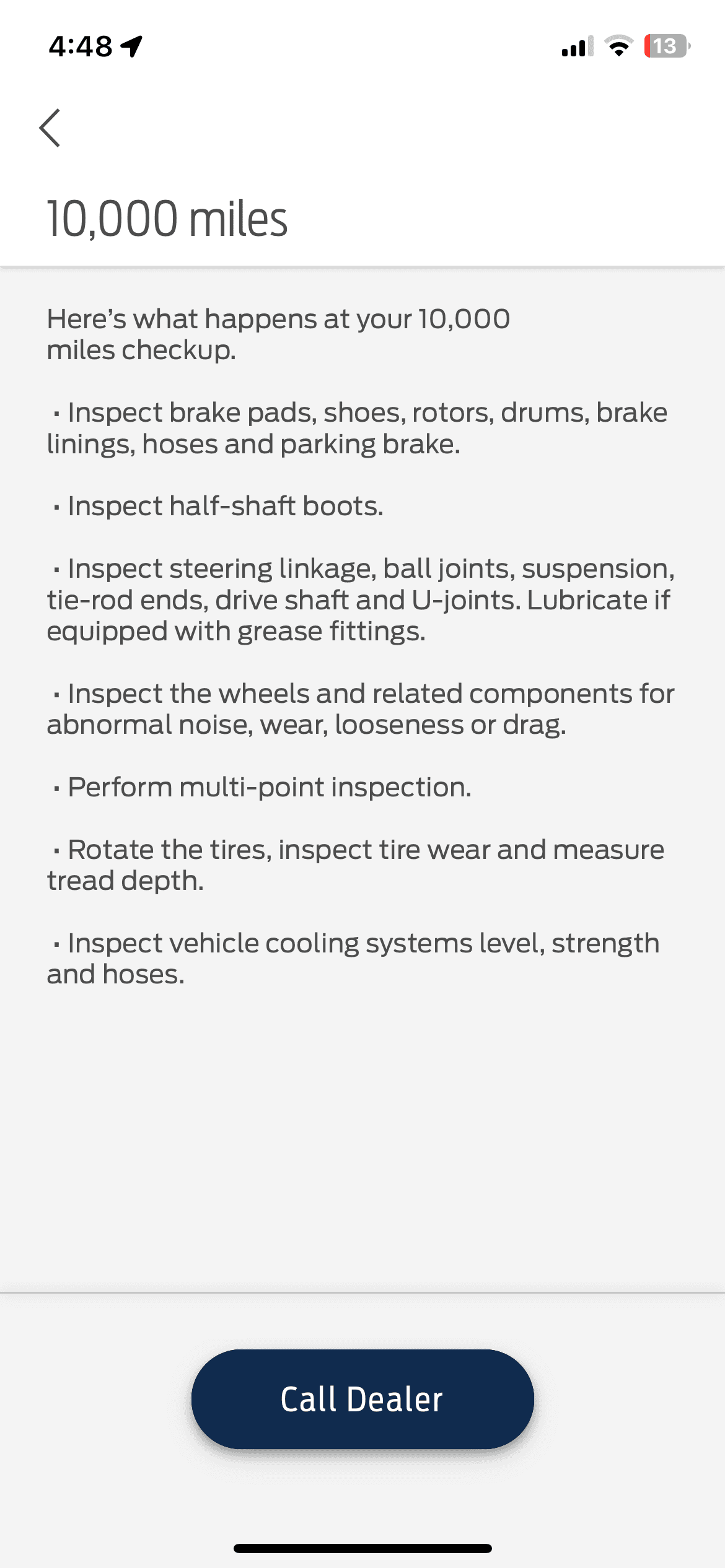

I own several Fsuperdutys. The 2016 F250 6.7 runs the orange coolant and until ‘20 model year (I have one of those also) requires a refresher in Chemistry 101 every 15k miles. Not just checking level but ph, nitrates…. There’s a test strip and special additive, plus a quantity of orange removal / then additive replacing orange coolant required based on testing results.
My concern is, the local dealer was clueless about the engine block material science and how critical the right testing and resulting treatment every 15k miles could impact the engine life. I’m really concerned if there is a similar requirement when testing the “coolant strength” as deemed necessary in the bullet of the generic 10k screen pop sent by Ford.
What say you smart people? Any of you aware what the true definition of “coolant strength” is for a Lightning? I searched the web and this forum and found no mentions related to strength. Any of you Ford Master Techs wanna weigh in? Thanks in advance!

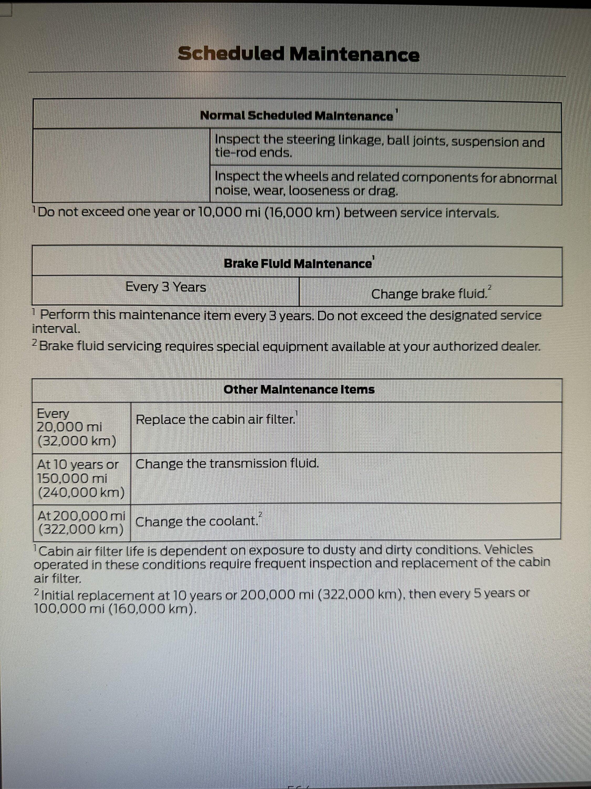

The owners manual has you checking it every 6 months. It's also part of the 12month/10000mi checkup. Initial replacement is 10 years/ 222000mi and then every 5yr/111000mi.
Heres how you check it, from the owners manual:
Maintain coolant concentration within
48% to 50%, which equates to a freeze
point between -29–-35°F (-34–-37°C).
Check coolant concentration using a
refractometer. We do not recommend the
use of hydrometers or coolant test strips
for measuring coolant concentration.
