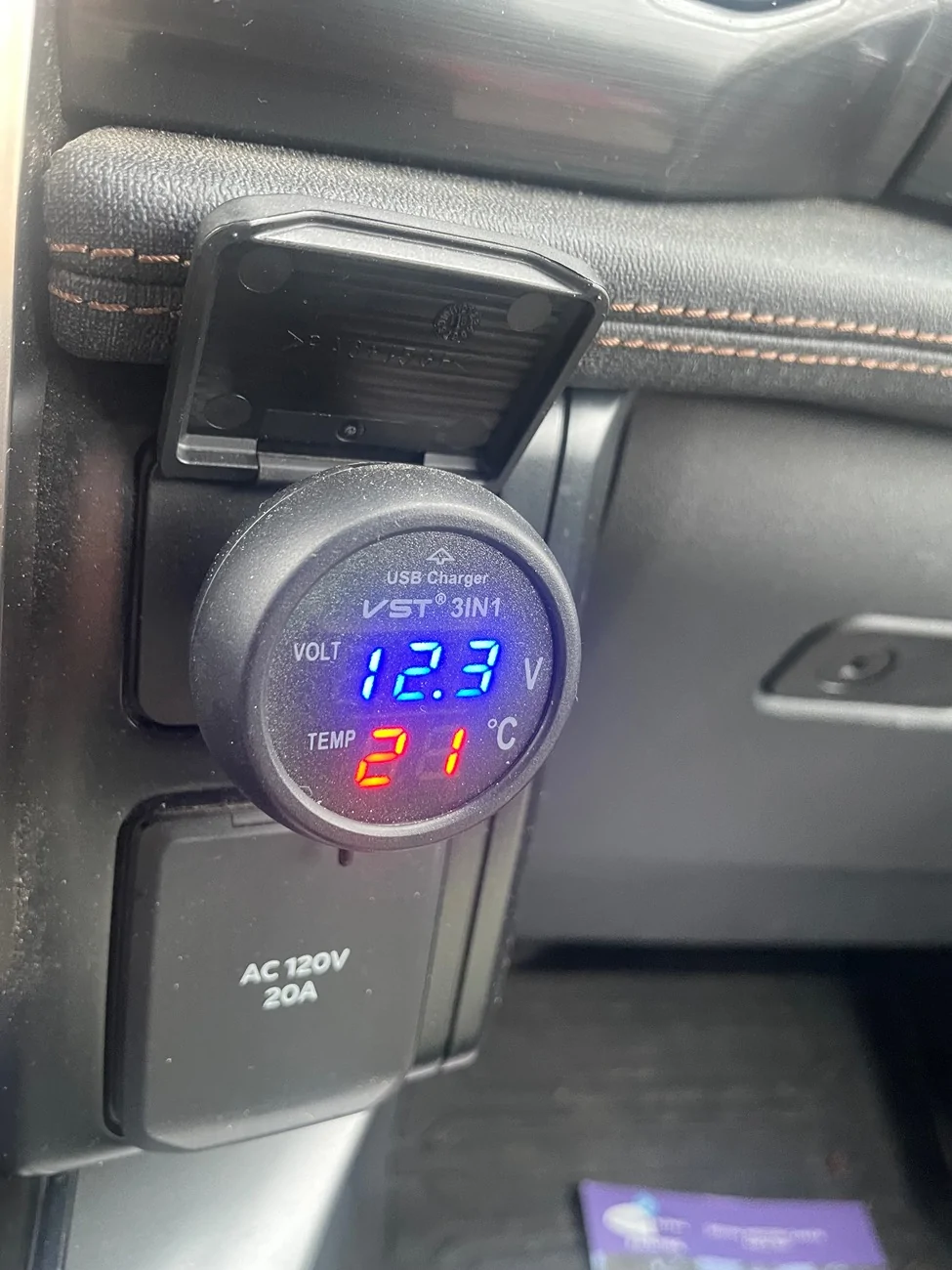

I bought one of these online .. very inexpensive and I can see what the LVB is doing all the time.. the cabin temp is a bonus!
Awesome idea - just annoying that I would have to do that when I can call a ford dealer and service can just tell me my 12V battery %. If they can see it, I should be able to see it easy
