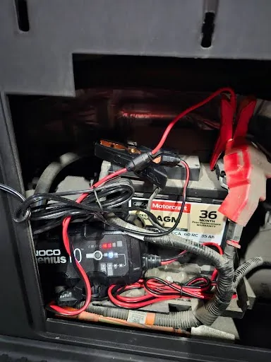

For many years and multiple threads on this forum, I’ve read about the problems with Ford’s inability to keep the LVB properly charged.
Behold my Kentucky engineering: It was as simple as plugging in my NOCO Genius 10 into the frunk’s 120v outlet and clamping it onto the 12v battery.
Let me know if I did something wrong. The red clamp is directly attached to the + terminal. The black clamp is attached to the BMS(?).

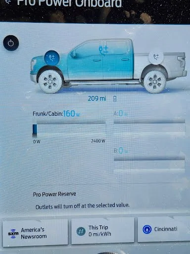

It draws 160 watts.

When the truck is on, the DC-DC converter is also on and will put out anywhere between 13.6-14.6ish volts to charge the battery and power all the 12V loads you’ve turned on. The Noco is somewhat redundant.
With the latest powertrain update being released, 22-23’s can have the ability to have ProPower on with truck off and the Noco 160 watt draw would meet the minimum load requirement.

Yeah, I mentioned it in another thread, I tried this and the DCDC seems to stay on so long as PPO is, you can check it for yourself if after about 5 min it switches to float mode it would be the case, it should switch to <90W at that point. You may want to check that you have the charger on the right terminal as well.

Ford F-150 Lightning 12v Battery Perpetual Charger (while truck is on) IMG_6024-battery BMS sensor
About the BMS sensor: here is where the negative connection should be for any maintainer (or to a ground point), downstream from the sensor.
Another idea would be to have some kind of auxiliary energy storage box w/inverter that you could keep in the frunk that is charged up with the 120v ppob when the truck is on, but that you could plug the maintainer into when the truck is off and parked.
That was what another poster came up with in another thread somewhere.
If you have the ability to have PPOB on when the truck is off, as some do, I am not sure if the DC-DC converter is on or not in that condition. It might have to be to run things involved with controlling and reporting etc. re the PPOB.
But anytime the DC-DC converter is on, the maintainer is superfluous and won't do any good, or harm.
The maintainer should sense full voltage and turn OFF (float mode), so no danger of overcharging the battery. No DC current can go "in reverse" into the maintainer either.
