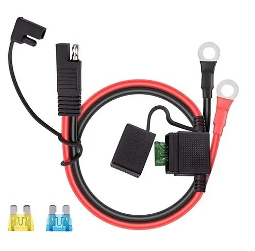

I now have mine on a NOCO Genius1 trickle charger in AGM mode when not using the truck, or charging overnight which I expect to keep it healthy for a long time.
After reading about all the problems people have had on this and other forums, and having an OTA failure due to the 12v battery SOC being below 85% or so, I bought the NOCO Genius1 to avoid problems.
I put an SAE cord inside my charge port to make connecting the NOCO easier - just a small hole in the plastic and a 5 ft fused SAE cord with ring terminals to the battery (negative downstream of the BMS - connect at blue circles not red Xs) on the 6mm terminal screws:
Ford F-150 Lightning 12V battery replacement poll 0-My Lightning-IIMG_6004
Ford F-150 Lightning 12V battery replacement poll battery connector
Ford F-150 Lightning 12V battery replacement poll where to connect to LVB
BACKGROUND:
I've had lead-acid batteries, including AGM batteries, last over 14 years when on a trickle charger. As I learned in engineering school, unlike Li batteries, lead-acid batteries love being kept at 100% charge!
However, as I approach the end of my 3yr bumper-to-bumper warranty period I may unhook it from the truck and load-test it with my UT673A-675A battery tester.
If the indication is I need a replacement, I will use the 3yr warranty to get a new one.
If the test indication is the battery is still good, I will keep doing what I'm doing with trickle charging and feel confident it is not going to die any time soon.

Wouldn’t just plugging in your charger to the charge port accomplish the same thing, even if you’re not charging the battery? I’m not trying to be a smart ass, I really want to know cuz I’ve been wondering about this as well. I have several Battery Tenders and considered installing the wiring to utilize one of them. I just didn’t think it was necessary if I left the truck plugged in.

The LVB receives extra DC/DC charging only when the HVB is also charging, once the HVB reaches target SOC cut-off then the truck resumes its other LVB maintenance strategy.

You'd think so, but you'd be wrong - BTW, no offense taken at the question, it is a reasonable ask.
Here's a good post about how the LV 12v battery gets charged from the Mach-e forum applies to the Lightning as well. The only thing I would add is be sure to use an AGM suitable charger.
https://www.macheforum.com/site/threads/how-to-get-failed-otas-to-install.29749/
I repeat, be sure you get a trickle charger suitable for AGM batteries - they are different and some trickle chargers do not have an AGM mode.
The NOCO Genius1 has an AGM mode, as do many others.
