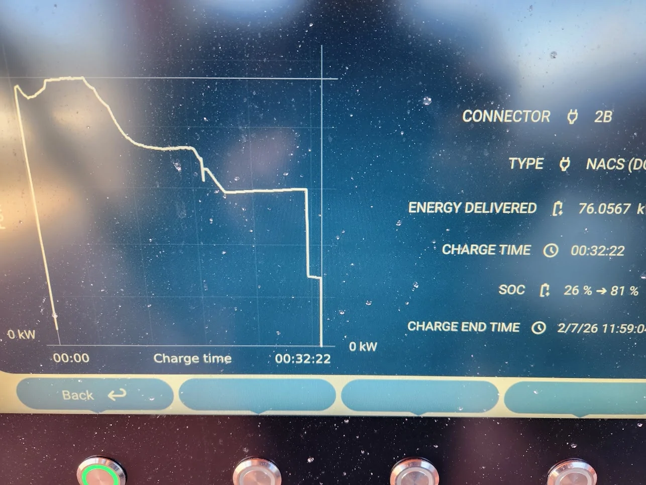

Out of Spec was able to deliver more power in their 10% challenge run in a 2023 Lightning, 40.3kWh, however their testing was done at 49°F. This is also why they managed 63 miles at 1.6mi/kWh.
All in all, not horrific, but also the absolute worst in class performance. What’s frustrating is there seems to be thermal headroom to push higher amps longer. I wish Ford held 500A for the first 50% or 60% of SoC. Other manufacturers allow another 20F into the pack before reducing current.
Looks like you definitely hit some derating in both sessions. @tommolog pulled about 42kWh in 15min in the charging test after the 500 amp boost update with 10-80 coming in just under 40min. @branden can probably comment more.

A few questions. Do we know if HVAC was in use during those sessions? We the chargers entered into the nav for preconditioning? What was ambient temperature?

These sessions appear to be representative for warm-weather charging with no meaningful derate on the vehicle side (no derate at all on the charger side). The blips are the vehicle overreacting to power modules being removed from the session as they are no longer needed.

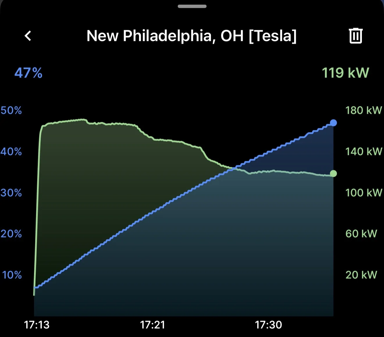

Quick follow up. I do have a charging session with a curve that’s similar to the one State of Charge logged. Ironically it was also in warm August weather. I believe HVAC was off for this session so I wonder if that’s the difference? This session was at a Tesla V3.
Out of curiosity, look in Car Scanner and see if you have any DTCs set. Below was one that I got back in February. Granted I was using the Tesla adapter.

No DTC’s here.
