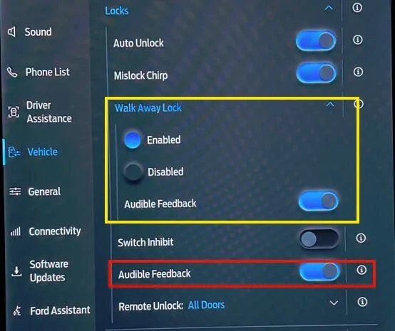

Only the 2024's have it factory including the toggles in Sync to turn it off.
For 22-23's, if your BCM has been updated (like OP and many others) then you have WAL. But the Sync toggles (Enable and Audible Feedback) will not be there unless enabled with FORScan. Do you have the toggles?
Those toggles could also be enabled at some point via OTA or a FDRS procedure, but I'm not aware of that occurring yet.
Ford F-150 Lightning 2023 Lightning Lariat updated to Blue Cruise 1.4 at the dealership at no charge. 1741701943740-ho
The yellow is the WAL lock section that you should see. Note the second mention of Audible Feedback outlined in red above is for the horn honk when you lock the truck manually with your fob. Everyone has that. The one in yellow is for when it does WAL.

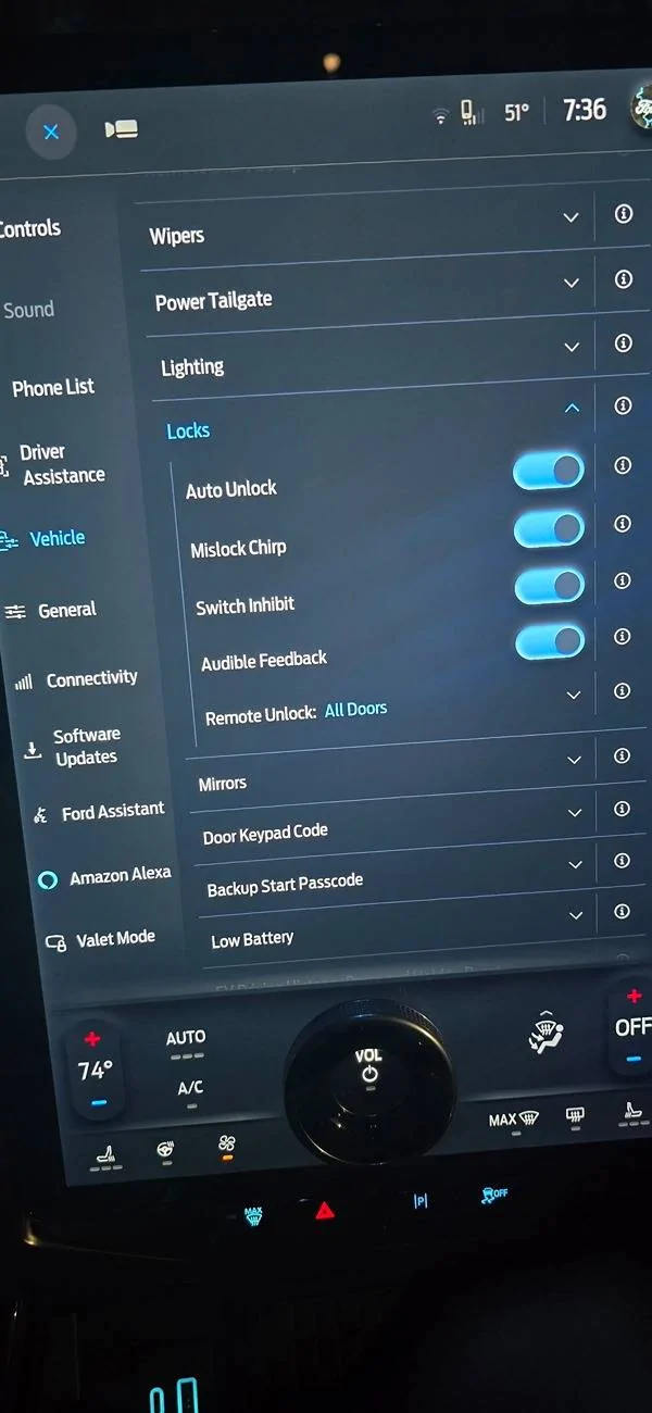

I just looked and those toggles for WAL are not there. So hopefully since they updated the BCM when I take it back for WAL they will be. The service manager did mention to get FORScan and see if I can enable WAL with it. If so I do not need to have them do it. So I have ordered the interface and have downloaded the software.

I have instructions for enabling the WAL toggles on the FORScan mod page. I really doubt they can do that since it requires a configurator in FDRS and I'm not aware that is available. They will not do FORScan. Ford has said it would come as an OTA.
Same thing for BC. While they can update the IPMA and PSCM, I don't know if that in itself enables the feature. There are FORScan changes floating around that do.
It certainly doesn't enable the Sync toggles. But like WAL, maybe it just works. Ford has again said the toggles and capability will come as an OTA (soon).

I currently do not see the toggles in the yellow box.
But! They enabled WAL! I drove the truck and parked it in my driveway and went inside. When I went back into the garage the truck locked itself and mirrors folded in. Yet the toggles for it are not there under locks. So it must just work. I found though that I have to drive the vehicle and park it. Not just open and close the doors and walk off.

Yeah, the WAL is enabled with the BCM update. There are no further configuration steps unless you want the toggles in Sync (the APIM module).
But I don't know if you get BlueCruise 1.4 just because the IPMA is updated. Besides updating the module, there are configuration changes that have to be made to the IPMA to enable Assisted Lane Change, In-Lane Repositioning, Curve Control, etc. Just updating the module does not do that. Separately, if you want the on/off toggles the APIM/Sync needs a configuration change.
