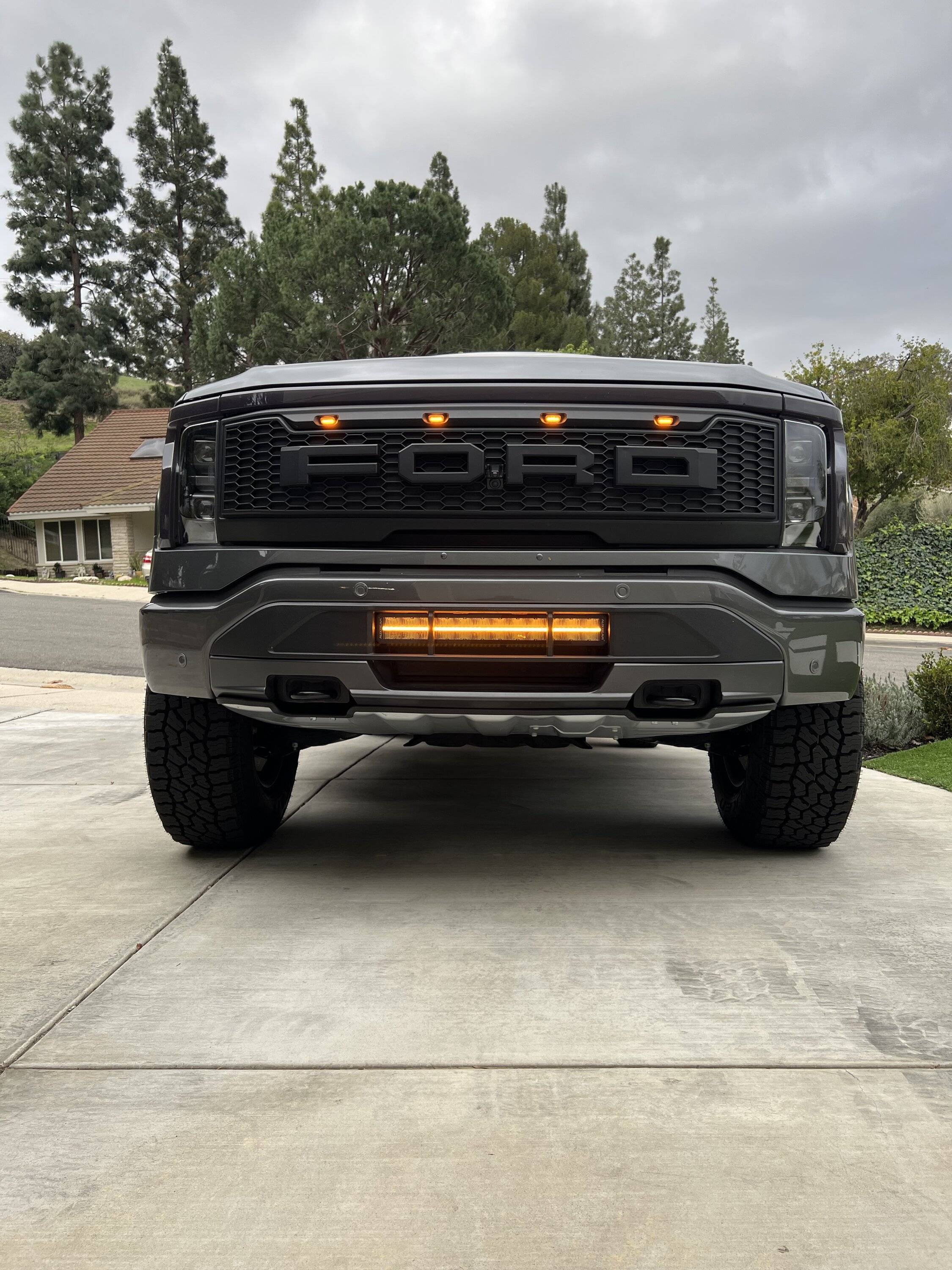

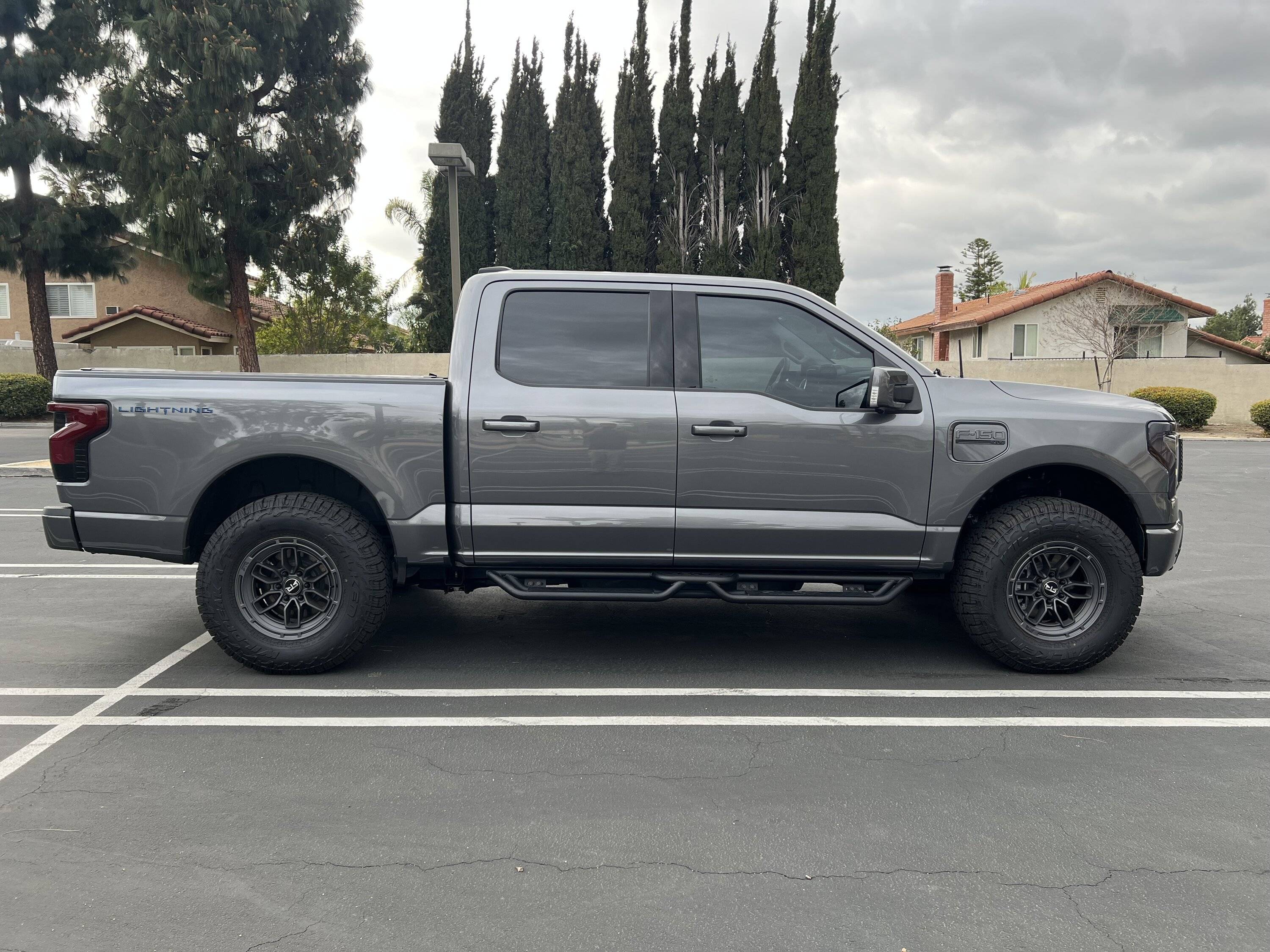

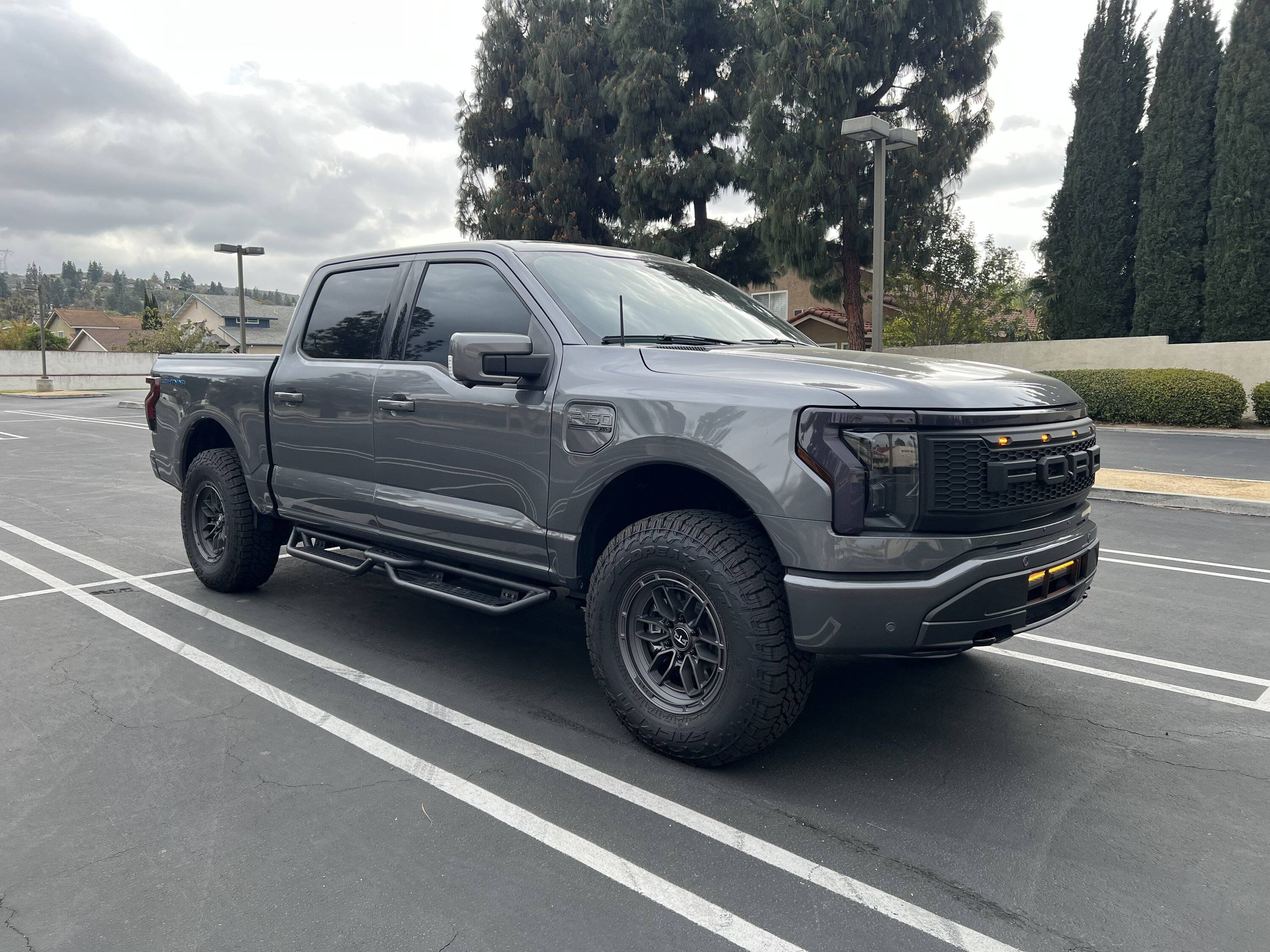

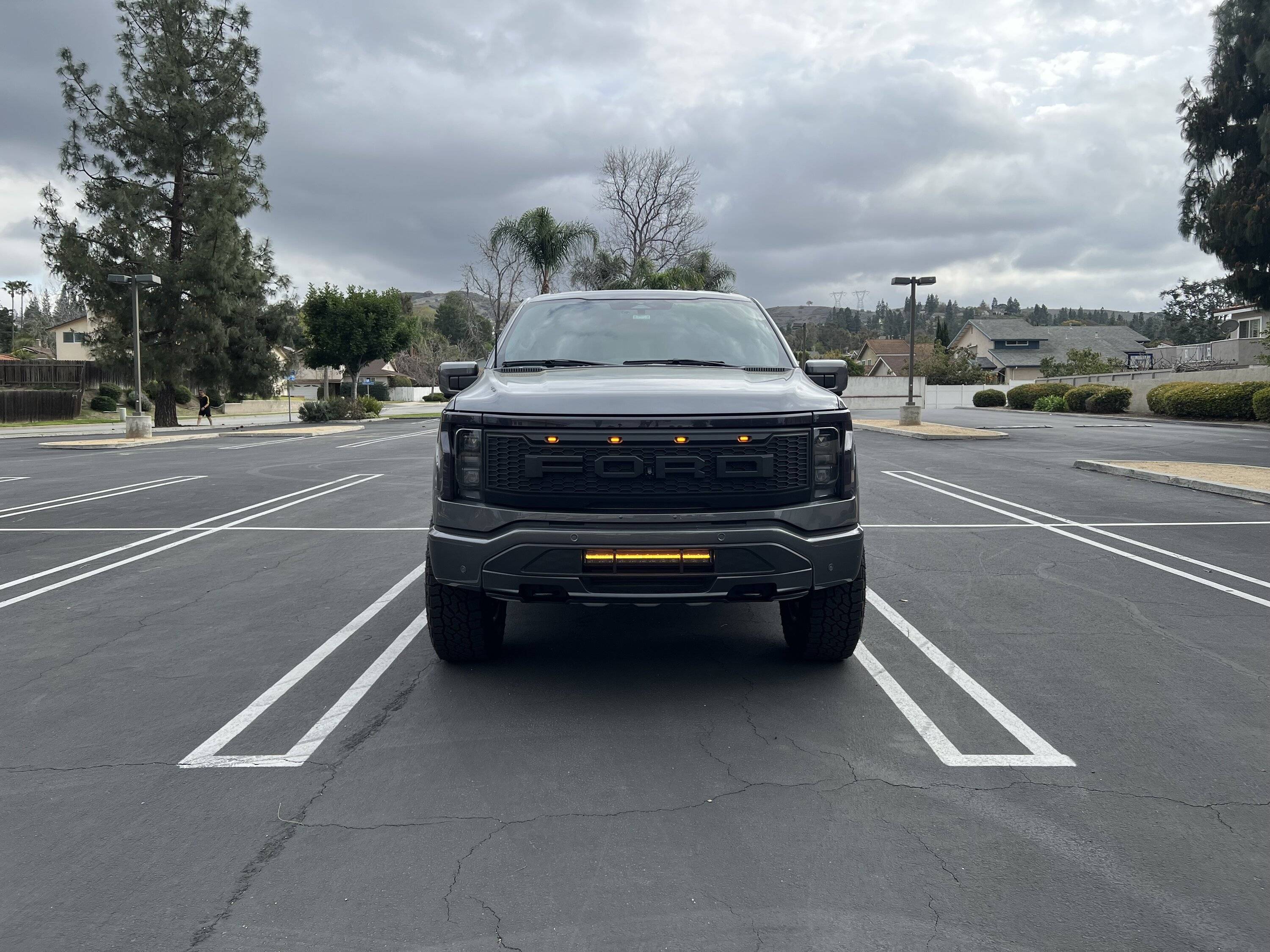

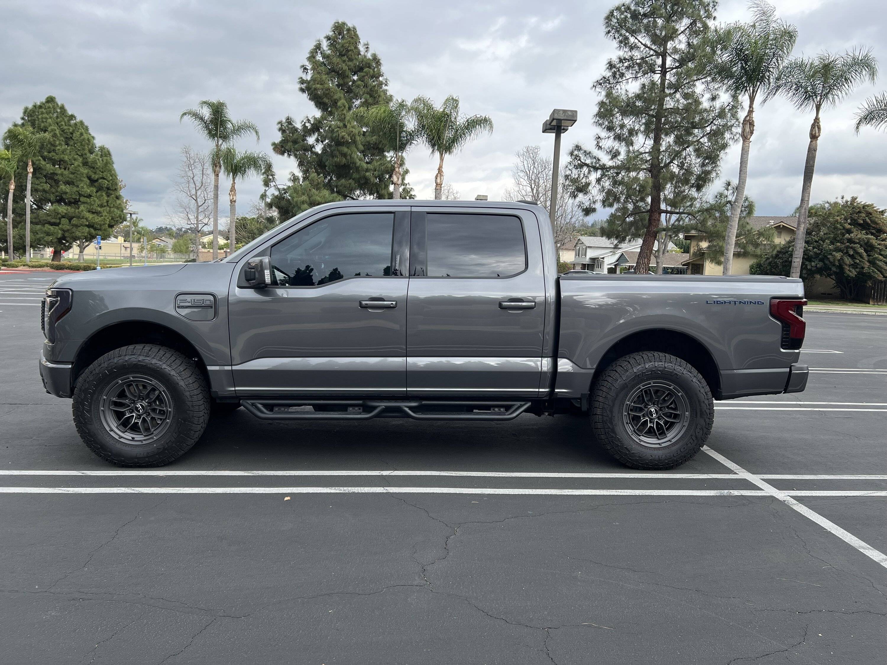

My XLT has been through a few different builds as I just wasn't quite happy each time. I think I am finally happy with where I am now. The 35s fit quite well, no rubbing on the crashbars or inside the wheel wells. I do get a slight rub on the drivers side front bumper when the suspension is compressed just the right and the wheel angle is at it's closest. This just so happens to be the almost every time I back out of my driveway :facepalm:... but seriously the rub is quite minimal and rare. And only on the drivers side. So here are some of the exterior things I have done:
Wheels: RTR Evo 6, 18x9 +18 offset - Satin Charcoal
Tires: 35x11.5R18 Falken Wildpeak 4Ws (C Load Range)
Leveled 2.6" with Eibach Shocks w/adjustable perch
Raptor style front grille

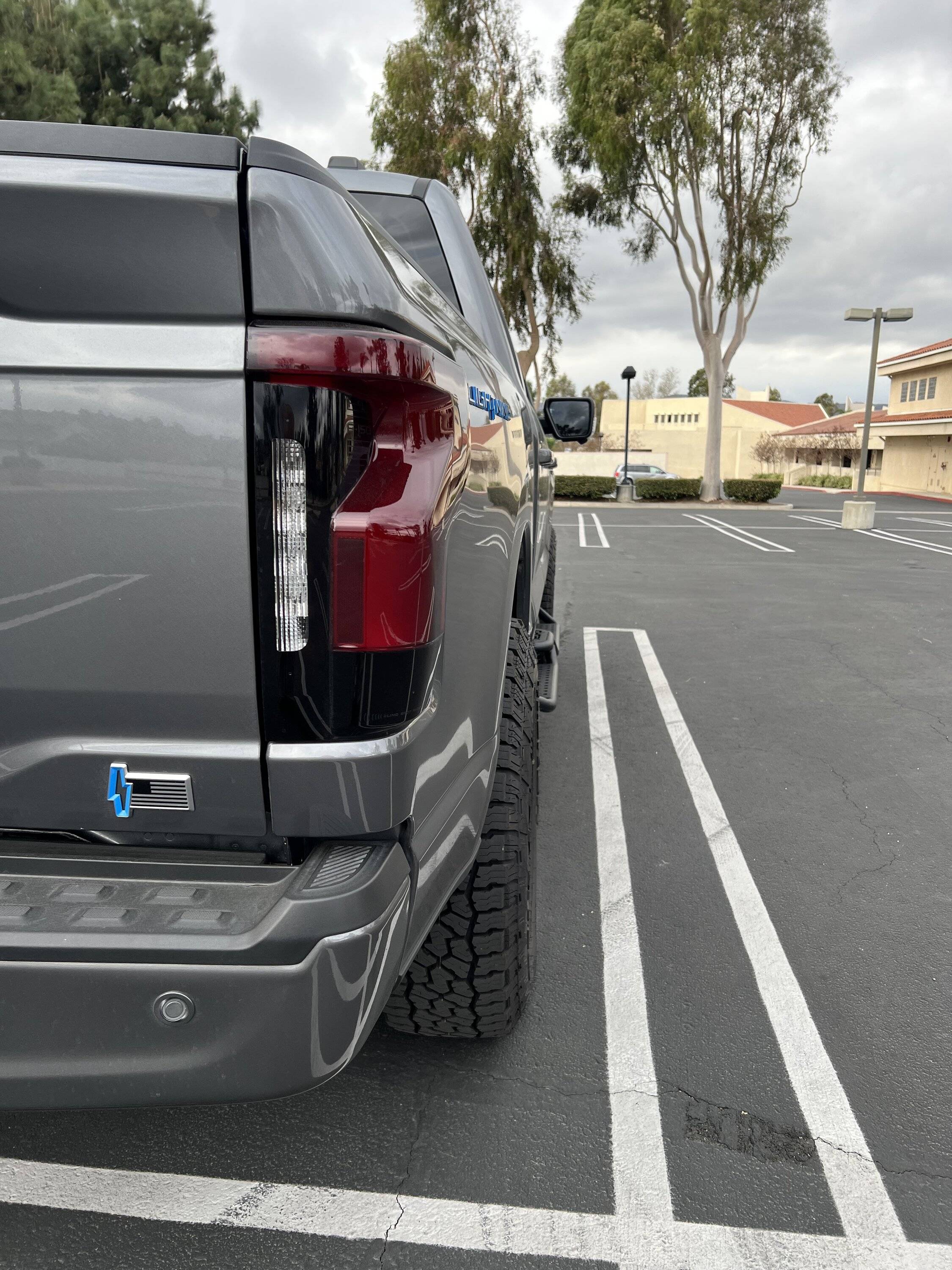

Lightbar and Tailights Tinted with Stek PPF
Removed active air dam and front valance
Raptor Gen 3 front Skid plate
22" Auxbeam Lightbar installed in front bumper
Replaced OEM running boards

I paid $800 for the light bar and $250 for the rears. Others have had theirs done for less. I am happy with the work my installer did...

boardriderb
Feb 3, 2025
2024 F-150 Lightning Flash
Looks excellent. Is there any rubbing/interference with the tires?
derelict
derelict
May 7, 2024
150
204
XLT ER
I have very slight rubbing on the drivers side with the front bumper only when backing down from an incline to flat. This is basically when I pull out of my driveway and the wheel is turned where the very outer part of the tire is aligned with the bumper. Other than that, no rubbing in any other places or situations…
