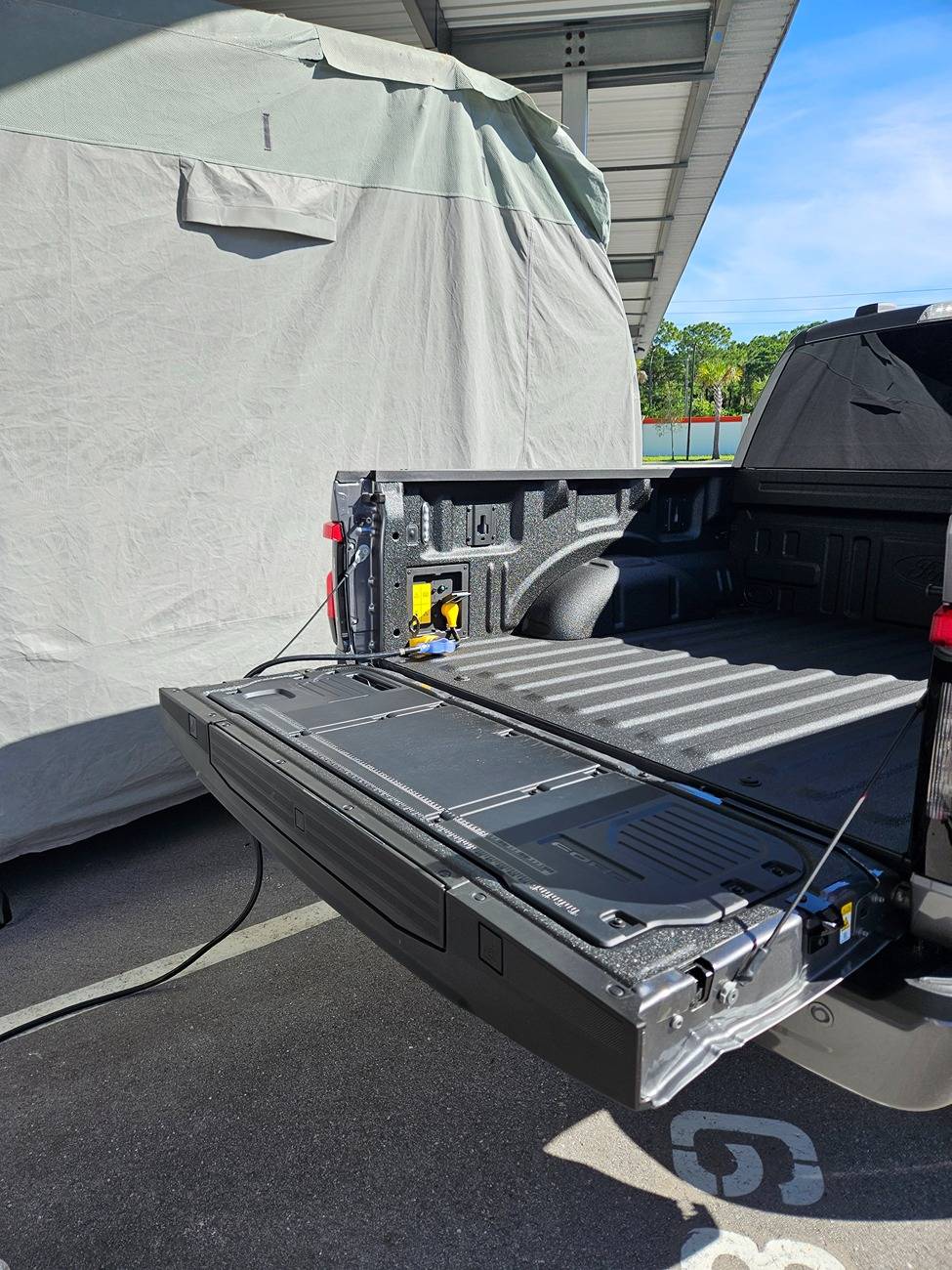

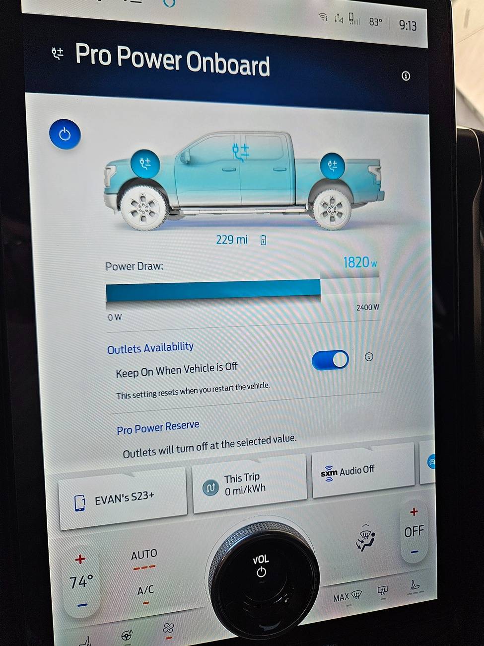

I have the Flash with the 2.4kw inverter. I had the same concerns as you because we trailer camp A LOT and I want to be able to boondock and not rely on shore power.
I took a chance and while I did have to install a soft start on my rooftop 15k BTU AC on my camper, it starts and runs just fine using pro power. Pulls about 1.6 -1.9kw.
All the cooking and heating uses propane and the fridge is 12v. Only thing I have to be careful of is the Keurig lol. That little bastard pulls a lot of watts to heat a coffee.
Appreciate the images and info! Have you ever maxed out the 2.4 kW by any chance? Wondering how it performs if we hold steady at close to or at max.

If you overload it, the circuit trips and you reset it on the truck. It should run right up to the 2.4k before doing so. The largest draw for me was the AC with the startup surge needed. With the soft start it never tripped on my 15k BTU AC but every model is different on energy draw as well as the age of the unit.
It's really an individual decision based on need. I know I wouldn't pass up a $7,500 rebate, but that's me. Good luck!

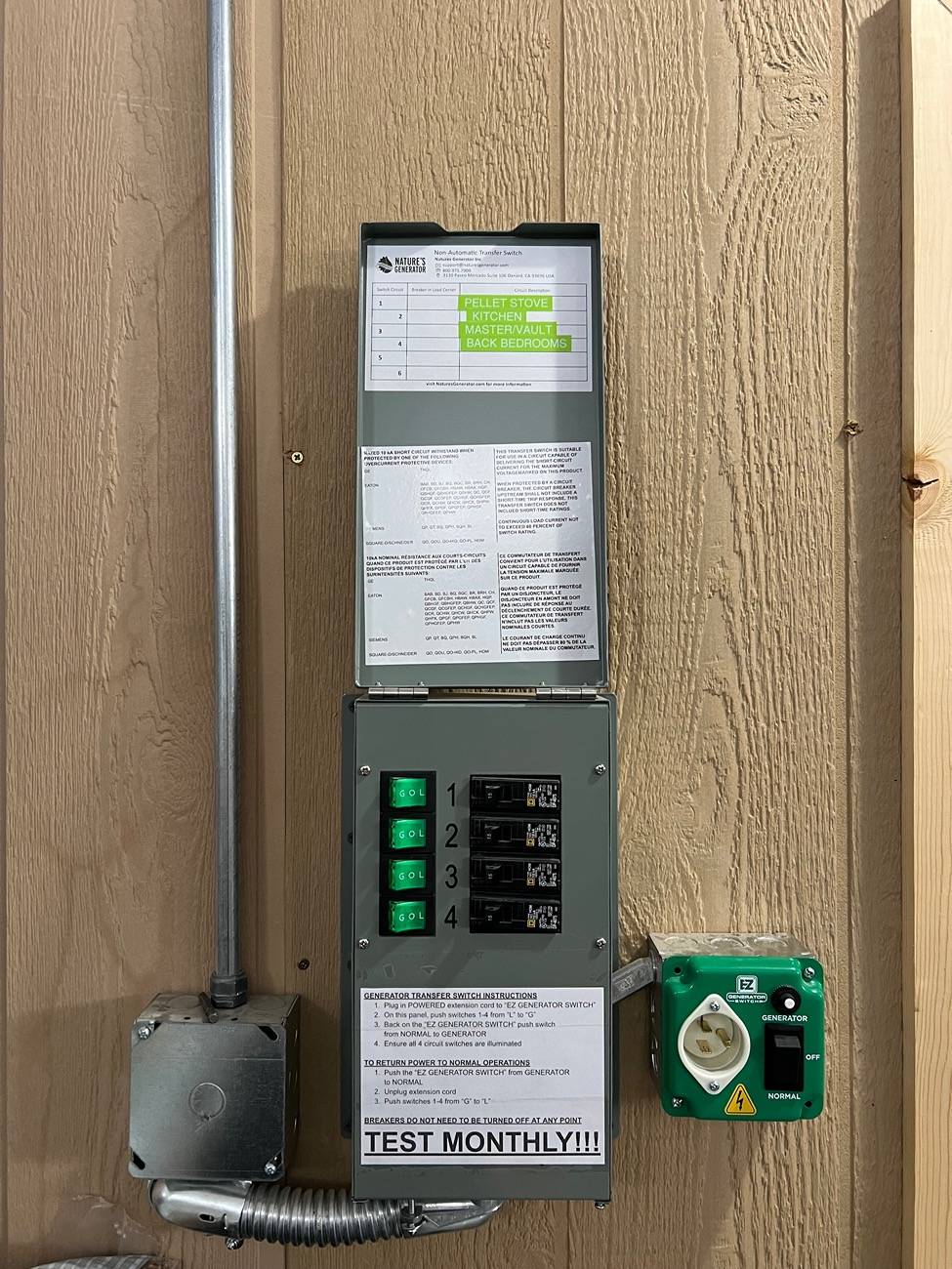

I use mine to backup the house. Limited to 15a keeps things to a minimum. I run my starlink, fridge, pellet stove and wood stove, and a few bedrooms for TV and lights. I live off grid so if my house batteries die this is my back up.
