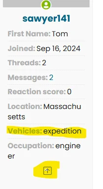

Please update your forum profile to describe the model year and trim level of your Lightning.
Some trucks needed replacement of the locking mechanism, mostly on the initial production years 22/23
