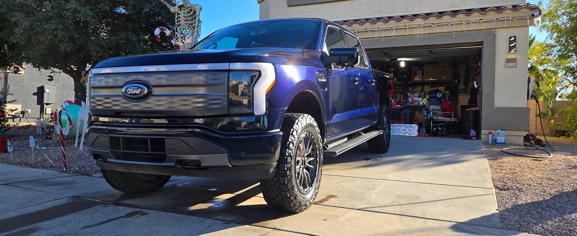

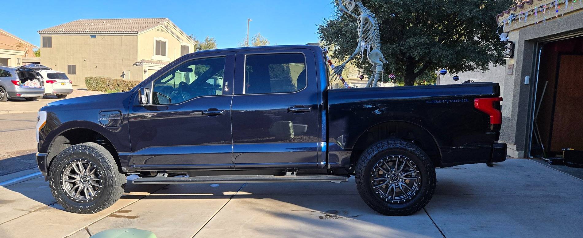

23 F150 Lightning Lariat ER
AV Technical Manager
23 Lightning ER Lariat

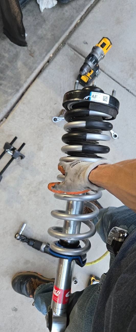

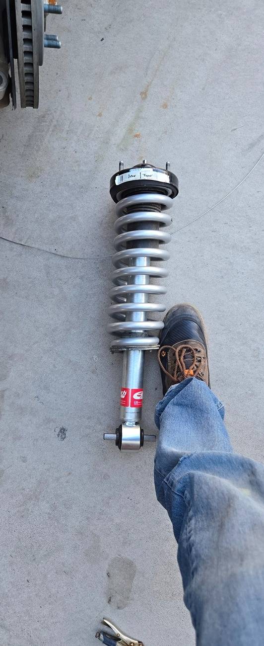

Eibach 2.9"pro lift

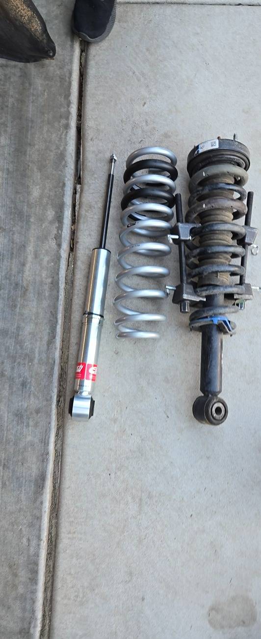

- 2.9" lowest perch set on front
- 0.7" second geo lowest perch on rears

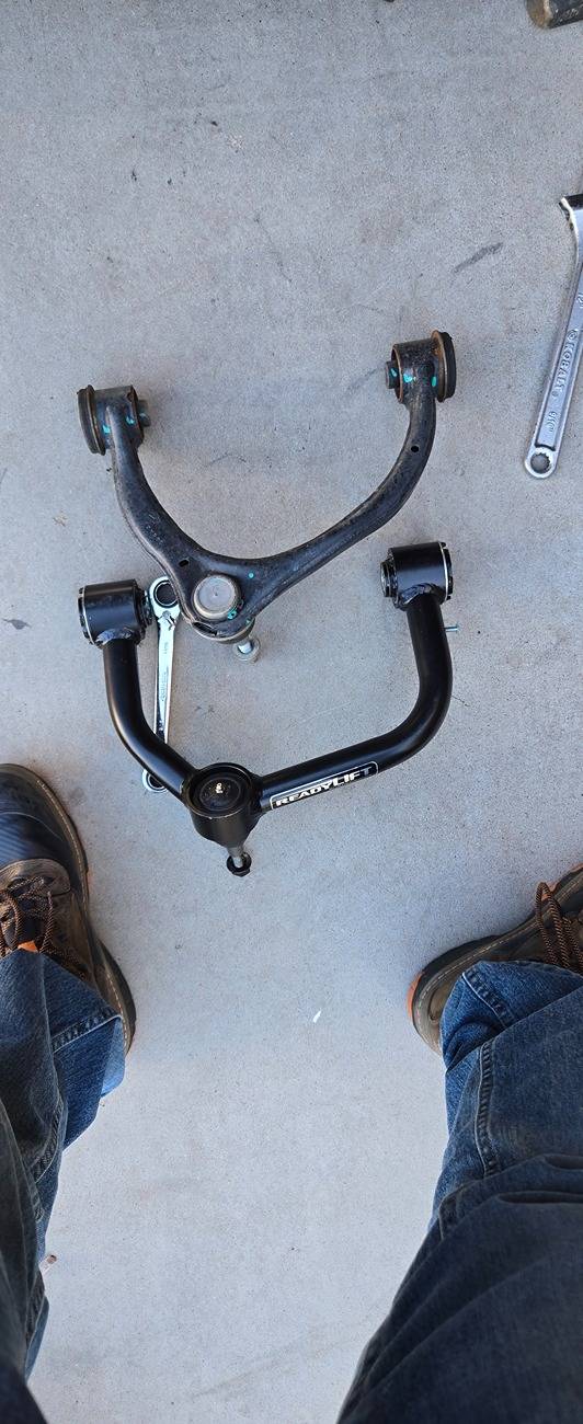

Ready lift SST 3.5 upper control arms
- looks like 23's don't have the headlight sensor? So didn't install the brakes for these.
- got these for better steering geometry, not sure if needed but made me feel better about the angles.
Eibach camber alignment kit made by SPC

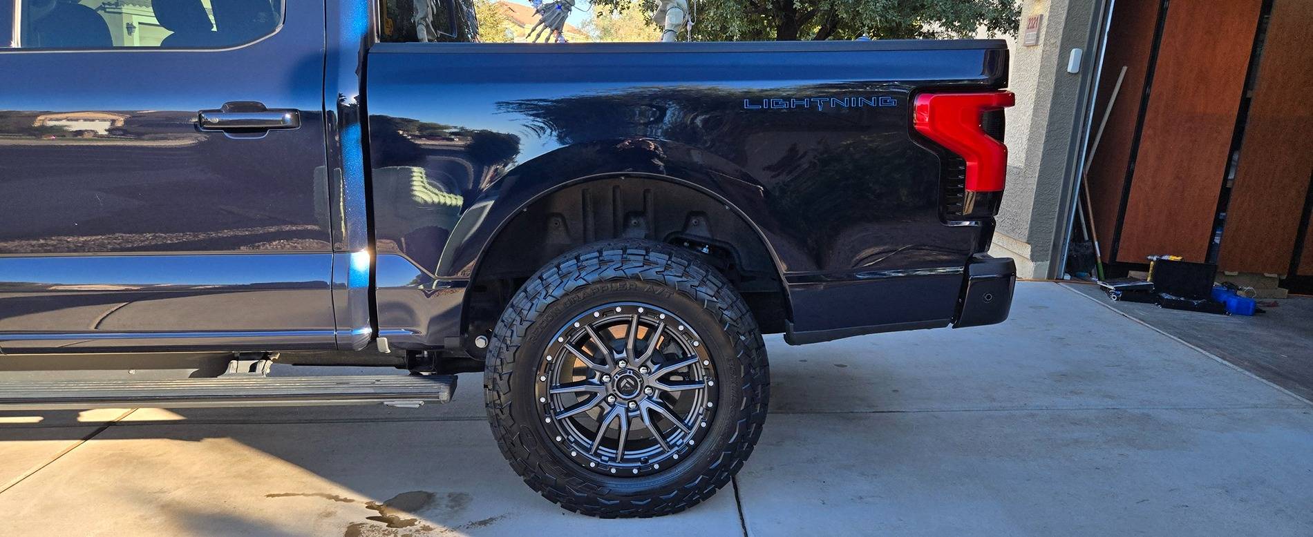

Fuel Rebel 6 20x9 +20offset
Nitto Recon grapplers 35x11.50x20
- not too loud but would like to have tired the at4w falkens.
Adjusted speedo using for scan and obdlink + Bluetooth adapter

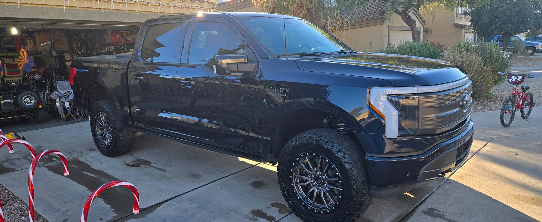

After lift comments:
- Lost about 15-30% range depending on weather and speed.
- tires are a bit louder but expected with the nature of this vehicle being Soo quiet anyways.
- Road handling much better
Not even a little boaty anymore
- A little bit stiffer but has been breaking in as time has gone on (only 650mi on lift). Betting it's just the stiffer sidewall on the LG rated tires
- There is a baby and I mean tiny amount of rub and half lock turning on the front bottom airdam. It's rubbing it so lightly that you can see only and little hair of rubber lol. So not an issue and will take care of it's self. Could trim in 1mm but why.... ( This could be resolved but using 18mm offset or lower.
Super happy with the results !!

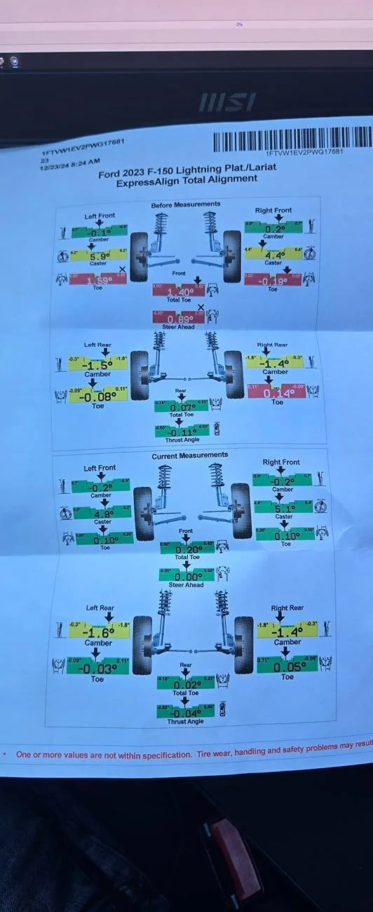

Did the small lift on the rear help with the terrible camber?
Yes everything in the rear is now pretty 0. I haven't taken it back in to have them align it after the rear lift. I did the front lift, tires then got it alignment. They did all 4 corners Once I got home from alignment I did the rear lift springs.
Was wondering if I should have them "fix" the alignment in the rear to the factory spec or leave it how it is....

This is the alignment after the front lift and UCA's and tires / wheels.
I'm assuming after the0.7" lift in the rear it fixed that because I can't see the "squat" anymore and it drives like it's missing rear camber.

Truck looks great!

I understand that the camber is there for a reason but I think the larger tires exacerbates it. I’m looking to add a small lift myself to correct it as there is no actual adjustment for camber in the rear. Only toe

It looks really good.
Thanks for the detailed data.
