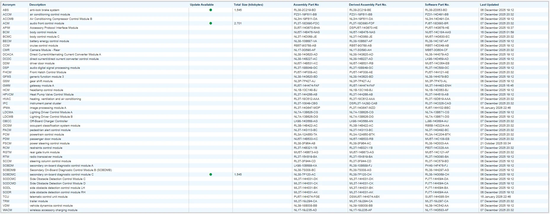

I can see the update is available, but no OTA campaign on my truck right now. It looks like it is just the ABS Module and the SOBDMC module. The reported size of the updates is tiny. Ford could easily push this and save dealer visits for thousands of us. (I believe the ACM update shown on my list was already completed and just won't clear.)
I'm tempted to update myself with FDRS, but I don't want to confuse the dealer when I eventually want them to clear the recall from my VIN.
Ford F-150 Lightning 25C69 Recall - Ford Recalls 2022-2026 F-150 Lightning Over Rollaway Risk Updates Available 2-6-2026

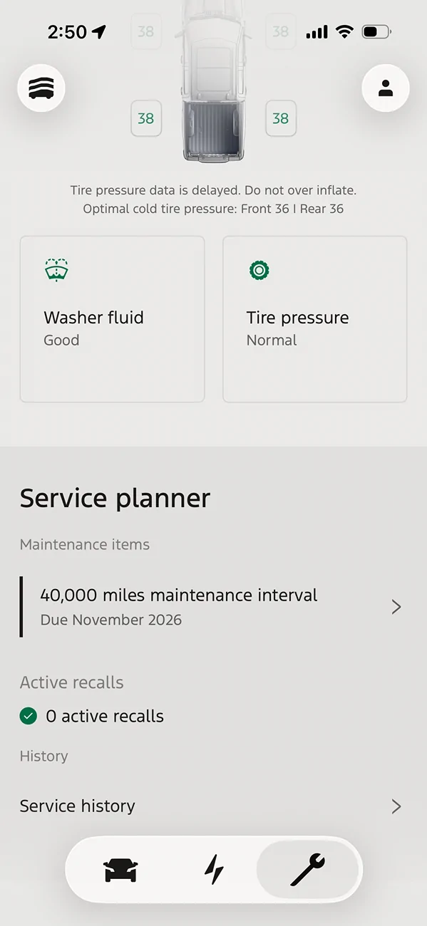

I haven’t gotten the truck serviced and somehow the recall has disappeared from my FordPass.
Mine went away in the app also, but still shows on Ford website. Crazy how they (the website and the app) constantly misalign.

Probably why v6.6.0 was quickly rushed to testing & deployment, I wonder if they fixed this issue in that release, I haven't gotten it yet. Anyone else gotten V6.6.0 and seen issues like the recalls section return?

Looks like mine appears on the web as well, even though it’s gone from the app
I’m currently on ver 6.6.0
