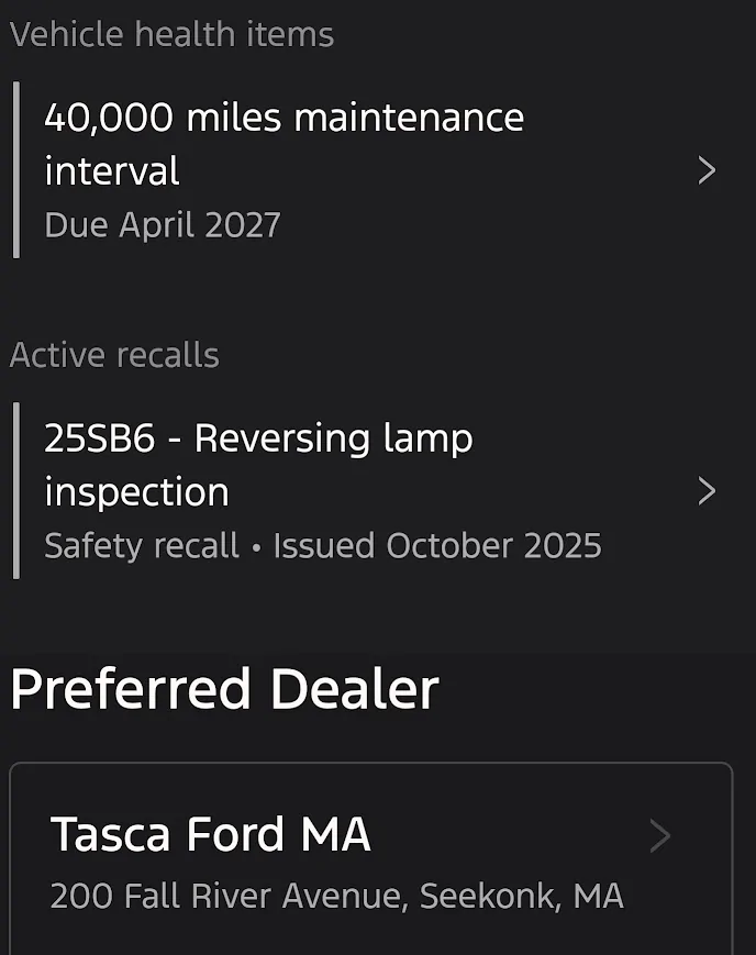

Are folks still seeing the recall listed on their service list in Ford App or Ford.com?
It's been a good while since mine was repaired, was expecting the alert to drop off by now.
41 days, seems long enough for dealership SA to close the record.
Should be, but your dealer hasn't submitted the claim yet
I recall he was having "issues" with the computer while trying to print a copy of the closed work order, he probably never revisited the case after I left.
Reminds me, I need to visit the SM to get the already completed recall of the recall, off my recall record.
Chatted with the SA, they have submitted what was needed to FoMoCo, waiting for review and disposition, it should disappear from my end in the near future.
13 days later and it's still listed. :wait: these little things aggravate me.
Call from the service manager this morning, they will pickup my truck to complete the photographic evidence that the repair was completed as specified, apparently the tech who did the recall forgot the photos, and the recall claim for payment has aged out. Don't you love AUDIT CYCLES !

They picked her up late morning, completed the re-inspection snapped some photos and returned the truck mid-afternoon, hopefully that satisfies the requirements to close out the recall alert over the next couple of days.
It's been a week since the re-inspection, recall still listed on Ford App, I'll assume my situation is an exceptional process due to the missed opportunity to document the completion of the repair during the processing of the just in time work order.
Maybe it'll disappear at some point by the end of month when reconciliation audits are done and Tasca hits the reimbursement cycle.
