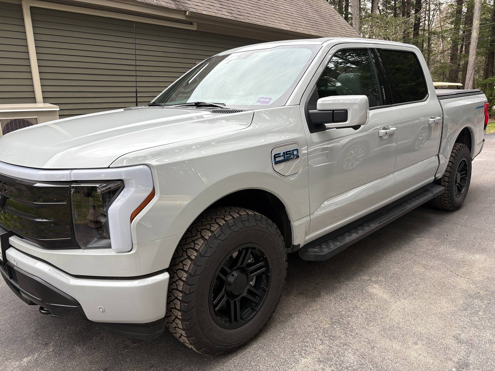

Rough numbers coming from Maine weather and driving:
Stock - 22" Platinum rims and General Grabber HTS tires @ 275 50 22
Each wheel (rim and tire) weighs 87Lbs.
At 42PSI, 70 Degrees, 80% 70mph highway, 20% 40mph +/- rural = 2.1 m/kWh

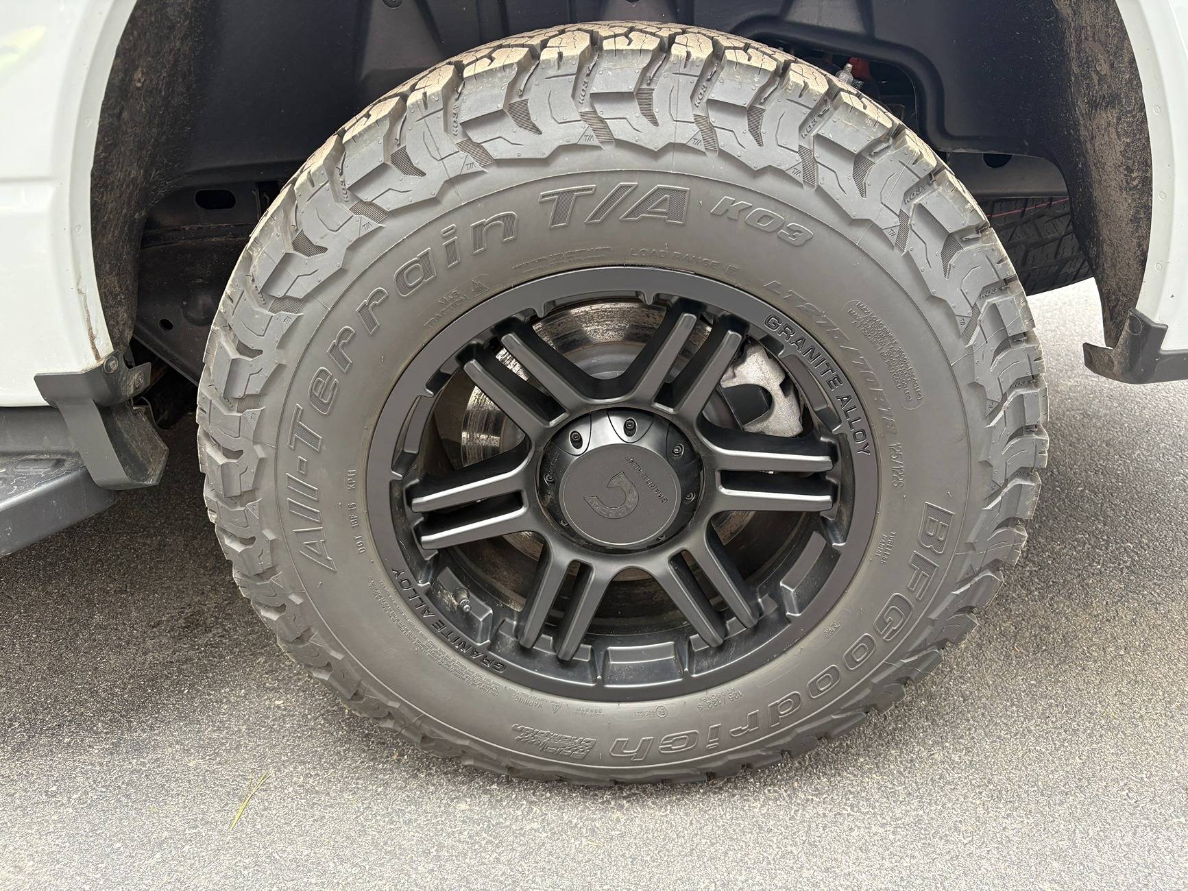

Aftermarket:
18" Granite Alloy rims, 275 70 18 BF Goodrich KO3s. They poke just a little. No rubbing, almost same diameter as factory, just a 1/4" taller and 1/2" wider.
Each wheel (rim and tire) weighs 92Lbs.
At 42PSI, 70 Degrees, 80% 70mph highway, 20% 40mph +/- rural = 1.7 m/kWh
At 42PSI, 47 Degrees, 80% 70mph highway, 20% 40mph +/- rural = 1.6 m/kWh
General notes:
With aftermarket setup, truck handled fine, little more spongy than stock. Highway noise was noticeably louder, but not bad overall.
I've since gone back to stock for the summer for better handling / feel / noise / range for summer highway adventures.

Great info and your truck looks great too!
