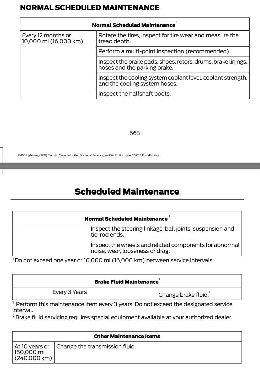

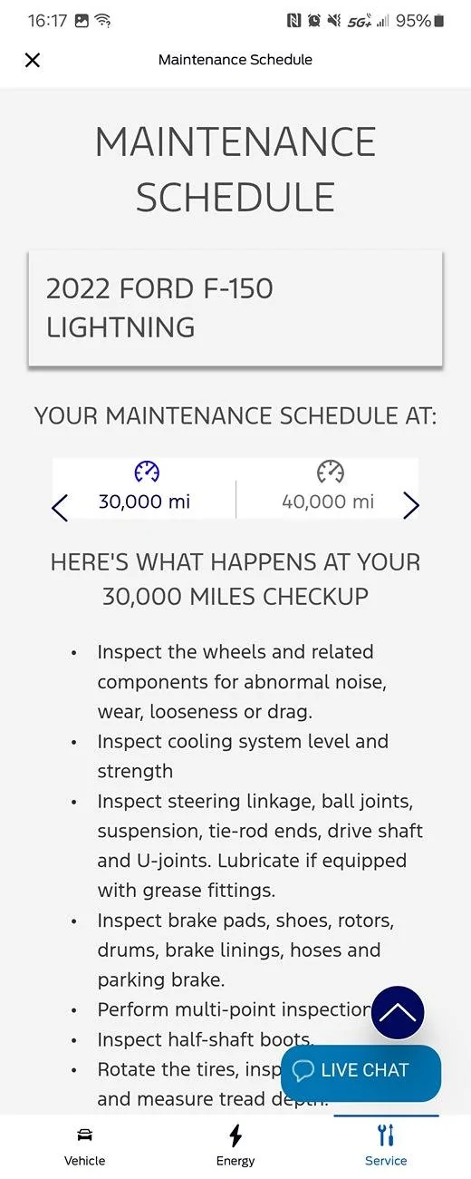

In the Lightning manual online, under Scheduled Maintenance. It directs me to log into the Ford website for service schedule.
For the 30,000 mile service, Ford says to expect:
  • Inspect the wheels and related components for abnormal noise, wear, looseness or drag.
  • Inspect cooling system level and strength
  • Inspect steering linkage, ball joints, suspension, tie-rod ends, drive shaft and U-joints. Lubricate if equipped with grease fittings.
  • Inspect brake pads, shoes, rotors, drums, brake linings, hoses and parking brake.
  • Perform multi-point inspection.
  • Inspect half-shaft boots.
  • Rotate the tires, inspect tire wear and measure tread depth

I've been puzzled by the brake system flush, requirement for our Ford Lightning, it's not listed early in the maintenance list in the app, 3 years x 36,000 miles seems reasonable.

Every three years for brake fluid based on the fluid manufacturer requirements.
No reason to do an AC flush unless your AC isn’t performing.

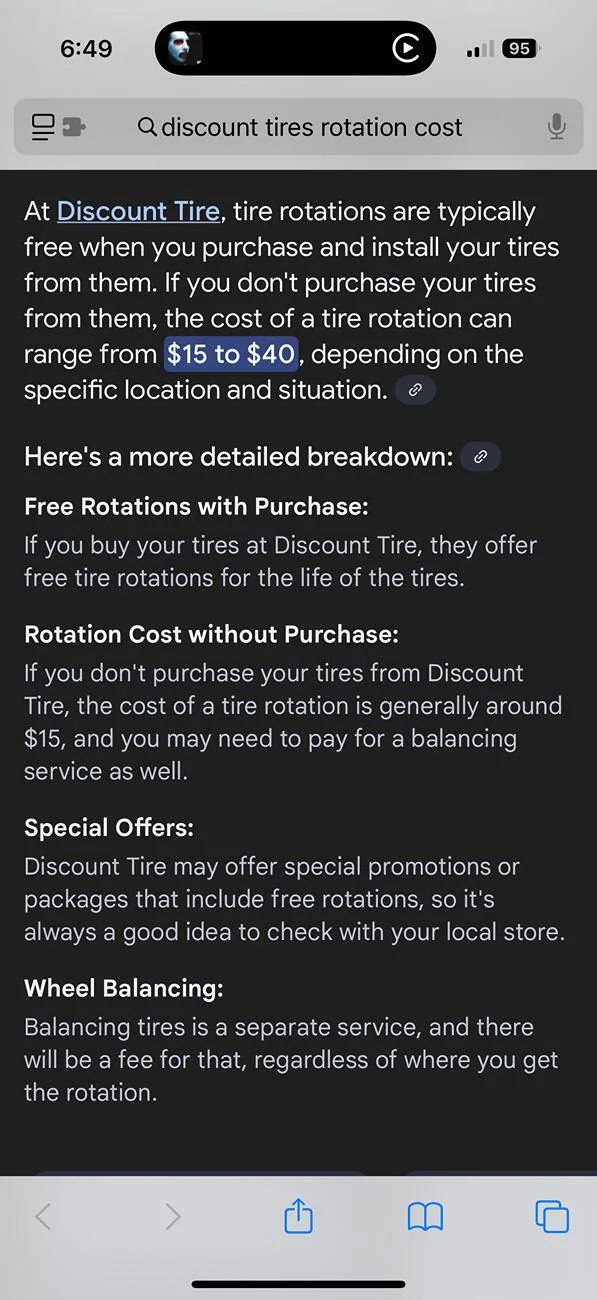

Discount tire is only free Rotation if you purchased tires from them.

Nope, they will repair flats and rotate for anyone for free. They will balance for free only if you bought the tires there. I can confirm, I had a nail in a factory tire on my truck and they fixed and rotated for free.
It's a smart business decision. They get to sell you a tire if your flat can't be repaired and check for wear when they rotate to sell you a set if they are worn.
