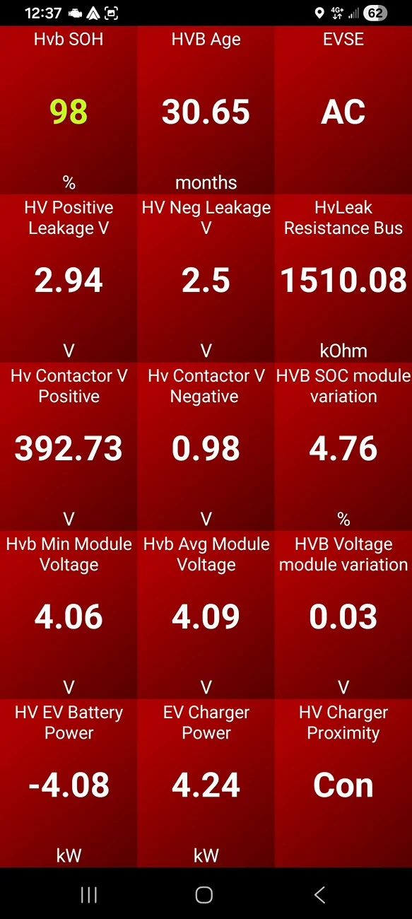

As others noted, the module variation seems on the higher side of 'normal'. What was your SoC in the screenshot? You said it was effectively level 1 but you're seemingly pulling about 17-18 amps at 240v. What's the lowest kW you're pulling? I'm inclined to think it's balancing the cells.
Screenshot soc was 91% started to derate after i hit 90%
Im currently at 92% and its down to 4.9
Was pulling 6.8 at 90%
Time on charge looks weird
because i pulled into shop at 88% it charged to 90 and was shut off for a couple hrs before i restarted

Taken at more or less the same time? Ford app says charge rate is 4.9kW OBD says 4.2kW and to battery says 4.08kW. It hasn't gotten cold enough since I got data logging enabled but a charging efficiency of 83% is pretty low so something is going on. Someone with more data may be able to tell you if it's conditioning the battery with those numbers, but hopefully it's just balancing the cells and a couple full L2 charges gets you running right.

Update truck went from 95% to 100% instantly and said charge complete.
Showing only 118kw usable and actual battery SOC at 87%

I think you and I are in the same boat. If you start the truck, see if the SOC instantly drops to 90% or less.
I started getting the same behavior - charging slowed, then instantly 100, but dropped back <90 when truck started. App reports 100% but range number nowhere near 100% value.
