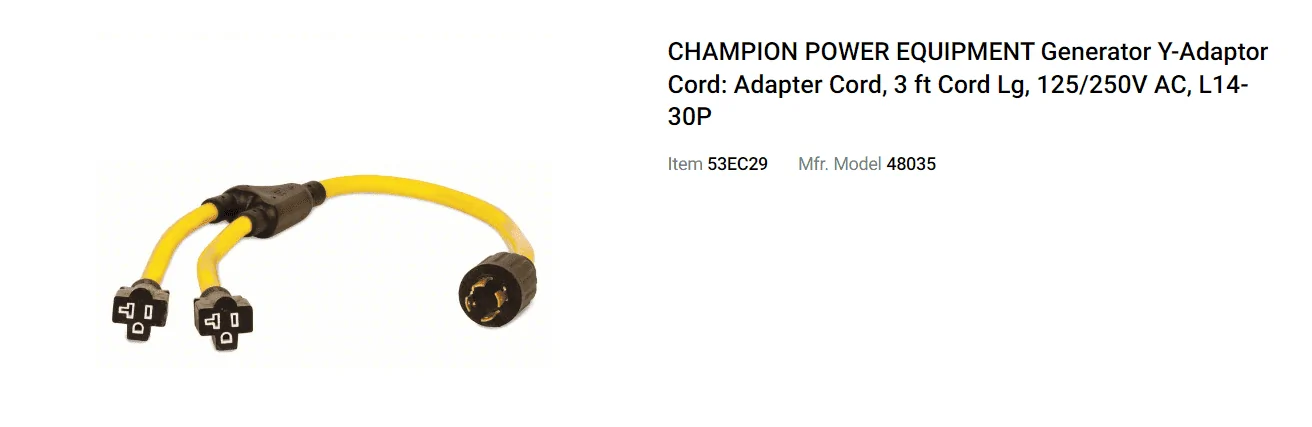

I know I've come across this, but I've searched high and low. I don't want to buy the wrong one.
If I want to run normal household outlet stuff on the circular bed outlet, what would a suitable adapter be?
I know it's L14-30P but some of them look a little funky.
Thanks.

I'm not sure why you'd want to buy an adapter to do the exact same thing that the existing 120v outlets in the bed already do, as they provide the exact same 120v output(up to 30amps each, from the 30amp inverter) that the adapter from the 240v outlet would give you. You already have FOUR of those 120v outlets to use.
You also have the 120v 20amp outlets in the cab and frunk, all drawing from the maximum 20amp inverter.

I'm not sure why you'd want to buy an adapter to do the exact same thing that the existing 120v outlets in the bed already do, as they provide the exact same 120v output that the adapter from the 240v outlet would give you. You already have FOUR of those 120v outlets to use.
I was thinking it would be better to plug multiple devices into multiple outlets instead of a power strip? I was thinking for a power outage, 1 more outlet couldn't hurt.
