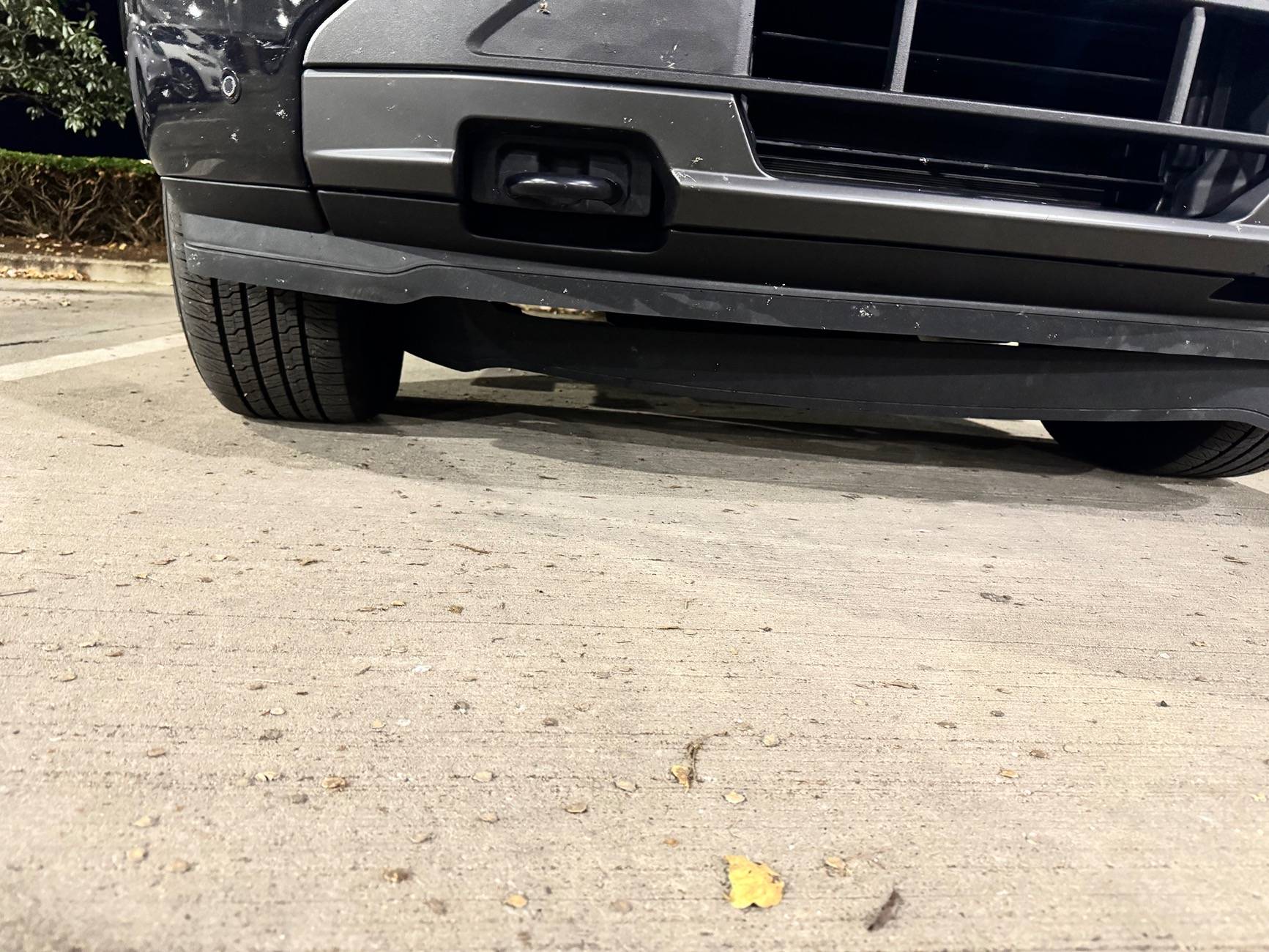

Welp,
Driving to the airport at 2am this morning a raccoon darted out of the side of the road, I thought I was gonna miss him, but, “bump”.
Now, let’s pause here.
About 2 years ago, I was driving my 2021 F150 home on a curvy rural road, and a dog darted across the road, doing a lot of damage to my Air damn. I got quoted $400-500 to replace it, and decided nope.
With the 2021, I was able to repair it with zip ties. It actually still functioned as well.
Back to my lightning. I kept telling myself “there’s no way this little raccoon did any damage to my truck” as I was driving.
Sure enough, when I got to the airport, I see my air damn is completely dangling on one side. I think it looks like the actual motor is dangling with it. I didn’t have enough time to look closely.
This seems like a terrible design for a truck. Specially, in the country area.
Can I just remove this thing from both sides? I need my lightning to be as efficient as possible. I have a long daily commute but I really don’t think it’s going to make a huge difference.
im not excited about paying to replace this.

thank you good info. I guess I was sort of seeking some people that may have removed their air dam on purpose and how It’s going for them.
Searching on Google it seems like I can find at least one lightning person that has intentionally removed it.
I would keep the permanent air damn, just remove the one that actuates. It’s a pretty weak design if something the size of a cat can cause that much damage to a 6500 pound truck.
I guess part of it’s my fault too. I’m not used to the front of the truck having such low ground clearance. When I see a small animal on a road like a rabbit or a squirrel I usually try to center myself on the animal so that I can go right over it and I don’t swerve like crazy.
I’m hoping nothing else under the truck is damaged. But my previous F1 50s had more skid plates and under body protection so I will definitely have to take a close look.

I struck a moving recap at speed. Same damage. I removed the dam for several weeks with no issues, but had it all repaired under my comp insurance.

I hit a small deer which busted the shutter assembly and with a $1000 deductible, decided to replace myself. Though I made the repair more complicated than it needed, it basically involves the primary step needed to replace the air dam - removing the front bumper assembly; you cannot access the attachment bolts for the air dam with the bumper on the vehicle. Tedious but doable and in retrospect I should have video'ed the disassembly. A Youtube video from Kurt'sRPMGarage made the task much easier. Not sure how vital the air dam is.

Just out of curiosity, I googled air dam removal and found quite a few YouTube descriptions. It didn't look like it was too complicated although I'm not sure if it's any different on the lightning compared to the standard F150.
