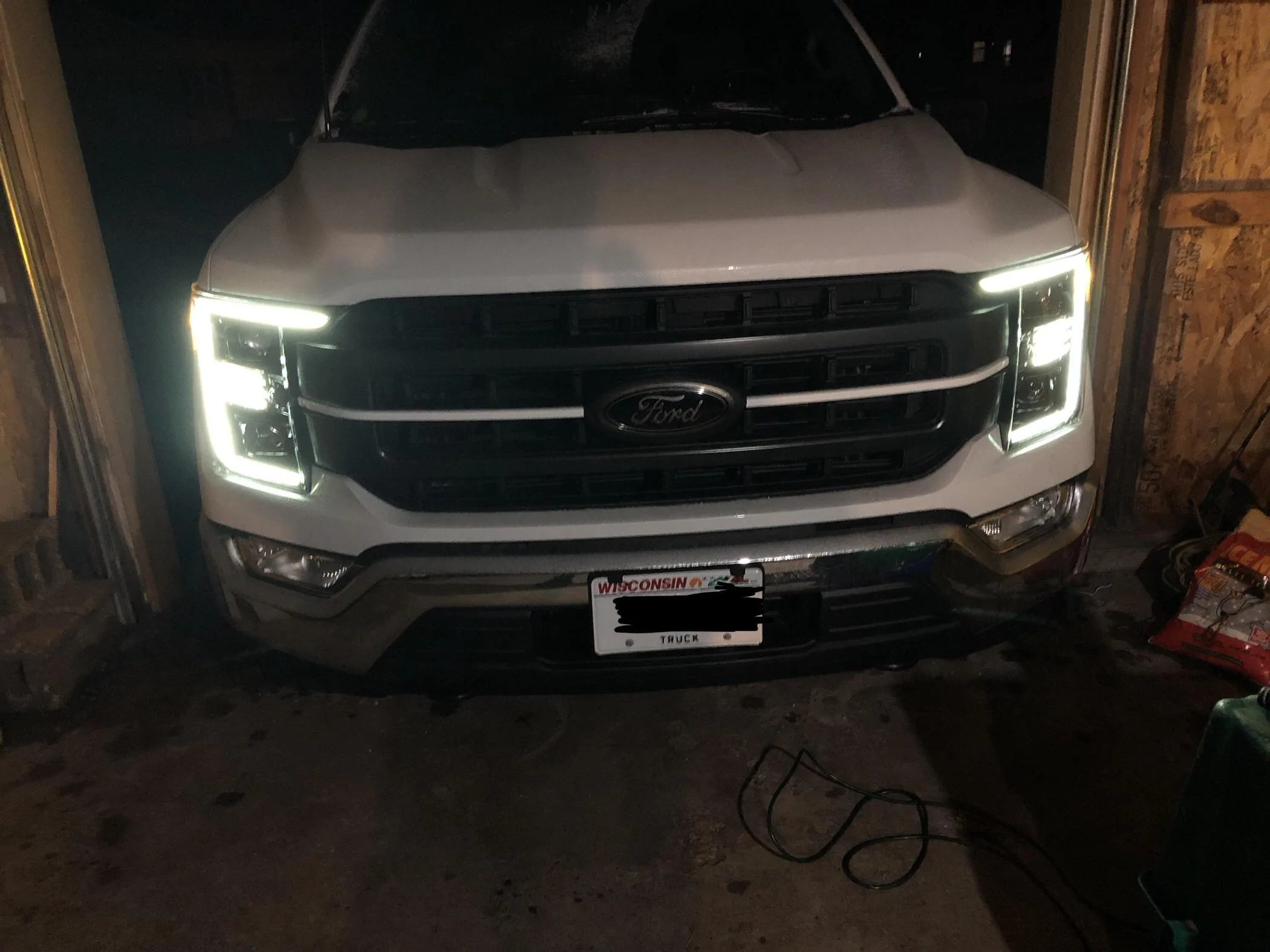

Hey all, I just finished up installing these tonight along with the tremor style grill bar on my XLT. I’m very impressed with the build quality and light output compared to the halogen in my driveway. I haven’t gotten out to drive them as I finished up at 930pm but more will be to come. I’ll get some daytime photos tomorrow.

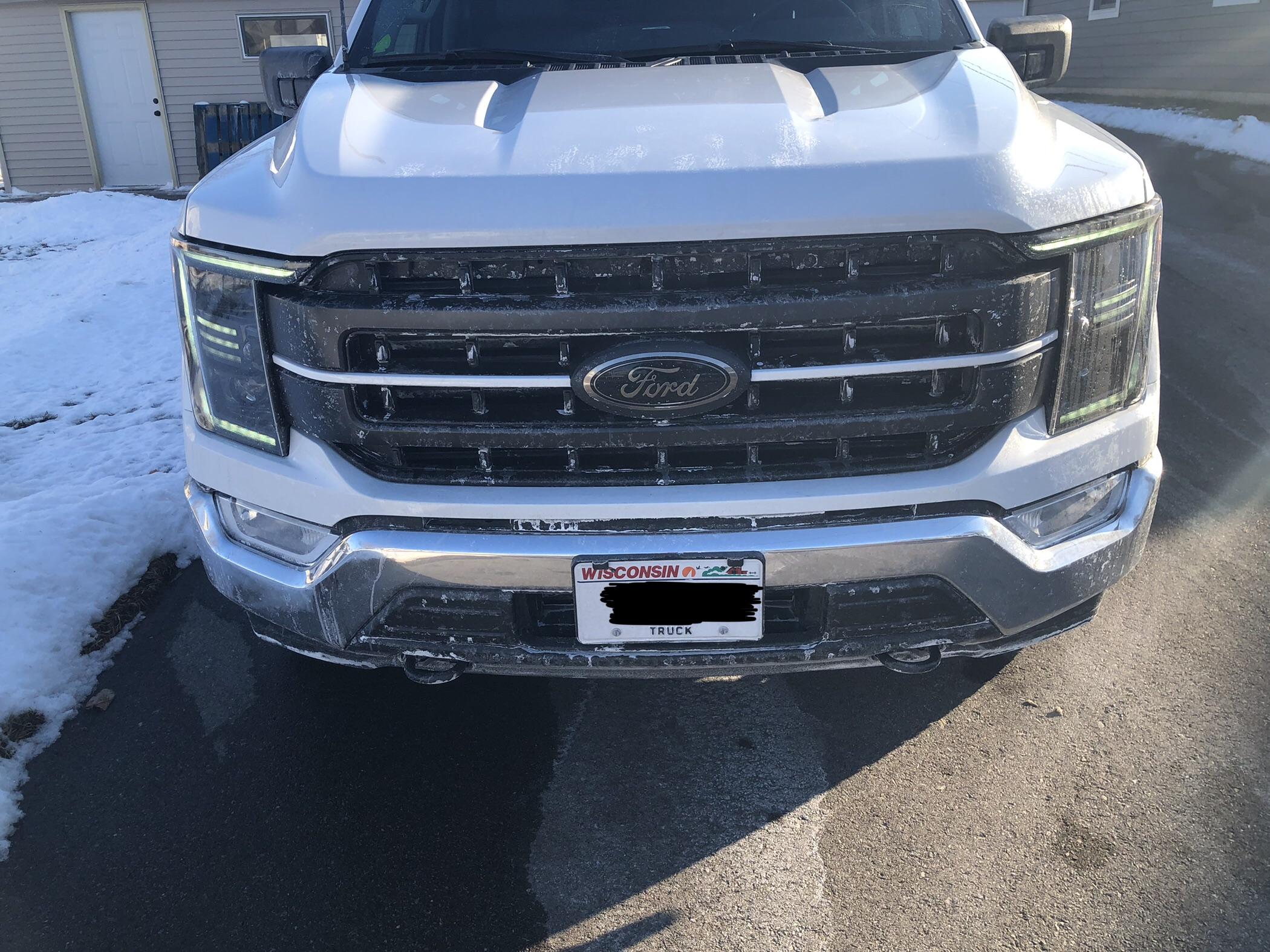

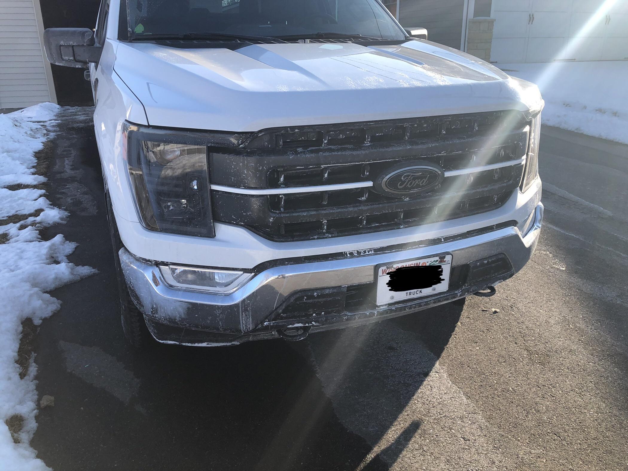

Here’s a few photos. Note the white drl in the daylight will be brighter when I get the harness wired in properly. Fuse 124 isn’t working how I thought.

I’m pretty happy with them! Only complaint/quirky thing about them is that the turn assist light turns on even when just changing lanes with the quick 3 cycle turn signal function. But overall a huge upgrade to the halogens with the alpharex pro and led swap.
