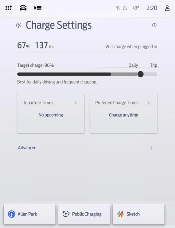

Hi F-150 Lightning owners,
We’re excited to announce that launching with the 2025 F-150 Lightning is an expanded Charge Settings app on the touchscreen and other improvements to allow you to take better control of your vehicle’s charging, including many improvements based on suggestions from our customers and owners (including many within this group!) – thank you.
Ford F-150 Lightning Announcing: Expanded Charge Settings – Take Control of Your Charge 01 - Charge Settings Not Plugged In

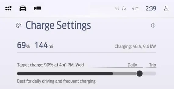

With the addition of Live Charging, you will be able to view your F-150 Lightning's charging speed in real time within the Charge Settings app.
When you’re charging on a Level 1 or Level 2 AC charger, you’ll see both your charge rate in Amps as well as kW:
Ford F-150 Lightning Announcing: Expanded Charge Settings – Take Control of Your Charge 02 - Live Charging AC Cro

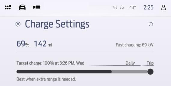

And when you’re DC Fast Charging, you’ll see your charge rate displayed in kW:
Ford F-150 Lightning Announcing: Expanded Charge Settings – Take Control of Your Charge 03 - Live Charging DC Cro
Global Target Charge
With the updated Charge Settings app, your Target Charge limit can be set with one simple slider, and the target will apply everywhere – no need to save a location first. To change it, just drag and release the slider. This target charge level will apply to all Level 1 and Level 2 AC charging as well as DC Fast Charging.
Ford F-150 Lightning Announcing: Expanded Charge Settings – Take Control of Your Charge 04 - Slider Detail Cro
You will see a “Daily” portion of the slider from 50% to 90% and a “Trip” section between 90% and 100%. Ford recommends charging your battery to a limit within the Daily range for day-to-day driving and frequent charging, and using the Trip range when you need extra range.
Preferred Charge Times allow you to save charging locations you’ve previously visited and schedule your charging at those locations individually.

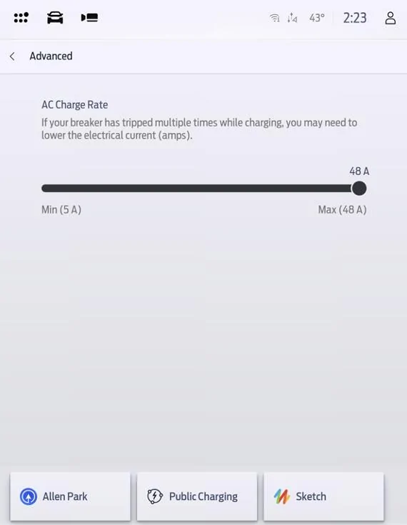

AC Charge Rate Control
With the addition of charge rate control for AC charging, you can adjust your vehicle’s maximum charging speed on a Level 1 or Level 2 charger.
This feature is designed to help make life easier if you wish to slow your charging down, for example to time the completion of charging to align with when you will return to your vehicle, or if you’ve experienced circuit breaker trips at a certain charger.
By default, this value will be set at maximum AC charge rate for your vehicle. To reduce this rate, tap the Advanced option from the Charge Settings screen, and an AC Charge Rate slider will appear.
Ford F-150 Lightning Announcing: Expanded Charge Settings – Take Control of Your Charge 05 - AC Charge Rat

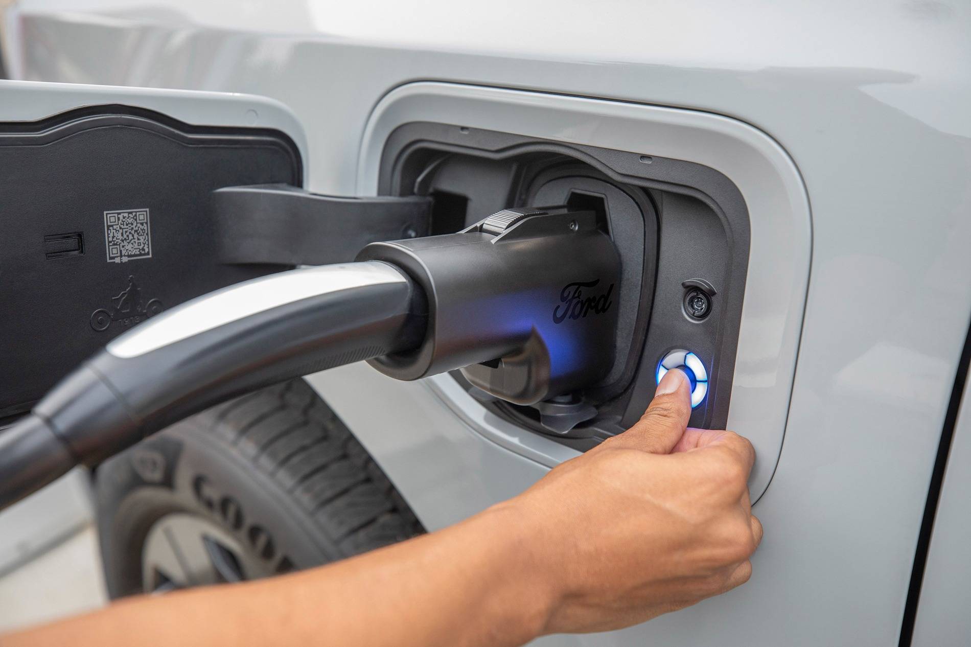

Charge Port Locking
To improve Fast Charging Adapter security and reduce the chance of your vehicle being unexpectedly unplugged when fast charging, your vehicle’s charge port will no longer automatically unlock when fast charging is completed.
To unlock the charge port, you will use the unlock button in the middle of the Charge Status Indicator light located next to charge port:
Ford F-150 Lightning Announcing: Expanded Charge Settings – Take Control of Your Charge 06 - Charge Status Indicator
When pressing this button with your vehicle’s key (or your phone with Phone as a Key (if equipped)) near the charge port or with vehicle doors unlocked, charging will stop and the charge port will unlock.
If the unlock button is pressed without the vehicle’s key present,the charge port will remain locked and charging will continue. If a press of the charge port unlock button does not unlock the charge port, ensure a key is positioned near the charge port, or press the door unlock button inside the vehicle.
Charge port locking applies to DC Fast Charging only. Level 1 and Level 2 AC charging can be unplugged without pressing the unlock button.
Ford F-150 Lightning Announcing: Expanded Charge Settings – Take Control of Your Charge 02-live-charging-ac-crop-jpg
48A @ 208v is 10.0kW (and pretty rare to be on 208...)
48A @ 240v is 11.5kW (and much more common)
69%.... oooookay. Did they pick 9.6kW because its 69 backwards?
Ford F-150 Lightning Announcing: Expanded Charge Settings – Take Control of Your Charge 03-live-charging-dc-crop-jpg
69%.... 69kW. Oooookay. Who's the sexaholic in marketing? Might need some light coaching.

Who was responsible for that feature addition? Thats totally stupid....
Charge curve falls off at 80% on DC charging, so it normally makes sense to stop there, unless you're going through a charging desert... then your going higher.
AC... every day charging, most people are in the 80-95% range...
Combining them under 1 global slider is.... pretty par for the course for you guys.

@Ford Motor Company I love the addition of the updated locking feature on the DCFC charge port, thank you for listening and adding that feature!
Charge curve falls off at 80% on DC charging, so it normally makes sense to stop there, unless you're going long range... then your going higher.
Two sliders, stacked, one for AC Charging and one for DC charging would be a simple remedy.
