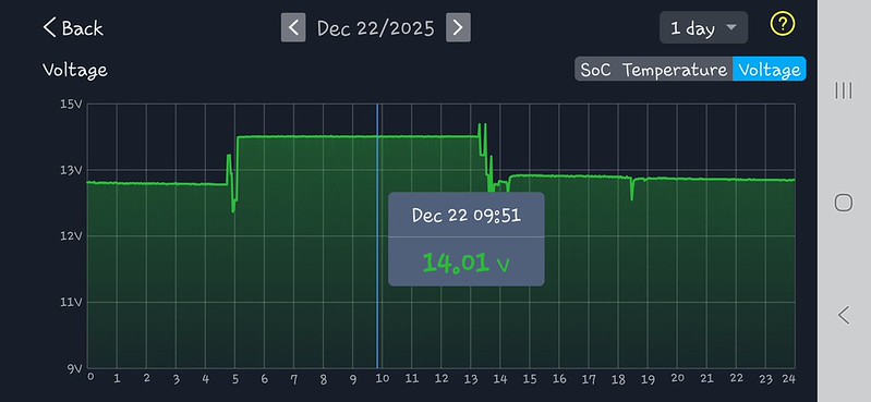

Adding to when the battery is being charged, in the graph it's showing a steady 14v between about 5am until almost 2pm.
I have a dual channel dash cam/dvr I run via cabin 110v to act as a sentinel while parked at work since Ford can't/won't let us use the 5 cams already on the truck. The truck is off with ppob on (2025) and is showing at least the potential of charging as it's only reading volts, no idea on how much if any current is flowing.
Yes, if PPOB is on, then the HVB is connected and powering the inverters for the PPOB, and it would seem the DC-DC converter is also connected keeping the 12v battery system steady and charging the battery.
What happened at 2pm?
Did you turn the truck on resulting in a load on the battery?
Something put more of a load on the 12v battery system.
During charging, typically the voltage is held steady like in your graph, and the current gradually falls as the battery gets fuller.
The battery voltage will drop under load, but that's only a 'problem' with our AGM batteries if it goes down below 11.6V which could be a sign of a bad or undercharged battery or an excessive load.

On your graph from about 8:15pm to 6:45am the next day, was the truck actively charging (energy being put into the battery) or just sitting with the charger plugged in.
I suspect it finished charging at the 6:45 time frame, which matches all my previous data.
One reason I set my charge station to charge slower (40A instead of 80A) is that it helps to charge the LV battery better due to the more time charging.
Yes, it finished charging the HVB around 6:45am and and then was just sitting plugged in.
