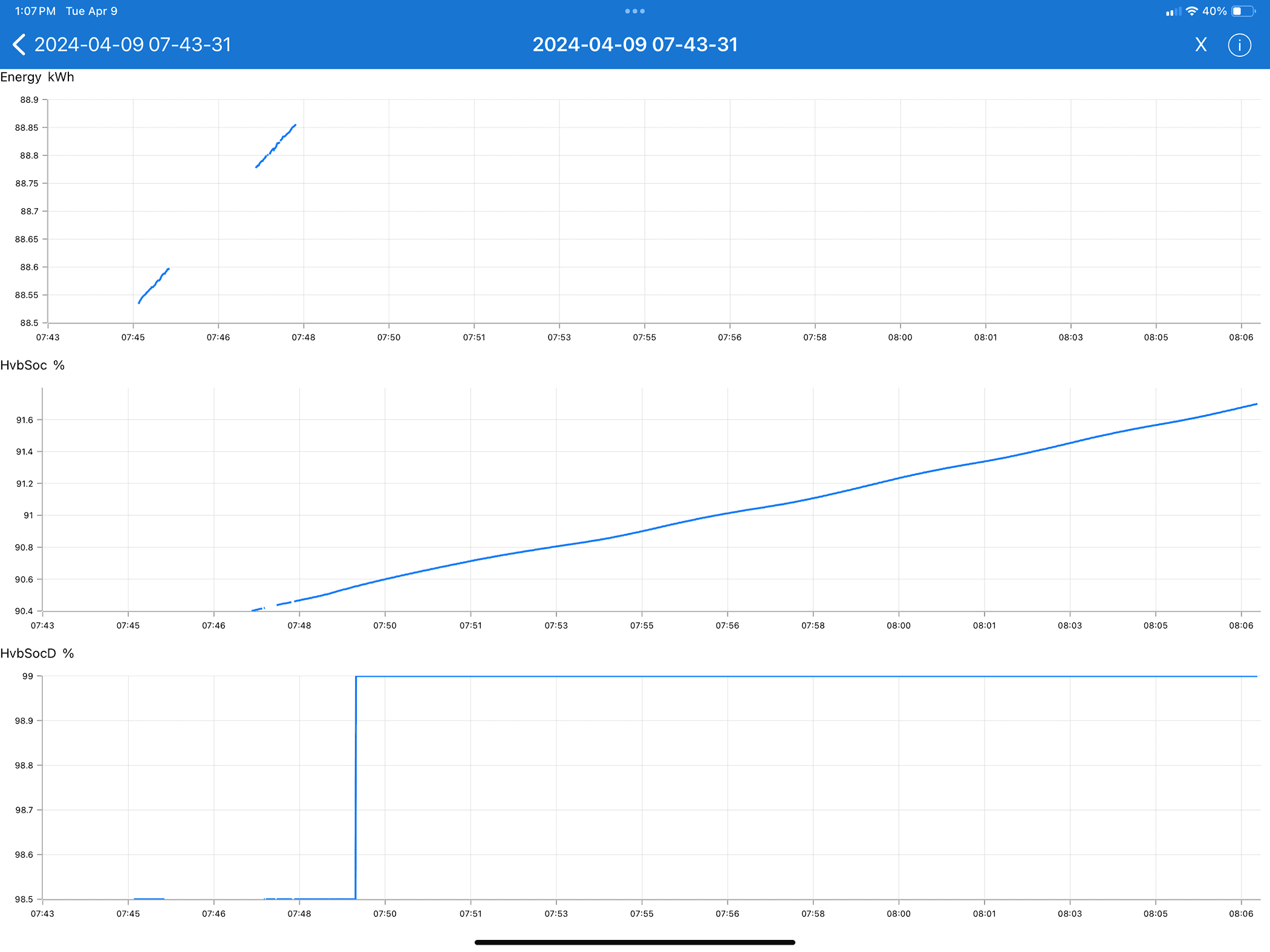

This is kind of a happy coincidence because I just sort of did that. Like you I had to leave before the truck stopped charging but this is the last few minutes, when the display was showing 99%. It was 100% just a minute or two later because my wife noticed it. I don't know if the charging would have shut off at 100% indicated like it does if I tell it to charge to 80%. I hope not. I do not know why the Energy kWh stopped being recorded, just before I left it was 90.65 kWh (top graph), 91.74% Hvb State of Charge (middle graph) and 99% indicated (bottom graph.)
You can see that the truck's idea of the internal charge of the battery keeps rising non trivially even after 99% is reached, so if your goal is to get as far as possible on one charge you want to keep it plugged in. Note this is a SR truck with a 98 kWh battery usable supposedly, so I think that my truck has drifted below reality. I have never seen an indicated range anywhere near the EPA but in reality on my most recent long trip I was able to get more than the indicated range. (I didn't drive to zero, it just kept readjusting.)

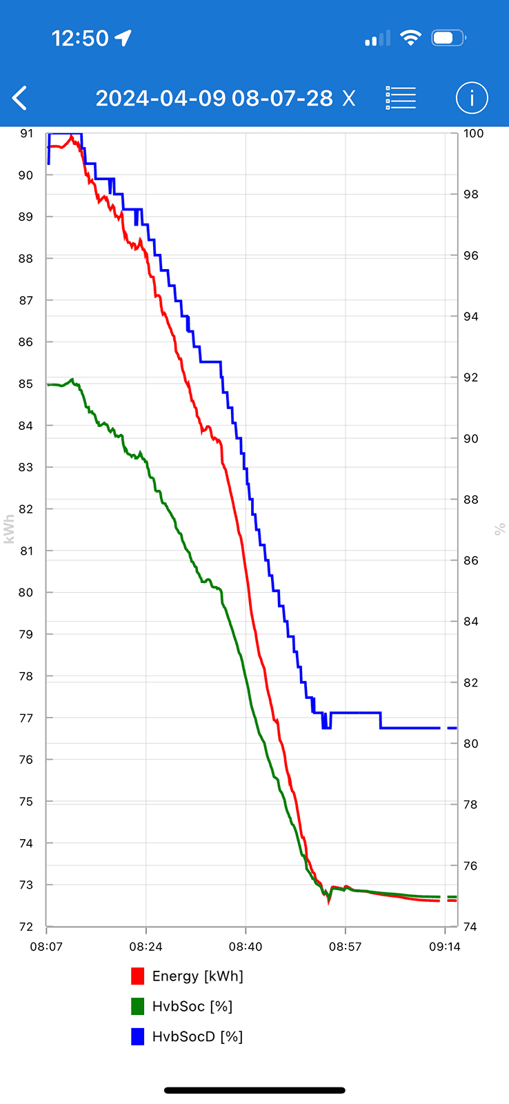

And this is what I find really strange - this chart shows the indicated state of charge (blue) vs the internal state of charge (green) while driving along with the estimated total energy left (red). These are both estimates but they should both be based on the same data, so you would think that the difference between the two would be constant. It isn't - the indicated state of charge initially drops much faster than the internal and the total energy left just does its own thing. Why?

I would like to know how much of the truck's behavior is determined by these parameters. It seems like the time at which it cuts off charging is determined by the indicated battery percent, so you might not be charging the battery as much as you think you are (or in the worse case, charging more than you think.) I hope that the actual charging decisions are based on observed parameters like temperature and voltage instead of coulomb counting with occasional resting voltage recalibration.
