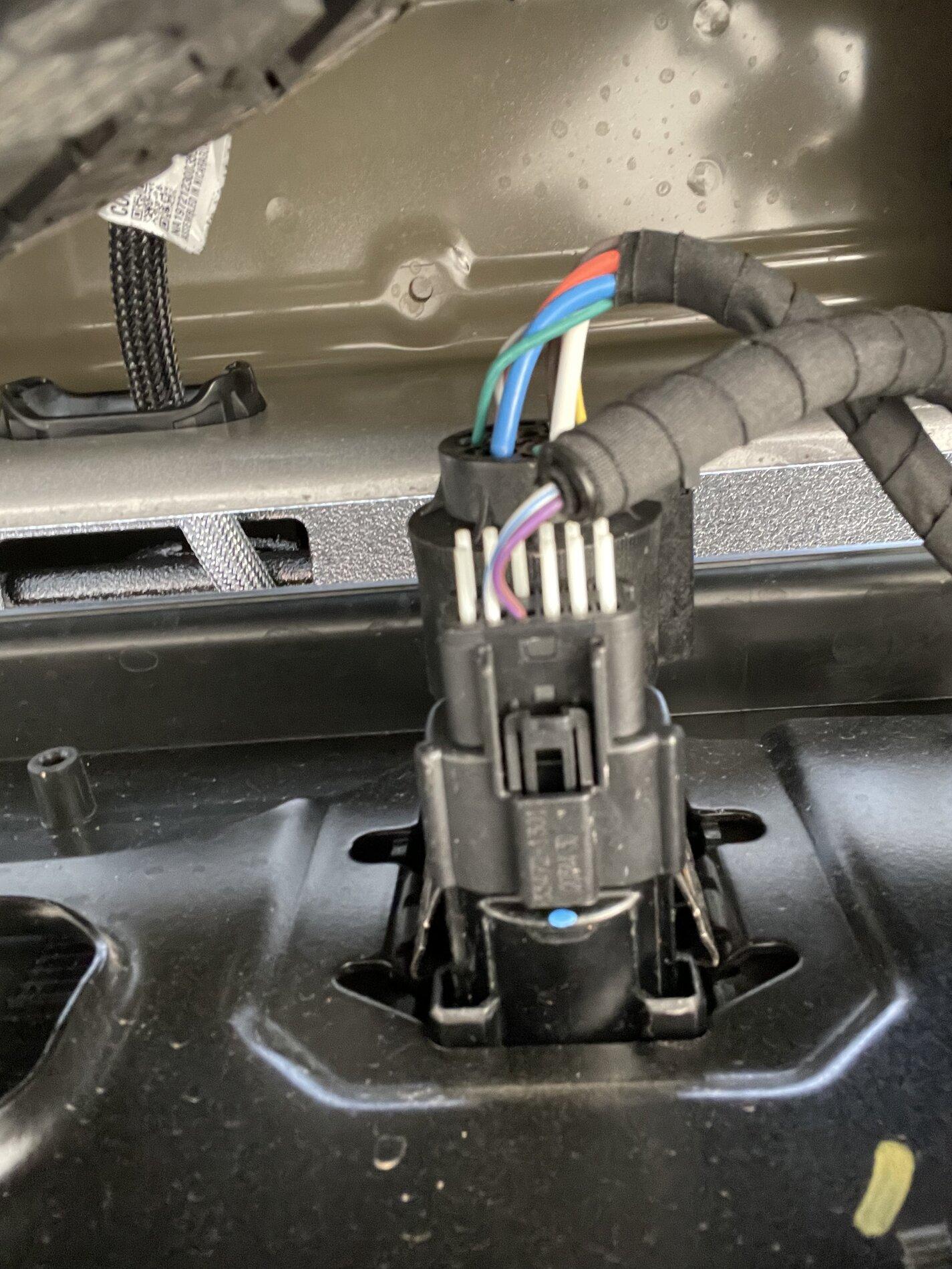

I have a late build F150 (September-21) and I'll check this connector tomorrow. I left the truck at work.
The kit that came with my truck had stickers in it and the literature said that the Raptors would be send software to enable the stickers at a later time. Hinting that my truck could already use the sticker or the sensor. My truck didn't come with a sensor, but I got one off another owner who didn't need his.

My smart trailer connector only has the two wires.
