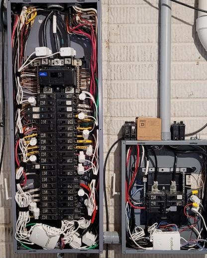

Instead of tracking incoming power to panel could I just use a lead on each of the lines to my charger?
Yes. I have one on my main and one on my FCSP.

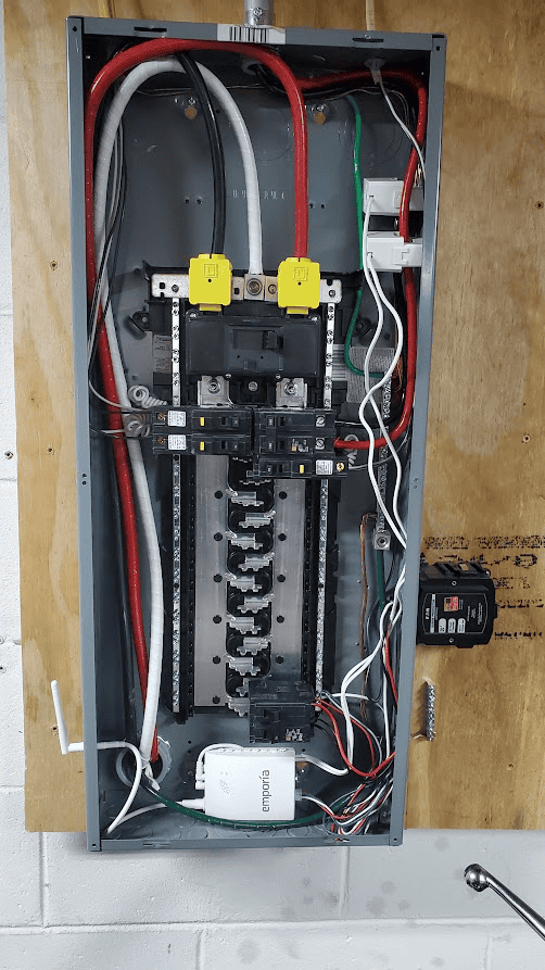

This is how you would connect the monitoring loops feeding your EVSE from inside the breaker panel.
Ford F-150 Lightning Anyone have a way to calculate monthly charging $$$ 1674570932834
3,813
6,965
I was going to post a picture of my install but yours is easier to see.
Ford F-150 Lightning Anyone have a way to calculate monthly charging $$$ Screenshot_20230124_100540_Gallery
Perfect.... Thanks for the picture I ordered it on Amazon last night after your original post @TaxmanHog has never led me astray ???
