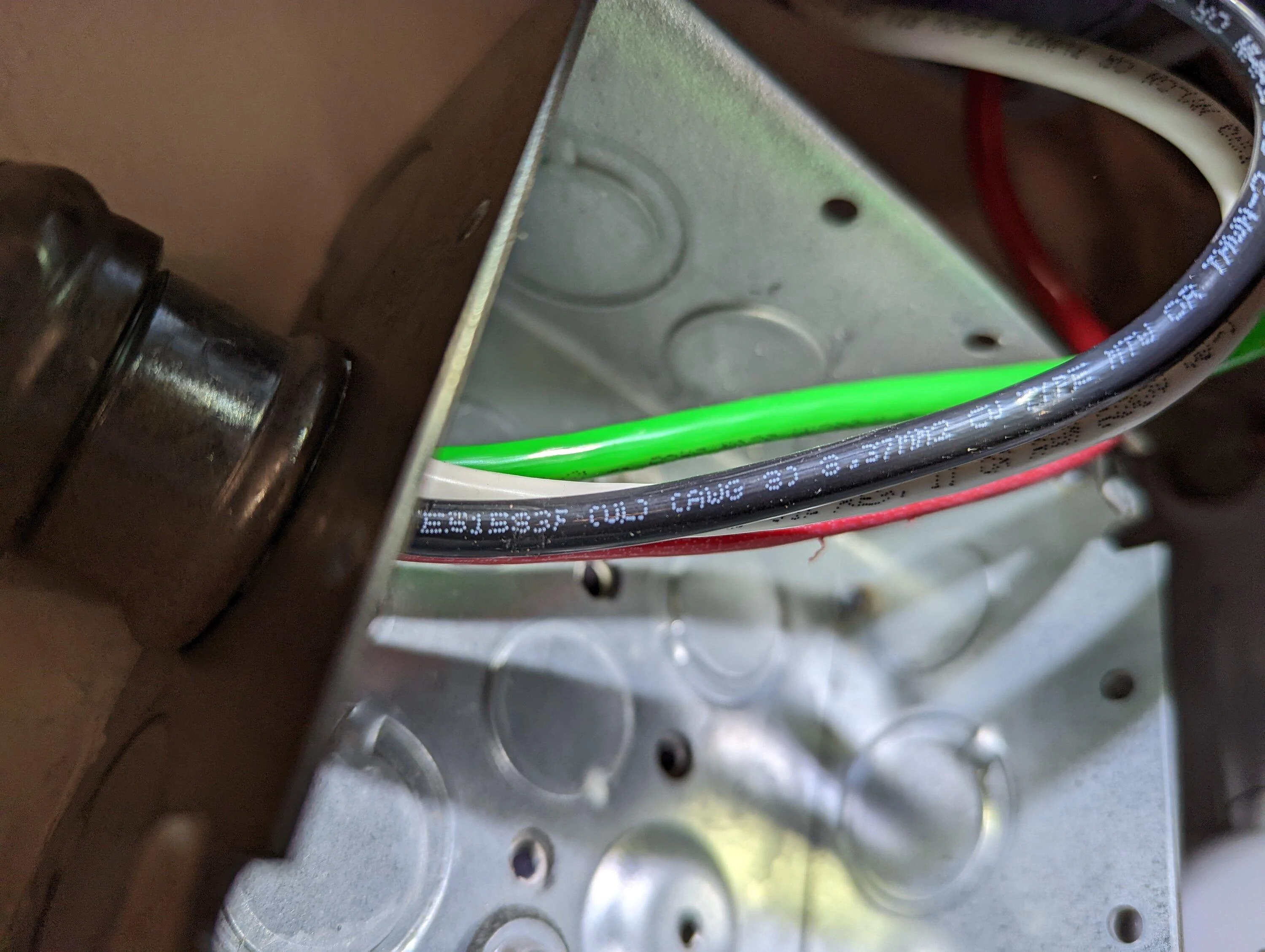

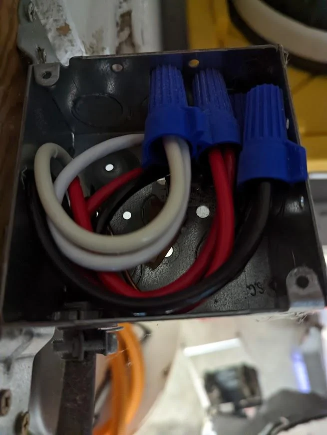

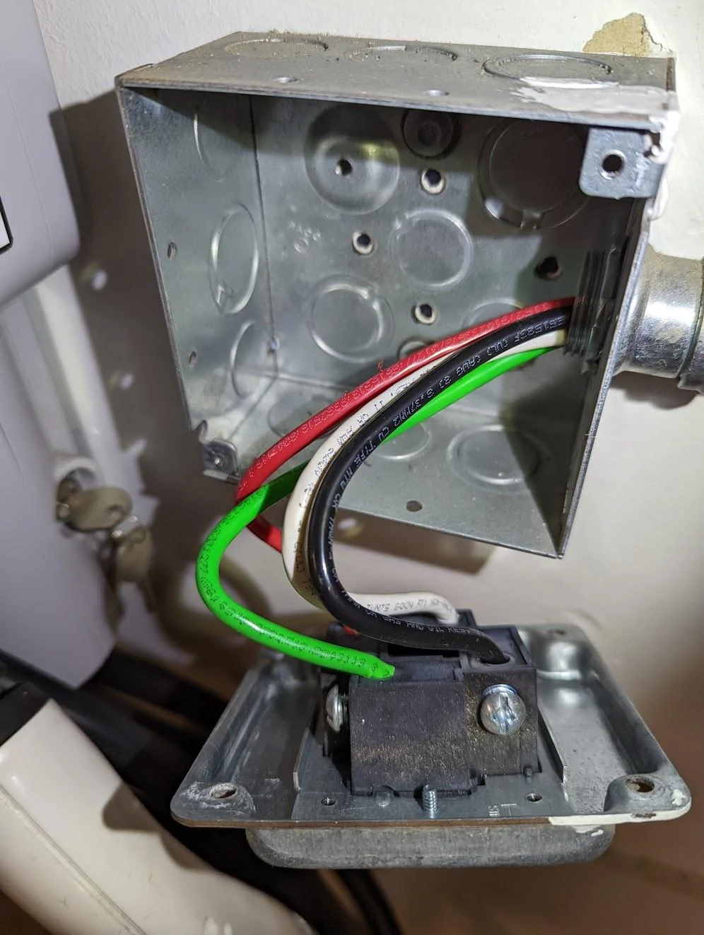

Unfortunately I think I spoke too soon. I remembered that I needed to check my existing cord to see its AWG size and whether it has a neutral. Pics below. I am pretty sure it is 8 AWG, which is disappointing. It does have a neutral. So I think going 8/3 is my best option. There is no point in running 6/3 when it is connected to a 8/3 to the panel, right?
So am I good if I use this 8/3 romex wire from home depot in a conduit for the outdoor run: https://www.homedepot.com/p/Southwi...x-SIMpull-CU-NM-B-W-G-Wire-63949202/202316278.
Thanks for all your help on this!
No, unfortunately that won't work, because any time you use NM cable, you have to use the "Romex rules" and 8/3 is only good to 40A (32A charging). If you're building conduit anyway, I would suggest just buying individual THHN/THWN #8 wire.
Using individual #8 wires in conduit (like what you appear to have there), you can use 40A charging (50A breaker), because #8 in conduit is good to 50A. If you use that 8/3 cable, it's not enough.

I did some digging on my install for the first Juicebox. The invoice lists "RMX 83 8/3 W/G ROMEX WIRE," so it is definitely 8/3 Romex. Although the picture shows individual wires in conduit, the entire run is about 30 feet and the first half of it from the panel to the back of my garage (all inside) is just the cable, then for the second half there is a junction box and he runs the individual wires along the wall to the charger. Below is a pic of the junction box. Is this still a problem? And if it is, how big of an issue is it? I would strongly prefer not to redo this work.
Answers to your questions:
Plan is to splice into the existing 8/3 cable a few feet from the panel and make the new run off of that. i bought these tap connectors to make the connection, similar to what the guy does in this video. I was going to just going to stick the cable into conduit for the entire run (especially outside), but it sounds like I may need to run individual wires rather than the NM cable. The conduit would run from the junction box, yes. The placement of the junction box pictured below is not ideal for me, so I think I would install a new junction box close to the panel. I did not plan to move the existing unit to hardwire, does that make a difference?
Again, thanks so much for guiding me through this.

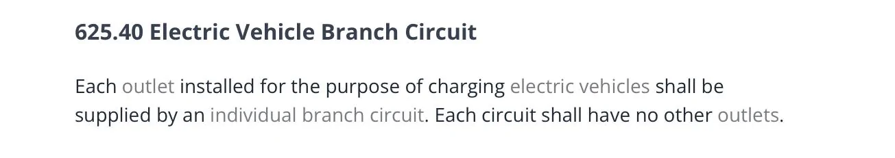

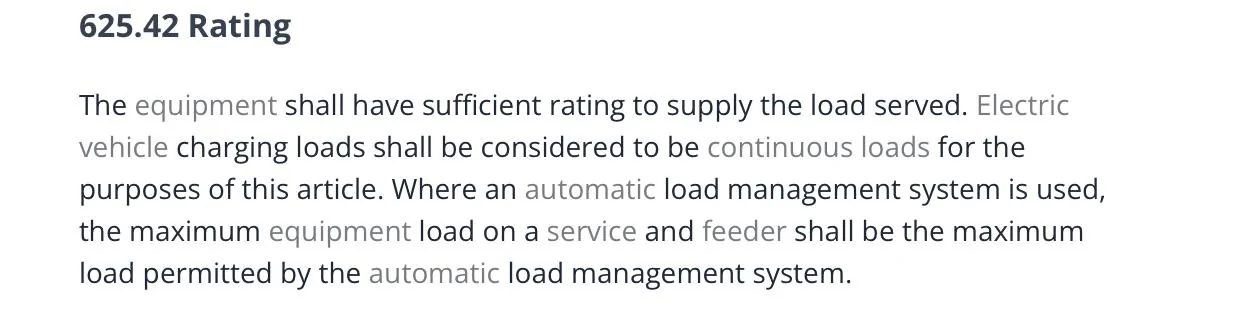

They cannot share a single branch circuit. They can share a feeder that has less capacity that the sum of the two EVSEs, and only one needs to be included in any load calculation.

Not sure what a "feeder" is, but the purpose of load sharing is sharing a breaker. Here is the manufacture citing code sections:
https://support-emobility.enelx.com/hc/en-us/articles/360002651411-What-is-Load-Sharing-
I don't speak electrician so I can't translate for you :). Tesla has a similar setup, although they have a hardwire connection between the chargers to the load sharing, while Juicebox does it via the internet.
Yes, that link says the same thing as my screenshots. Load sharing can be taken into account only for feeders and services.
A feeder terminates on one or more overcurrent devices (not utilization equipment). This is why Flasher suggested installing a small sub panel with a breaker for each EVSE. So you could run #8 from the main panel to the small sub panel. Install two 50A breakers in the sub panel, one for each EVSE, and run #8 to the EVSEs.
Such a panel would cost less than $50 without the breakers.
