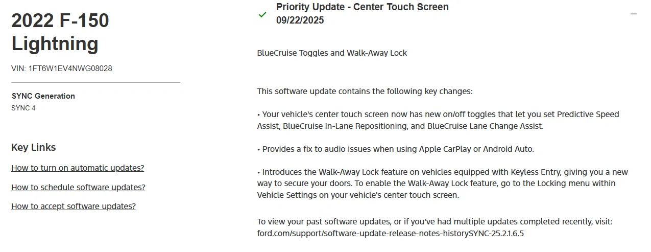

I still don't have WAL because OTAs stopped for my truck before the necessary BCM update, and that module can't be updated through FDRS without dealer credentials.
Since I suspect the OTA to enable the toggles includes an APIM update, and those are now withdrawn from FDRS I see little point to trying to talk a dealer into doing the work for me. I suspect in practice my truck will never get updates again, despite Brian at @Ford Motor Company attempting to help. The only light I see on the horizon is that the recall may force the issue somehow.

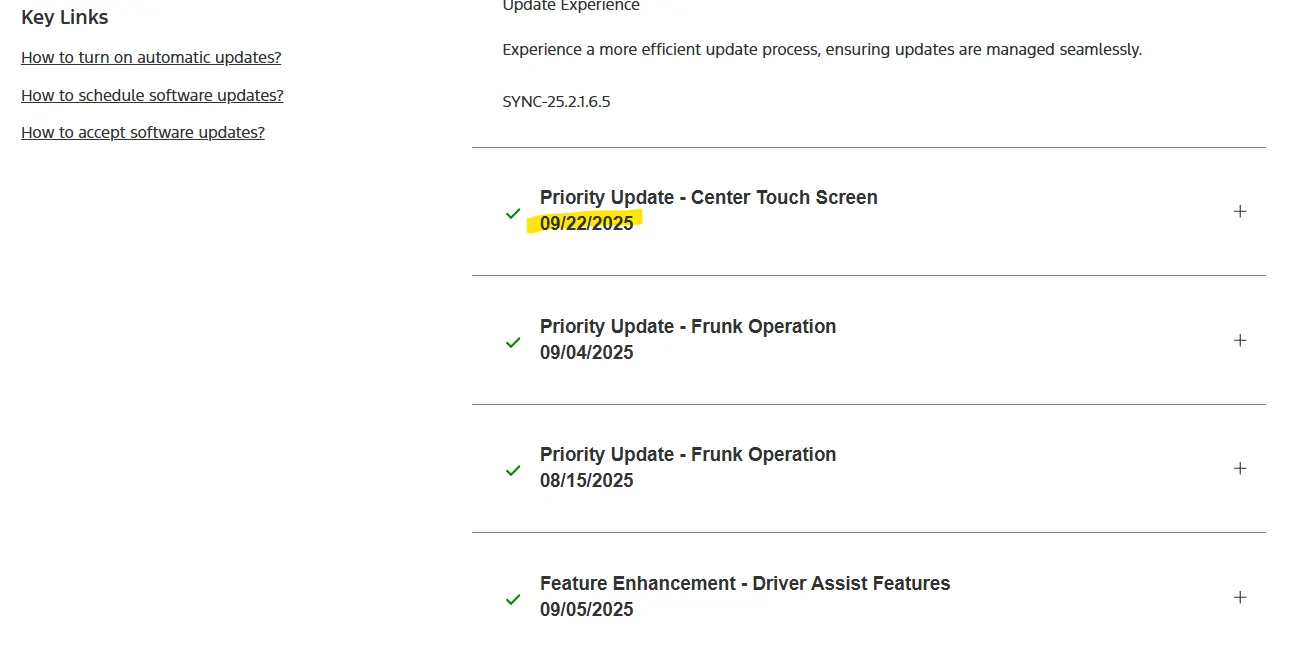

My 22 is stuck trying to install a frunk update (has failed about 20 times).
Good luck!
Charge up the 12v battery before the OTA trigger expires and you have to wait for it to be resent.
Is your truck connected to Wi-Fi? I have found that most updates will not occur if the truck is only on cellular. This is even true with my '24.
You are correct that 98% of updates come in through cellular. However, being connected to WiFi won't prevent updates from downloading. The vehicle will still download the files using the modem while connected WiFi.

Seems like that only applies to those on much older APIM versions? Think my 23 is on 25094 Revision 1779 but I've updated a lot in FDRS previously.
SSM 53966 - 2021-2025 Various Vehicles - SYNC4 - General System Performance And Stability - Programming No Longer Available
Some 2021-2025 Ford/ Lincoln vehicles equipped with SYNC4 may not be able to perform an update to the accessory protocol interface module (APIM). This may be due to the software in the APIM. Ford Engineering has de-activated the ability to update these SYNC4 APIM modules as applicable, and the Ford Diagnosis and Repair System (FDRS) will not present an update for the APIM module. Some existing directed repairs may be impacted, check Professional Technician System (PTS) before attempting any specific technical service bulletin (TSB)/special service message (SSM) and check field service action (FSA) landing pages before attempting any FSA repairs. For any vehicle repairs requiring a software update that includes an APIM update in the programming sequence, if the 5-digit product code for the APIM software is equal to or lower than 23187, do not attempt to update affected modules at this time. To determine the 5-digit product code for the APIM software on the vehicle, while the vehicle center display screen is powered up with ignition in run or accessory, go to Settings > General > About SYNC. Find the 5-digit code (example: “SYNC 4, Software Version: 23187_PRODUCT”). If further support is required, follow normal internal dealer escalation process.
