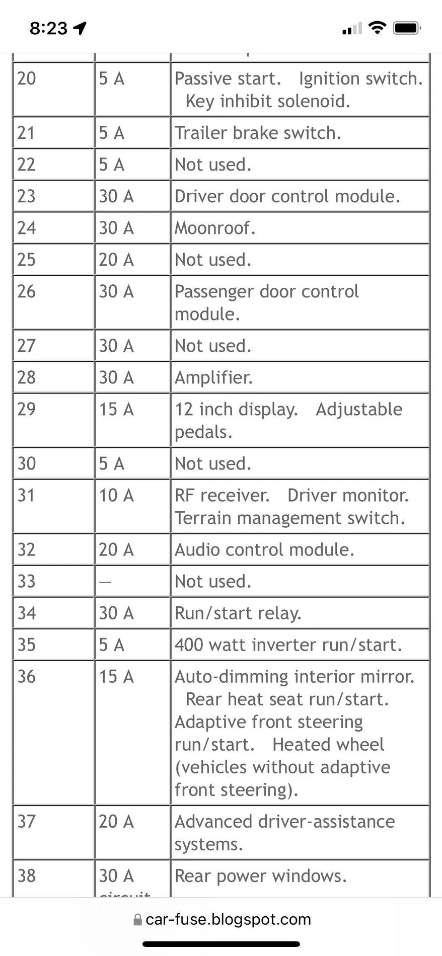

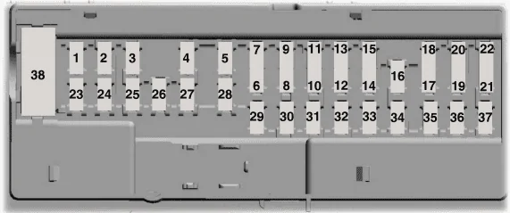

fuse #28 30A amplifier.
Ford F-150 Lightning Audio off. Volume knob does nothing 344D3424-416A-4F96-8A3A-9A8B98E09361
Ford F-150 Lightning Audio off. Volume knob does nothing 550645F5-C4C3-43F5-BFB2-5CA47DBEDA92
Ford F-150 Lightning Audio off. Volume knob does nothing EB1B2616-857F-450F-A167-7A58A0881F05
