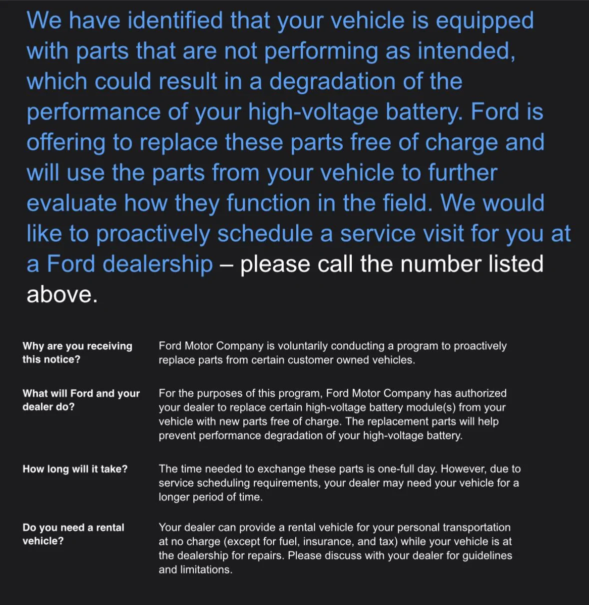

I have seen. Few people post about this “Harvest” program. However soon after receiving this email my Ford ending up acting weird. Now it will charge to 100% but once I drive it drops to 83% and 260 mile range. Lariat ER. 6500 miles. December 2022. I have responded to the email a few times and called a few times but no one is responding at Ford. I just reached out to my dealer instead. Will let people know.
For the purposes of this program, Ford Motor Company has authorized your dealer to replace certain high-voltage battery module(s) from your vehicle with new parts free of charge. The replacement parts will help prevent performance degradation of your high-voltage battery.

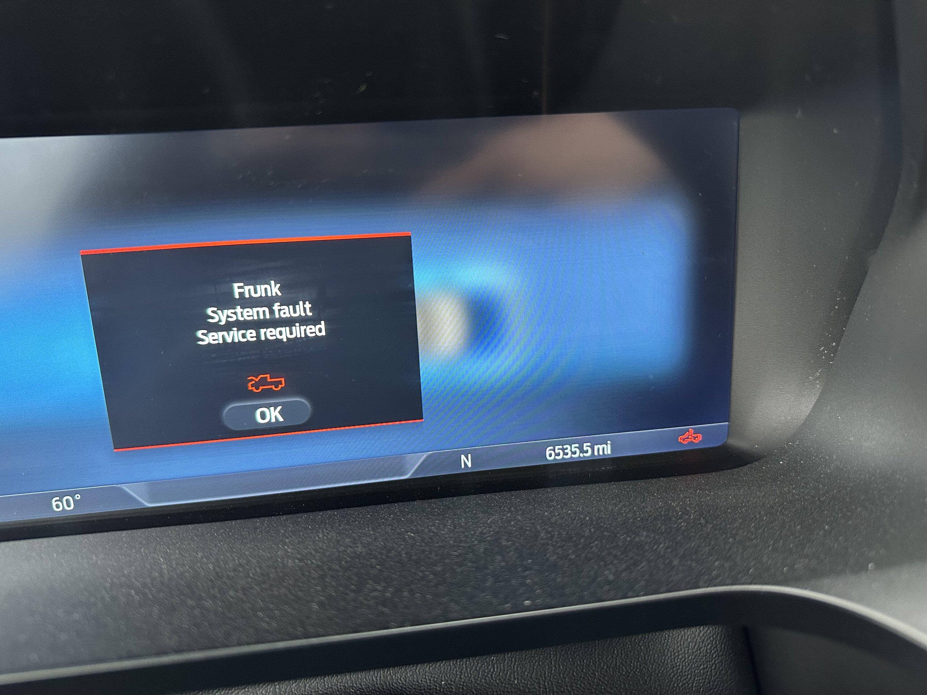

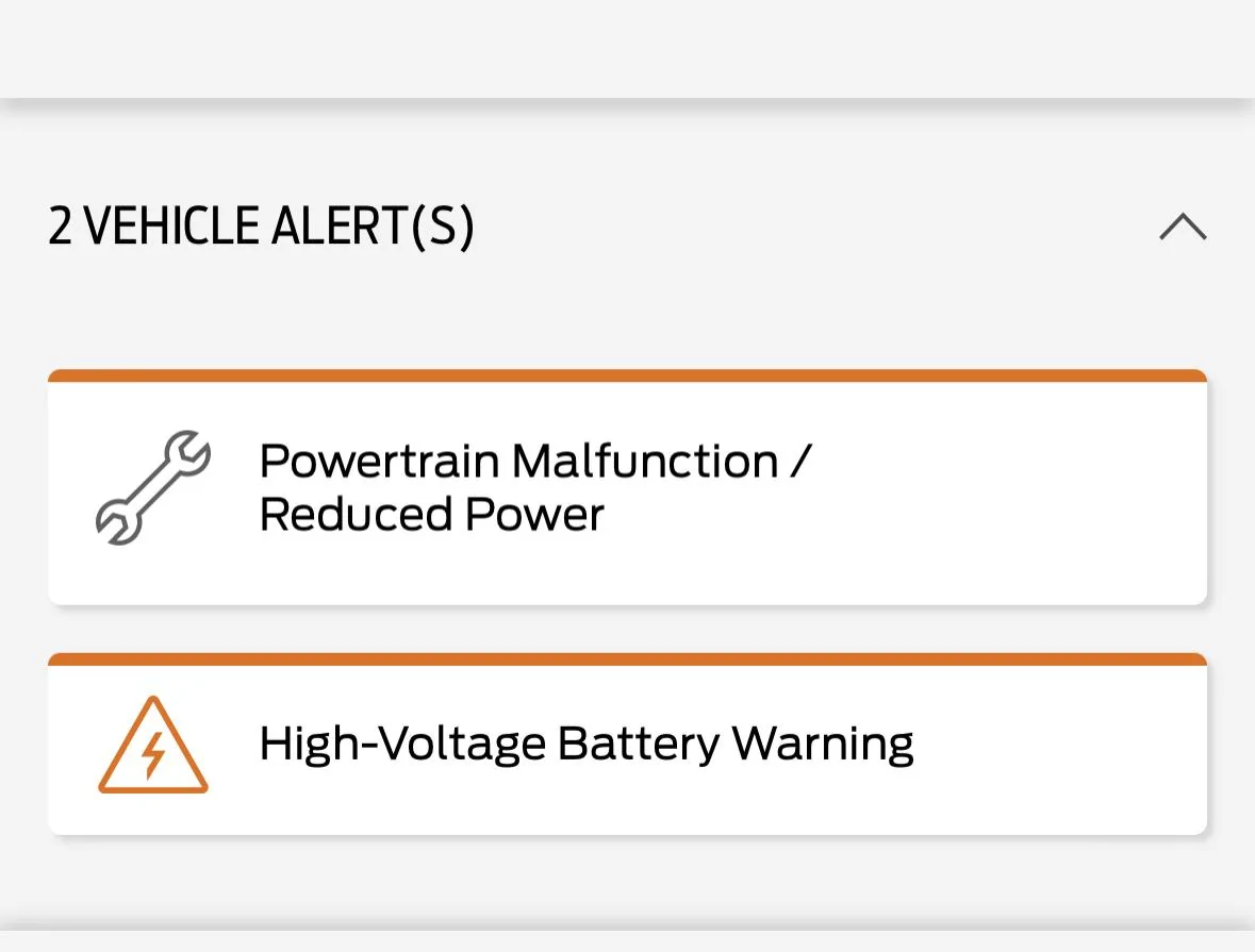

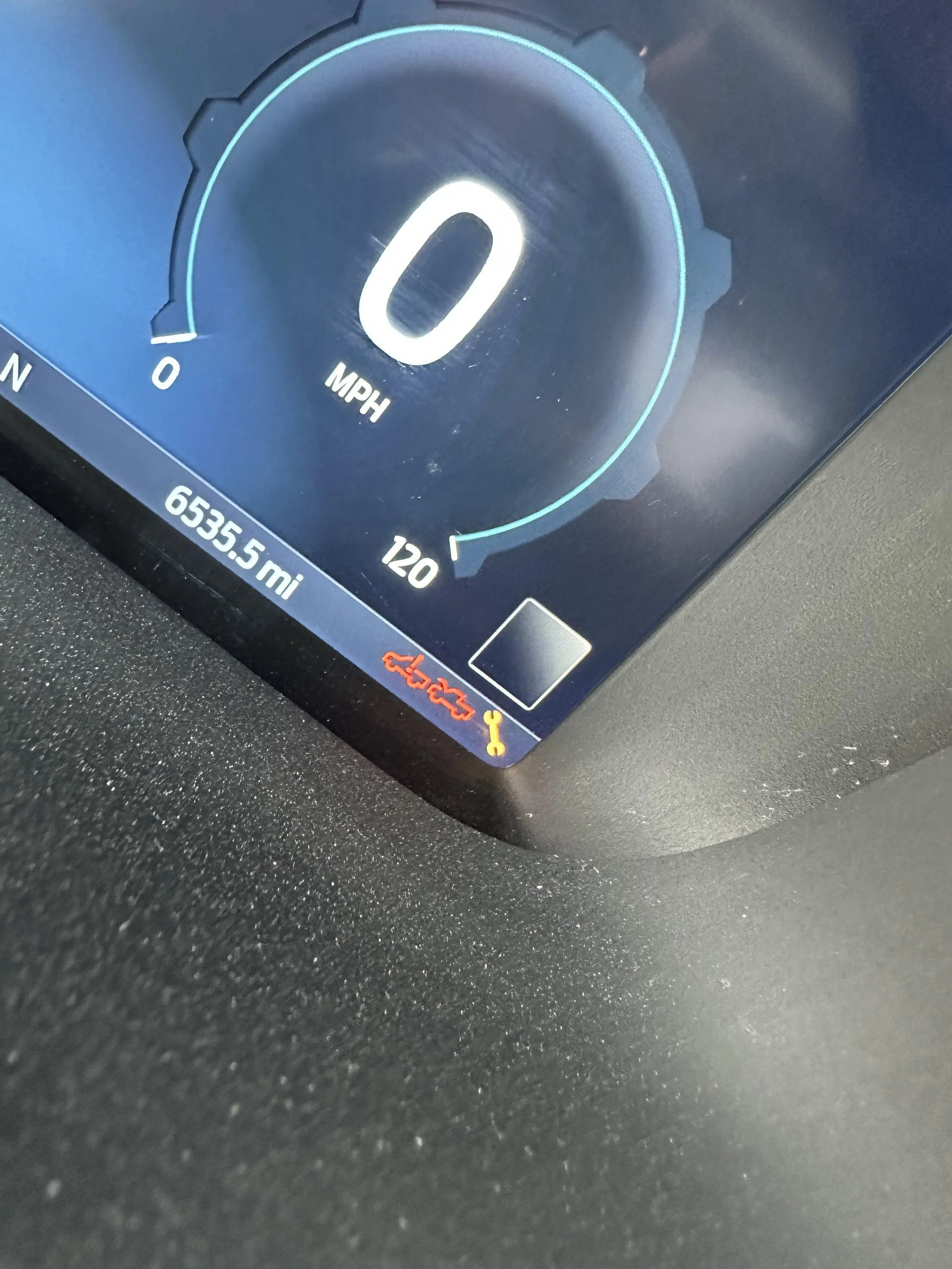

Yikes even worse. Just drove 120 miles. Stopped at electrify America. The 350kwh charger kept failing when initiating so I switched to 150kwh which worked ok to charge to 82%. Then went to drive and I got faults and it made me pull over and park. Just used fordpass to get roadside assistance. Easy to use but… because the dealer was 60 miles away and the service only supports 50 miles they made me pay $180 via a text link before sending someone. That’s kinda sketchy? At least the app and payment experience was ok.
