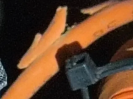

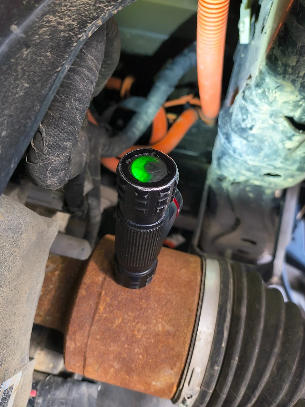

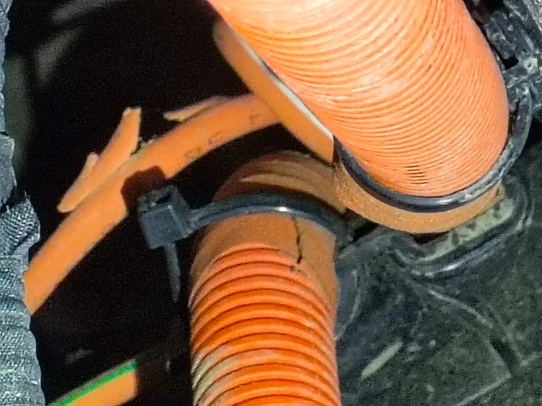

Just got off the phone with the service dept and they may have found the ultimate culprit behind all of my Pro's problems. There is a high voltage cable near one of the rear wheels that has a small wear spot, so spray a little water on the area and presto, a dead truck. The tech discovered the issue by spraying the entire underneath then narrowing down the wet areas until the truck died consistently. Wait for the area to dry out, reset the truck with his computer and now they've got the truck to shut down ten times using just a dropper bottle. This cable ties into the PTC along the way, which is what was thought to be the problem last time, but driving through 7" of fresh snow at the ski area may have killed the PTC because of the spot on the HVW. The tech had the truck shut down in his driveway during the PTC problem, but after driving through several miles of slush. The drain of the 12V battery, which was thought to be the problem with the first shut down most likely can also be sourced to the cable while driving 5 miles in slush. I washed the truck and then parked it in the shade alongside the house on April 1, the last time it died. Apparently, with the movement of the wheel and suspension the spot doesn't always get wet hence the truck didn't die on every trip in the snow and rain since December.
VERY interesting!
Any chance you could get some pictures to share ?
Also, do they have an idea/opinion as to what caused the wear in the first place?

I'll try for pictures the next time I see the truck. No clue as yet for exactly how the spot formed.
