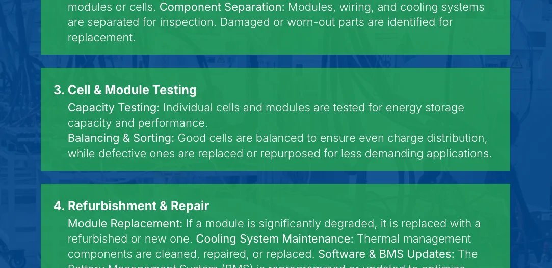

Right the dealership is not going to do a cell level repair, but that's absolutely happening in the real world at specialized facilities. Whether or not Ford ships modules back to a remanufacturer I have no clue, but the principle I'm describing exists and it seems like a valid approach to cost control as well designed for repair as the Ford pack appears to be.
https://atcreman.com/our-remanufacturing/ev-battery-remanufacturing-recycling/
https://autocraftsg.com/news/insigh...-and-misconceptions-around-ev-battery-repair/
https://autocraftsg.com/solutions/ev-solutions/revive-electric-vehicle-solutions/revive-workshop/
Ford F-150 Lightning Battery Module Replacement Cost Out of Warranty (SSM55111) 103k miles 1787777595415-xl
I'm under the impression the physical limitations of disassembly of the cells from the current collectors is a concern, the way they're welded cell by cell makes for a challenge re-welding all the cells with the new / reclaimed cell from other packs to reconstitute a good module.
Maybe some designs give better access than others, the video talks about the possibility / limits around the 13 to 16 minute mark.
Redwood Materials refines the recoverable elements for blending into new stock materials for freshly manufactured cells / modules that are then inserted into the pack.
