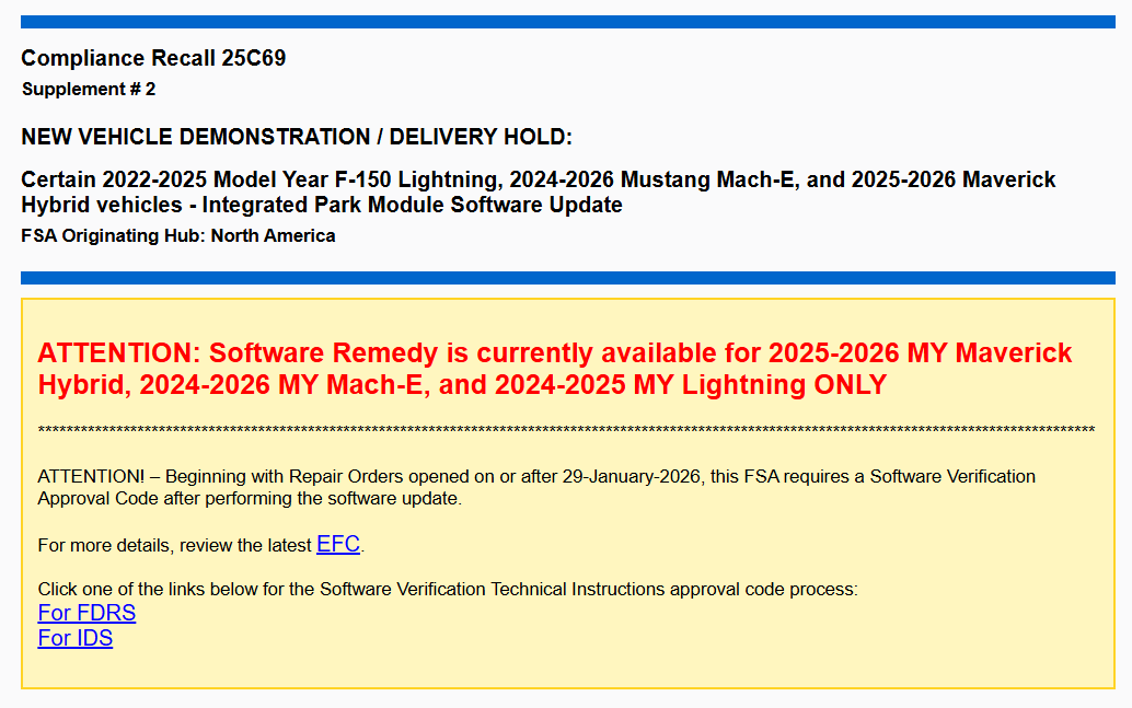

But. Even though I have applied those two updates to the powertrain, 1) Ford has not told dealer techs that they should proceed to update '22/'23 model Lightnings' yet, and 2) as a result of that...I can't (nor can anybody else) get a software verification code that confirms that the software that's been applied meets the requirements of 25C69. The FSA tool simply says it can't find the TSB for 25C69. So this effectively prevents any dealership techs from applying the update/clearing the recall/getting paid for doing it.

You won’t even have to go back in all probability. Once it’s announced on PTS that techs can now apply the update the SA can go to the FSA verification located under the Diagnostics menu and click the verify button to get the code and put that in the required section to clear the recall.

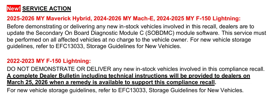

So, posted this morning in PTS an update on 25C69 (labeled Supplement #2):
Ford F-150 Lightning Before You Schedule an Appointment for the Recall 25C69 (IPM) Fix -- make sure your dealer has the actual software update needed Banner_25C69_Sup2
And the details of what's changed are below:
Ford F-150 Lightning Before You Schedule an Appointment for the Recall 25C69 (IPM) Fix -- make sure your dealer has the actual software update needed 25C69_Sup2

Well It's now the morning of the 25th and there is no update on this as was promised (see above). So '22/'23 Lightnings are still not able to get scheduled for repair yet.
