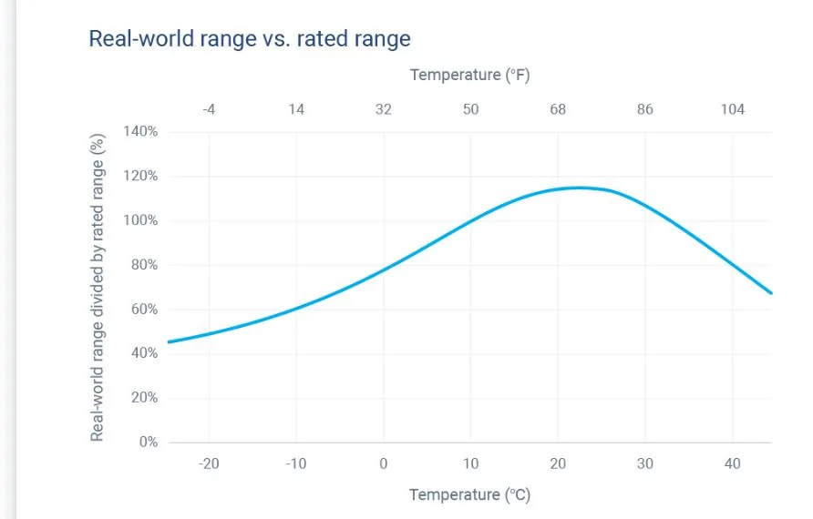

Thinking about the importance of Preconditioning my Lightning Battery for the best Efficiency.
Cold or Hot Temperatures above or below 21.5 C (70 F), the sweet-spot, can reduce an unplugged EV's range by about 20 percent, according to testing by the Norwegian Automobile Federation, and recharging takes longer than in cold or warm weather.
The Optimum temperature for an EV’s lithium-ion battery is between 15C (59F)and 35C (95F). When the temperature drops much below this, the lithium ions slow down and cannot provide as much power as usual.
Ford F-150 Lightning Best Practices For Feeding (Charging) and Caring of Our New Lightnings Battery Efficiency.JPG
Of course, the optimum solutions are having a cooled and heated garage and driving only when the outside temperature is 70F. Perfection is both Expensive and Limiting.

In my experience you will lose almost no range from air conditioning use, only from heating.
