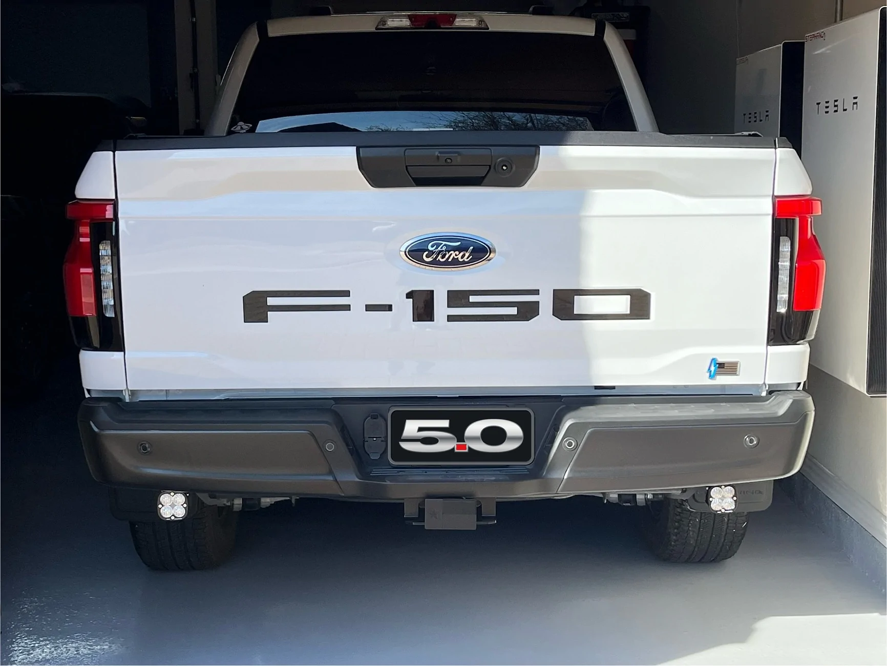

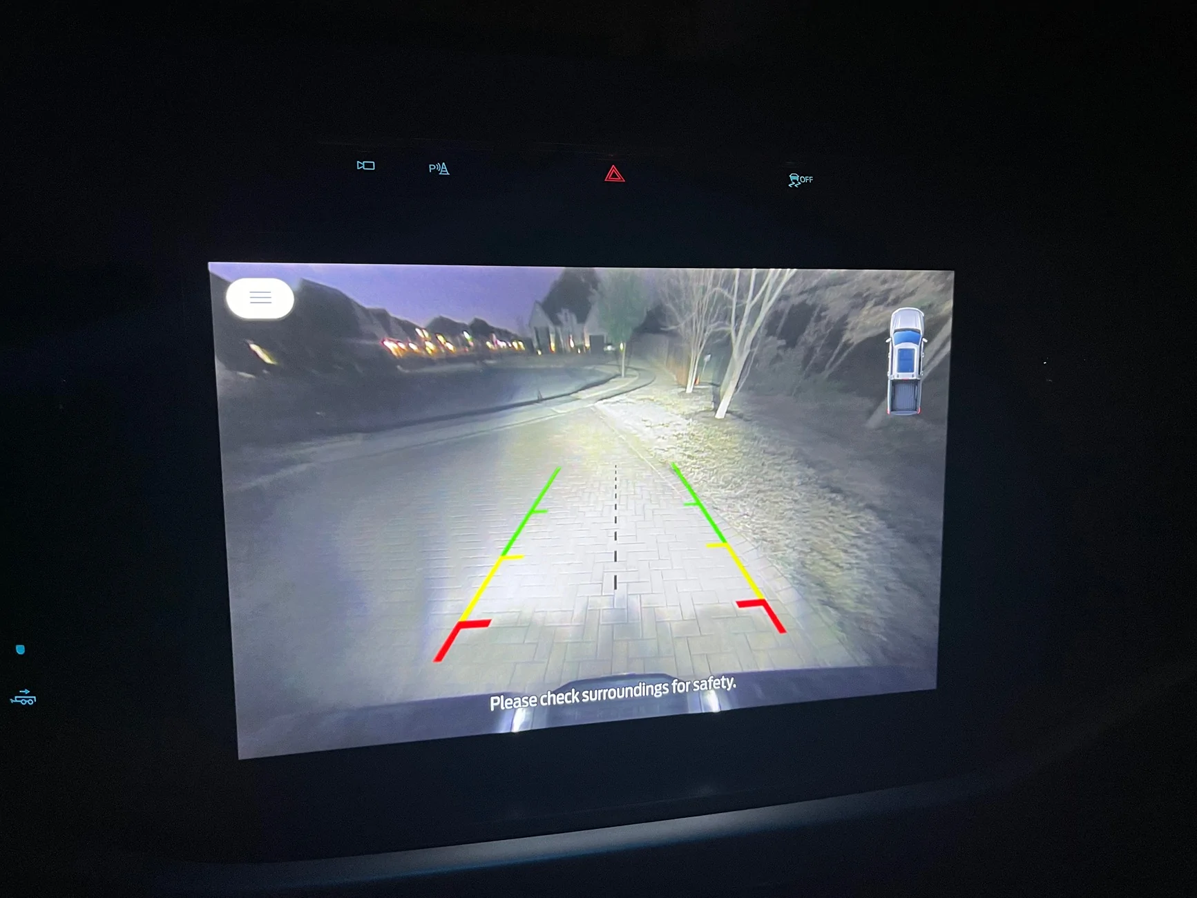

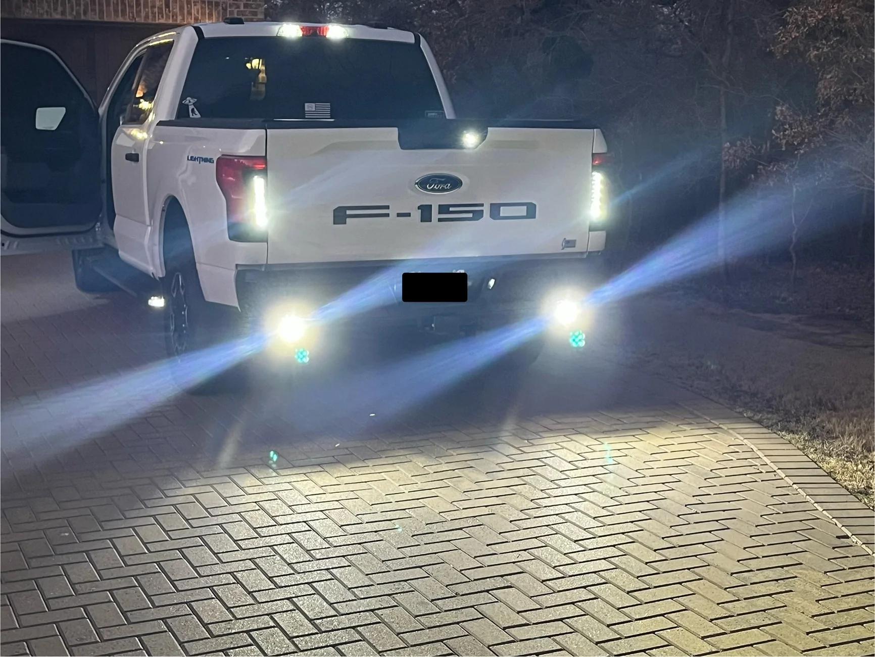

I got these installed on my '22 PRO. Easy install and plug into the trailer harness as a pass-through. They come on when I put it in reverse. No other control of them. They just come on and they are bright.:wink:
I don't know about any of the other issues because I don't use blue Cruz and I don't pull a trailer but these are LED lights so maybe you can look up and see how much they pull and decide if that's a lot for you
https://www.4x4truckleds.com/dual-led-light-reverse-kit-w-baja-designs-lights-7-pin-trailer-harness/
