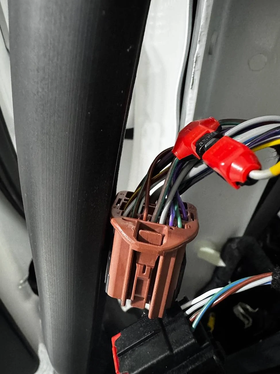

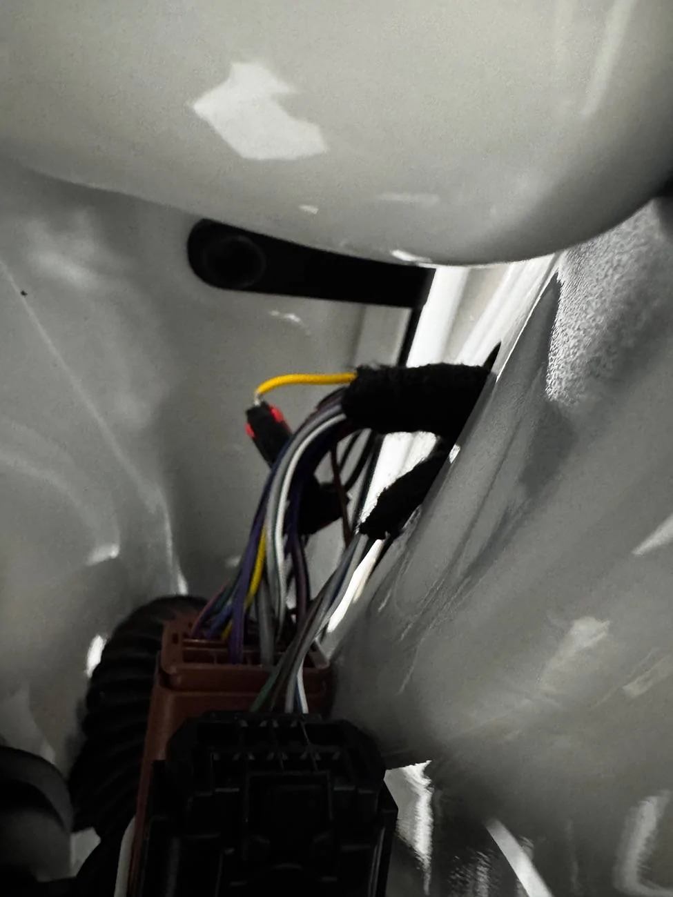

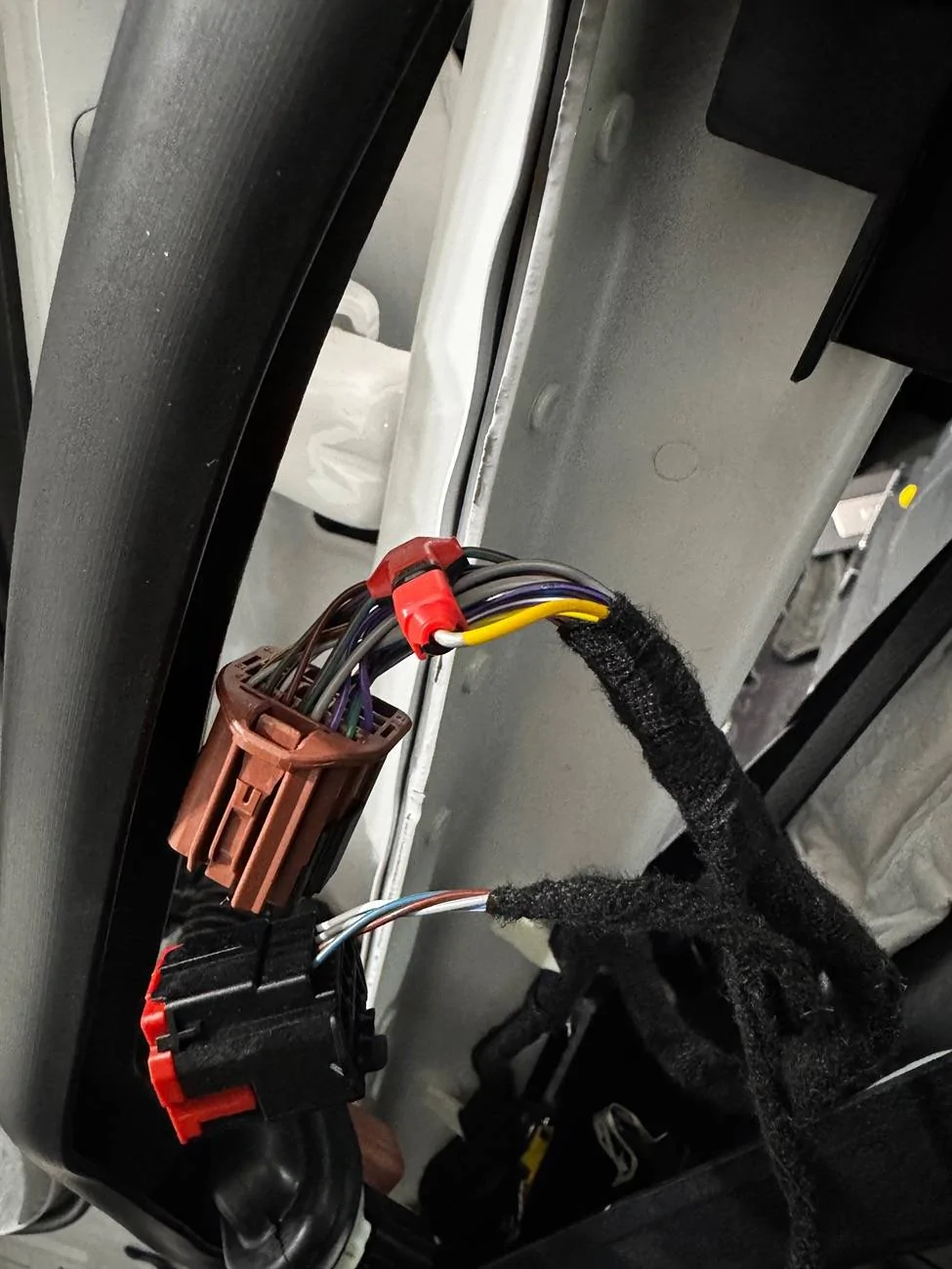

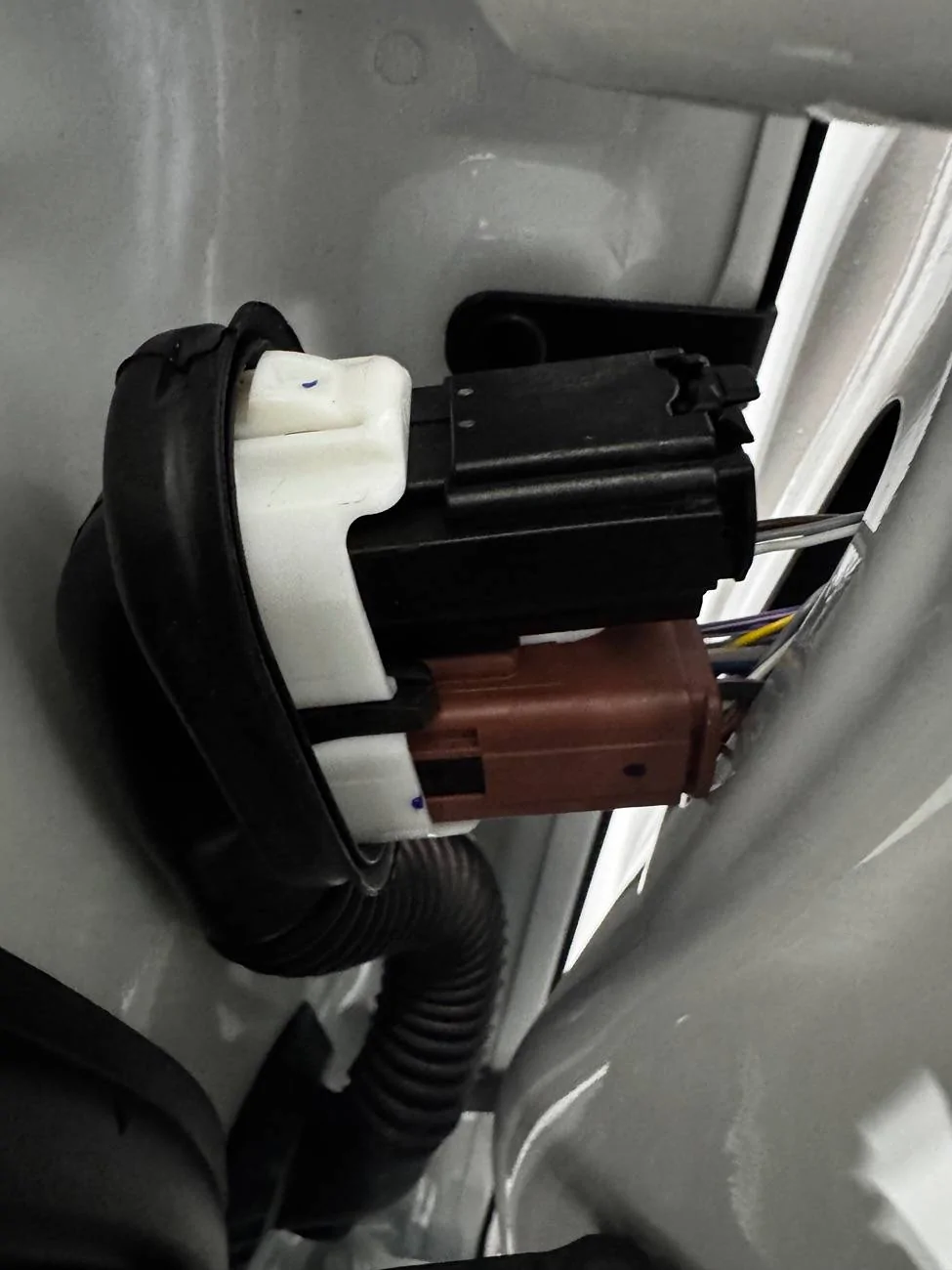

  4. Yellow wire connection for factory key fob operation:
    The yellow wire is used to integrate with the factory key fob. The connection point varies by model:
    • For F-150s (including Lightning and Raptor), the wire is located at the driver’s side B-pillar, on the brown plug.
    • With the plug's tab facing down, connect the yellow wire to pin position 4 (bottom row, 4th slot from the right). In my F-150 Lightning (2024), the wire was brown with green.
