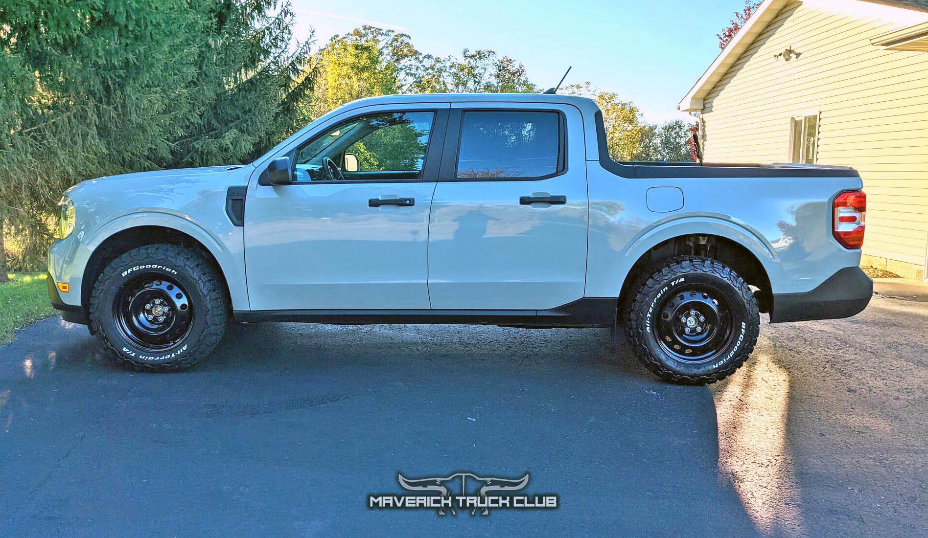

Any reason (other than some range loss) that I can’t put Bf Goodrich all terrain tires on my lightning? Ive heard some people mention you need special tires that can handle more weight.
Im hoping to match this look of the Maverick.
Thanks

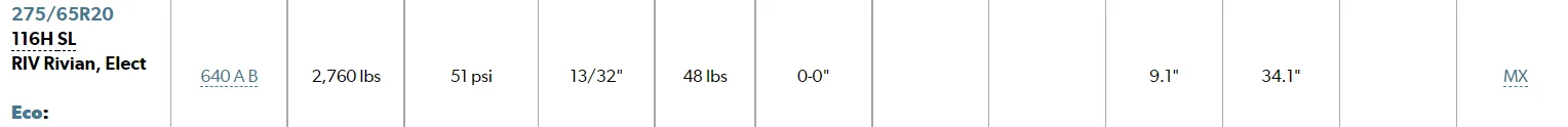

I've had KO2's and really liked them. (275/65/20's) I took a 20% hit with my 2015 Ford F150 eco Boost 3.5. On my 2021 F150 3.5 eco boost, I put on Nitto Recon Ridge Grappler in 33x12.50R20LT but they weighed 62 lbs each and was about 20% hit as well. Pretty good tire but get louder after about 10k of wear. 275/65/20's are taller than 33x12.50 and looked better to me. I ordered the AS tire but plan to run Pirelli Scorpion All Terrian Plus like the Rivain. They weight 47 lbs .
https://www.tirerack.com/tires/Spec.jsp?tireMake=Pirelli&tireModel=Scorpion+All+Terrain+Plus
