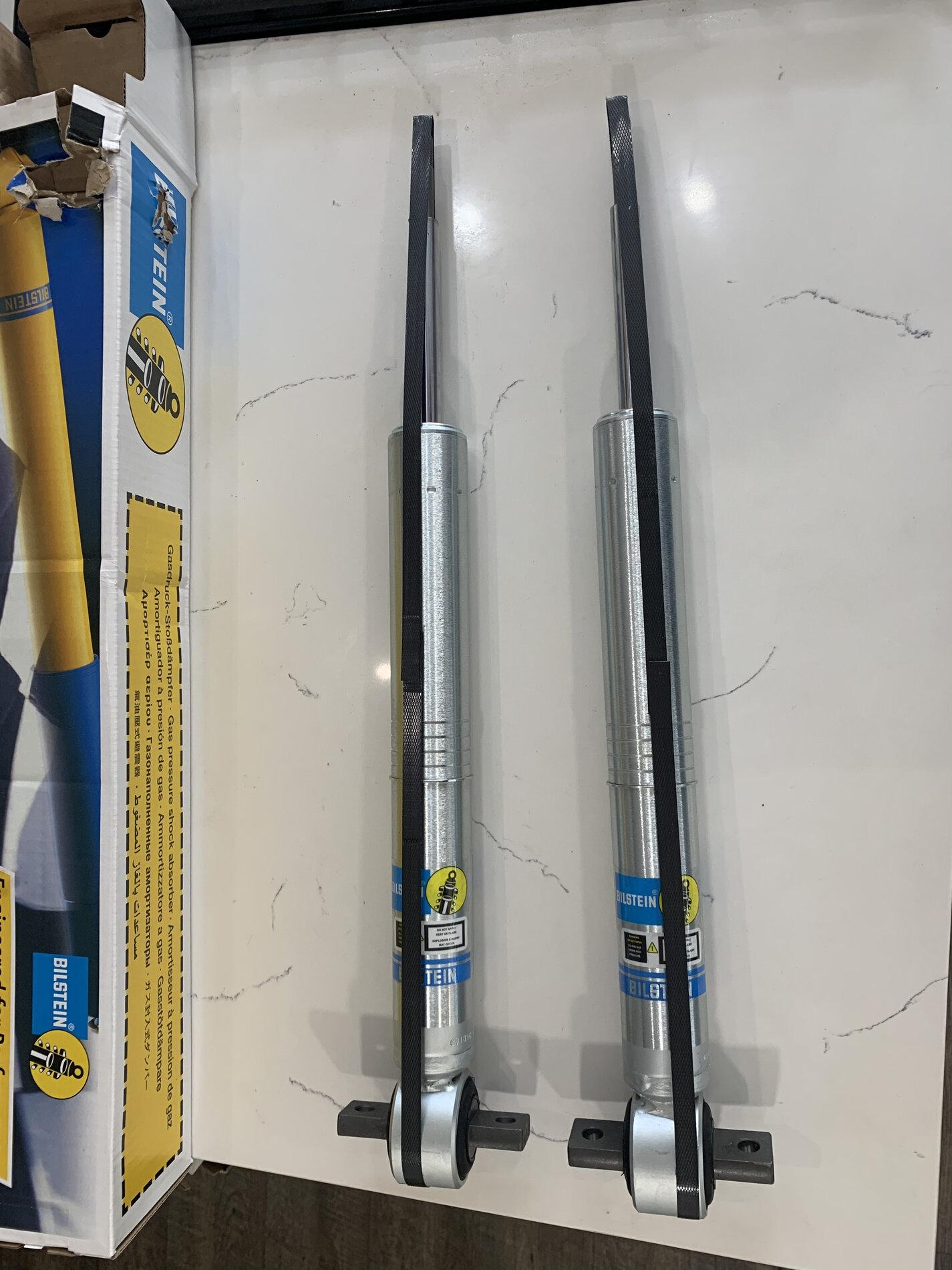

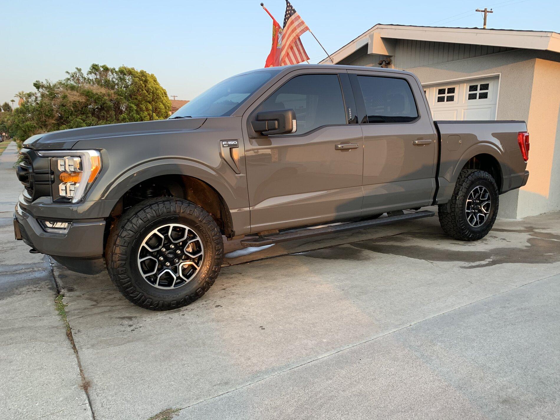

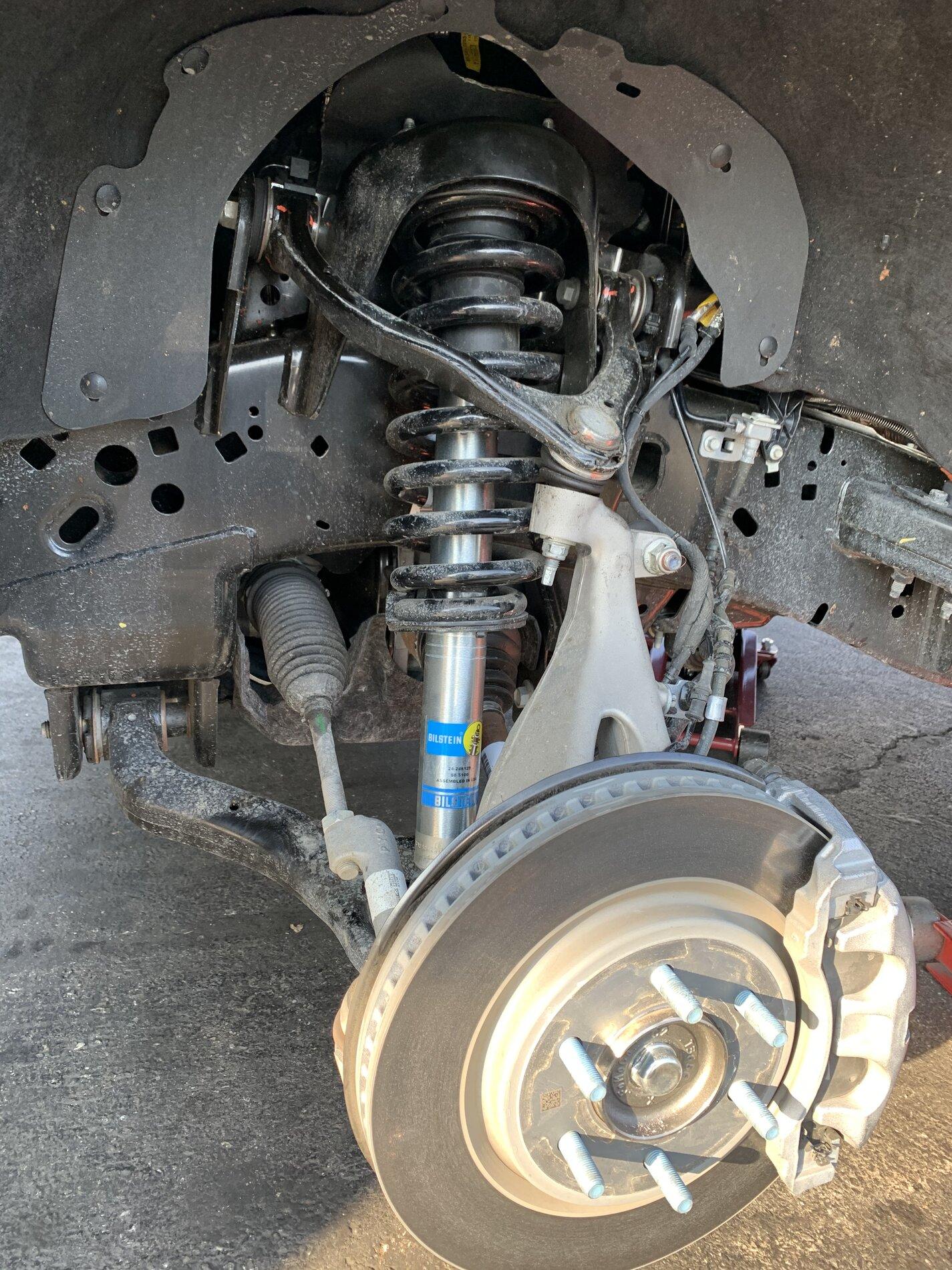

What's up everyone, just wanted to make this thread to show everyone that bilstein 5100s do in fact fit on the 2021 models. I know there was some confusion on what does and doesn’t fit on this new gen. I even remember seeing someone say that they reached out to bilstein to confirm fitment and they said that installing older gen kits on the current gen can be catastrophic (don’t see how or why).

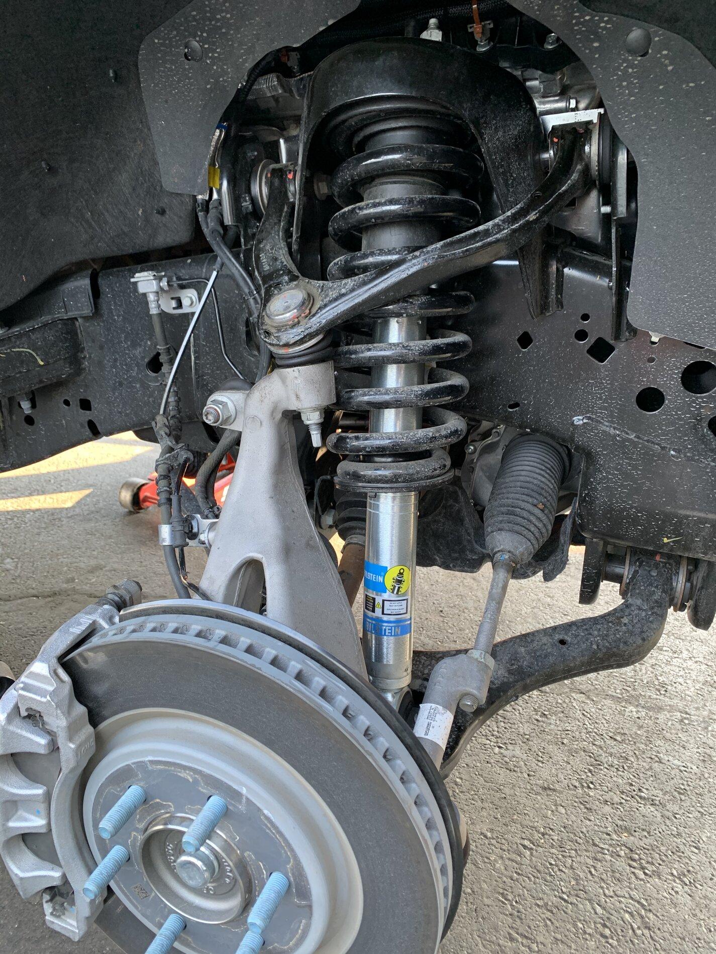

It bolts up just fine especially since you transfer over the stock springs and top hat onto the new shocks. Ride quality is more firm than stock but excellent in my opinion, very smooth and it gets rid of the stock floaty feeling when hitting bumps at speed. I’m sure bilstein will come up with a 2021 specific kit at some point with slightly different valving but at only $389 for the full set from @Stage3Motorsports I can’t recommend them enough. I will be taking my truck off roading this weekend so I will update this thread with some new pictures as well as my opinion on how they ride off road soon.
P.S. If anyone is interested in a ready lift 2.25 inch puck style spacer, I have one in good condition for sale I wont be using anymore.
