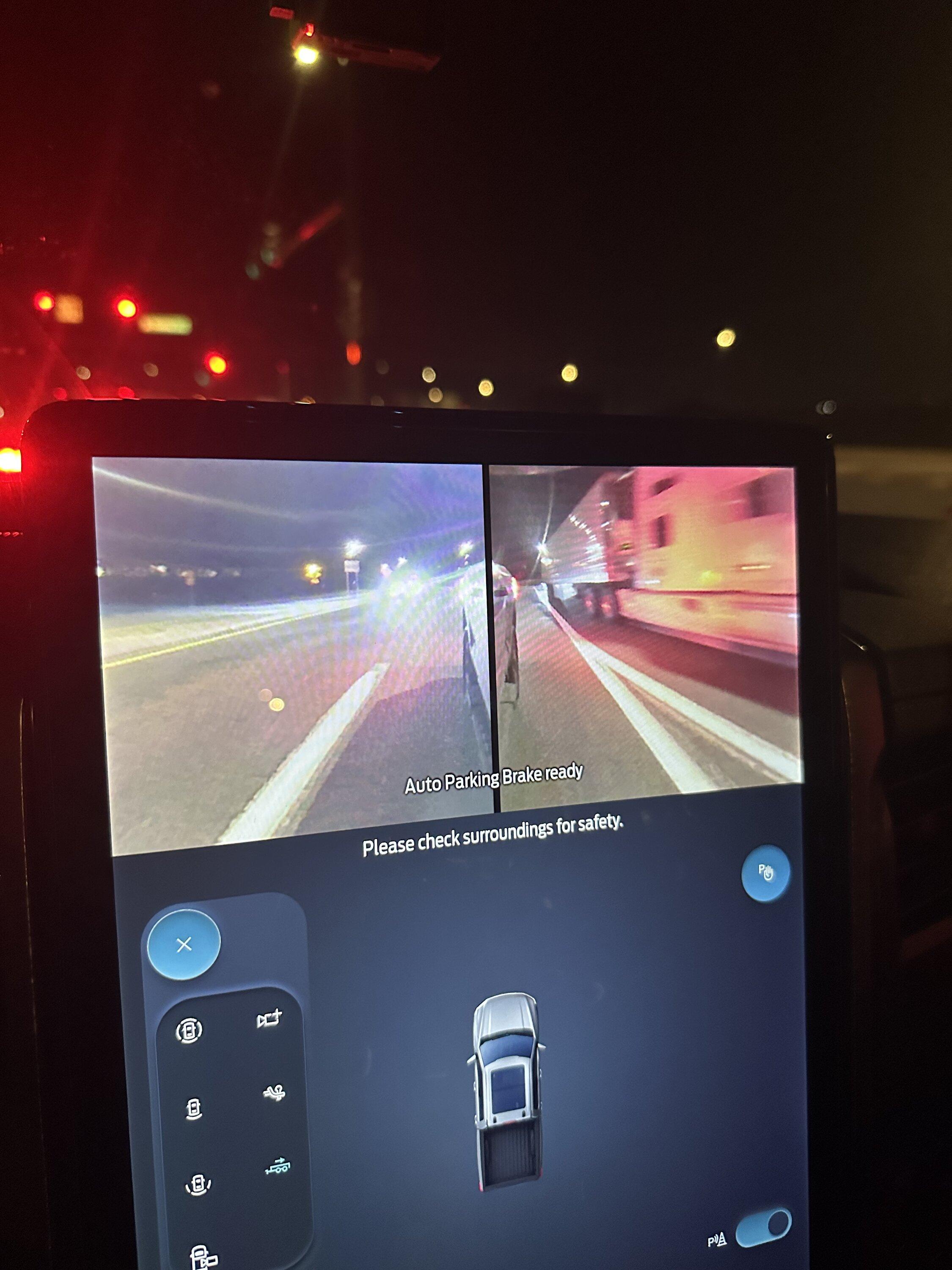

If you don’t already know, Tesla, Hyundai, and Kia have a feature that when the turn signal is toggled, a camera feed shows a live feed of the corresponding blind spot. Well, I’m sure I’m not the only Lightning owner that wants this feature to come in an OTA update. I discovered a page where it shows a view of both blind spots (it’s supposed to be used when backing up a trailer), so the camera view is possible with the existing camera hardware. Maybe we can convince the devs to add this in an update sooner or later. Here is a picture of the camera view.

This can be done. I have it on my truck. I am not sure if it works the same way on the Lightnings, but I would assume so. On the ICE trucks: If you have a 2023, it should just be a few FORScan changes to enable it. If you have an older model, it becomes more complicated. It requires side-loading the IPMA software from a 2023 truck with FORScan, and then FORScan changes to activate the feature and add the toggle switch to the APIM to turn the feature on and off. This works ONLY while towing, unless you can trick the truck into thinking it is always towing by plugging a low-draw light to the trailer harness plug. All credit to antho on the ICE forums who is the one that figured this out.
https://www.f150gen14.com/forum/threads/turn-signal-cameras.7375/post-375921
Edit: If you really know what you're doing, with the 2023 IPMA software, you can use FORScan to enable Bluecruise 1.2. I do not know what FORScan changes need to be done to enable that, though.

I can tell you from experience that this feature is great. At night, the camera view in the touchscreen is much brighter than using the mirrors. This also provides a benefit to people that may not have the best eyesight by providing a larger/closer image of what is being towed as opposed to looking at the mirror.
Whether someone finds this gimmicky or not, the fact is that our trucks have the hardware for this and Ford can easily give it to us if they wanted to. There is a toggle under the driver assist menu that allows you to turn it off if you don't find it useful.

Reviving an old thread here but has anyone successfully done this with a Lightning? Such that when you use the turn signal, the side camera comes on the screen?

Yes, however you do have to have a trailer wiring harness, or something, plugged in for it to work. I think it also disables Bluecruise and Lane centering since you are "towing".
Its been a while since I did the mods but it was just a few relativly simple FORSCAN changes. They should be listed in the FORSCAN thread.

Thanks for confirming. But that’s too bad it kills Bluecruise. I know there’s another forscan mod out there to be able to view the two mirror cameras side by side on the screen while driving, but that doesn’t work off the turn signal. It’s just manually set on or off. Ford seems so close to being able to just enable this to work just like a Tesla turn signal camera works, but alas.

Correct. The way it is coded in the IPMA, there is no way circumvent the trailer requirement. The changes are in the common tab of the FORScan spreadsheet, but the IPMA has to be at a certain level for it to work.

If you make the changes and it does not work, then the IPMA needs to be updated. Nothing bad would come out of trying.....you would just get a button for it in your touch screen that you won't be able to turn on.
