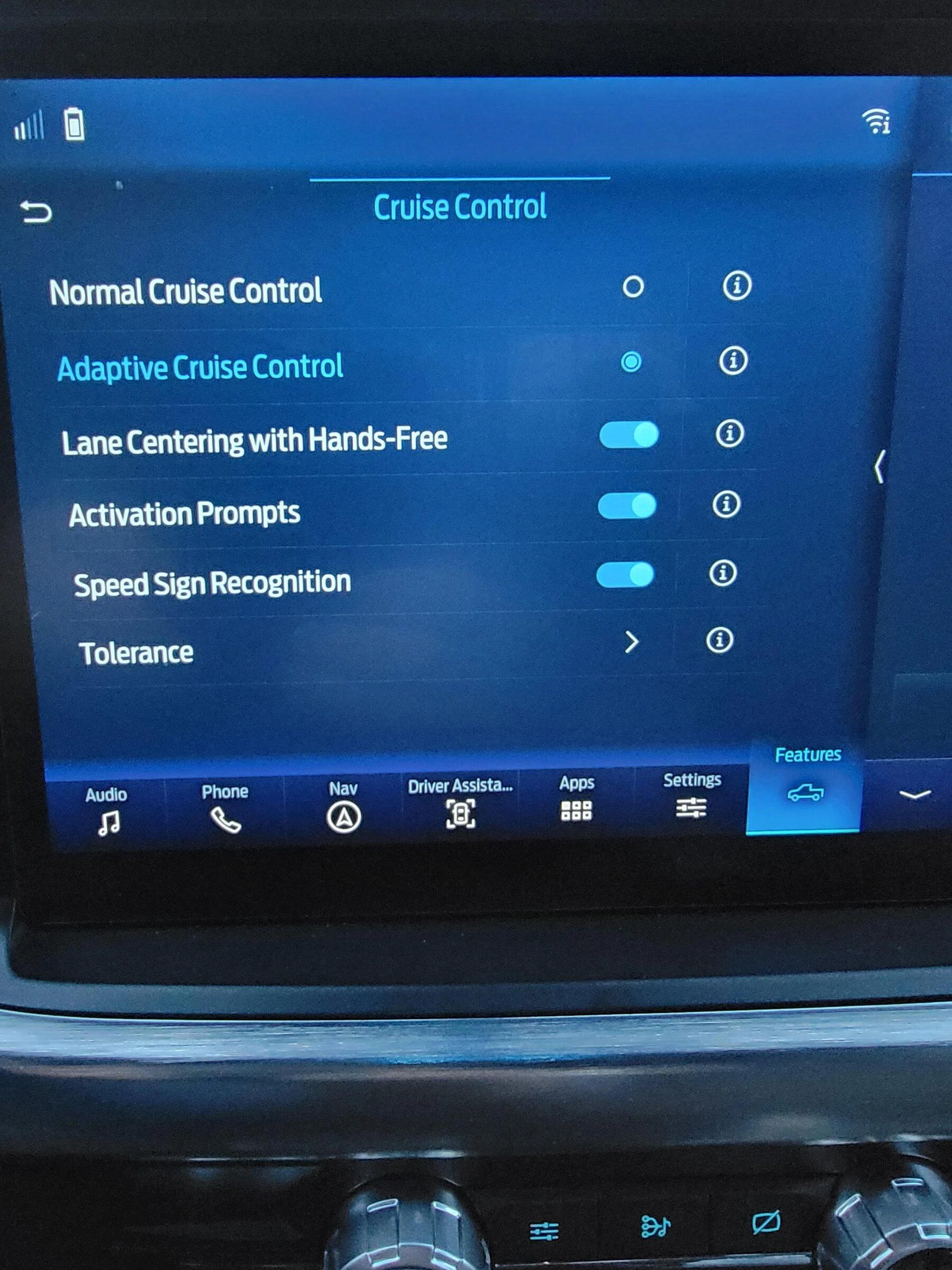

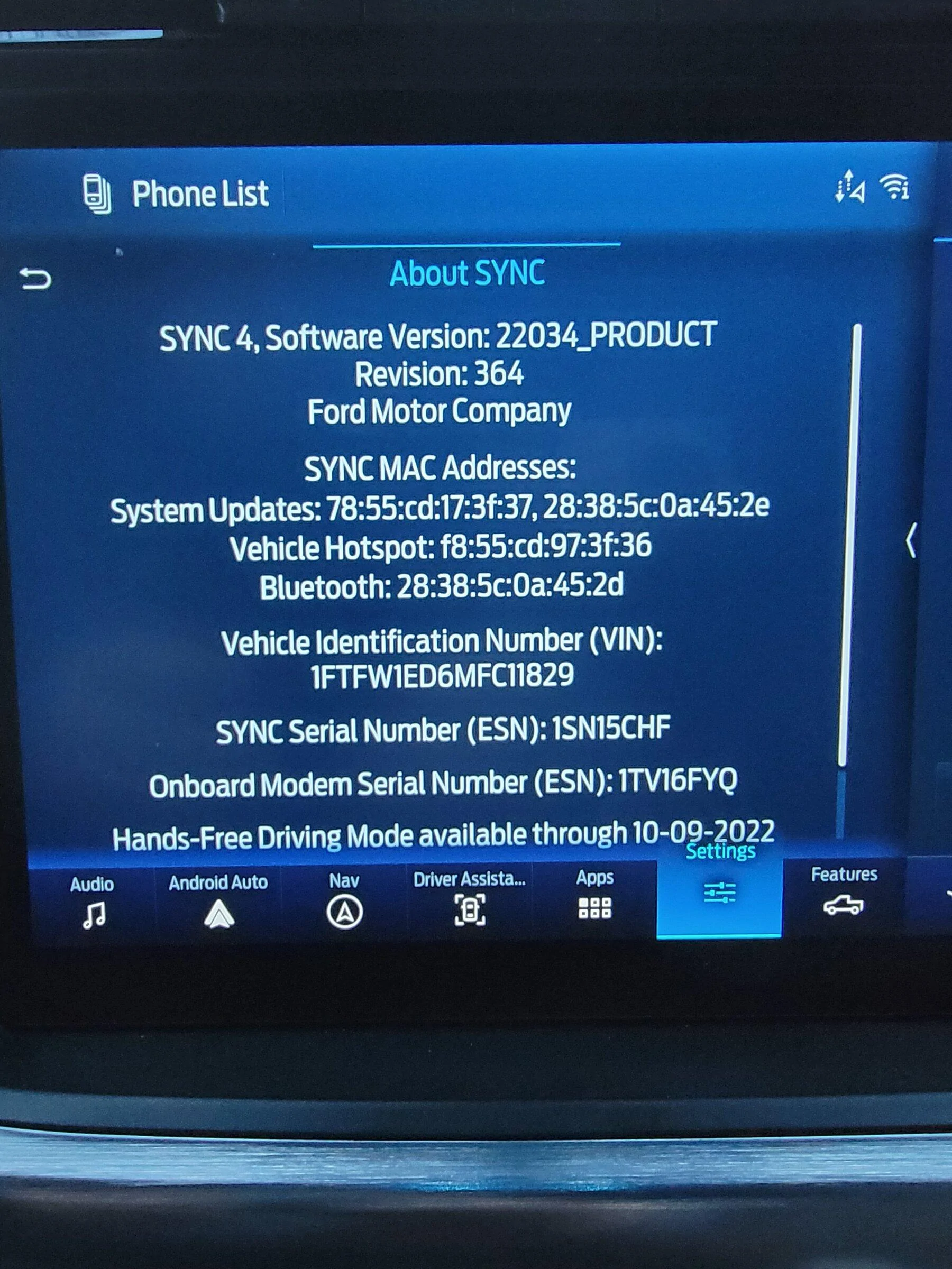

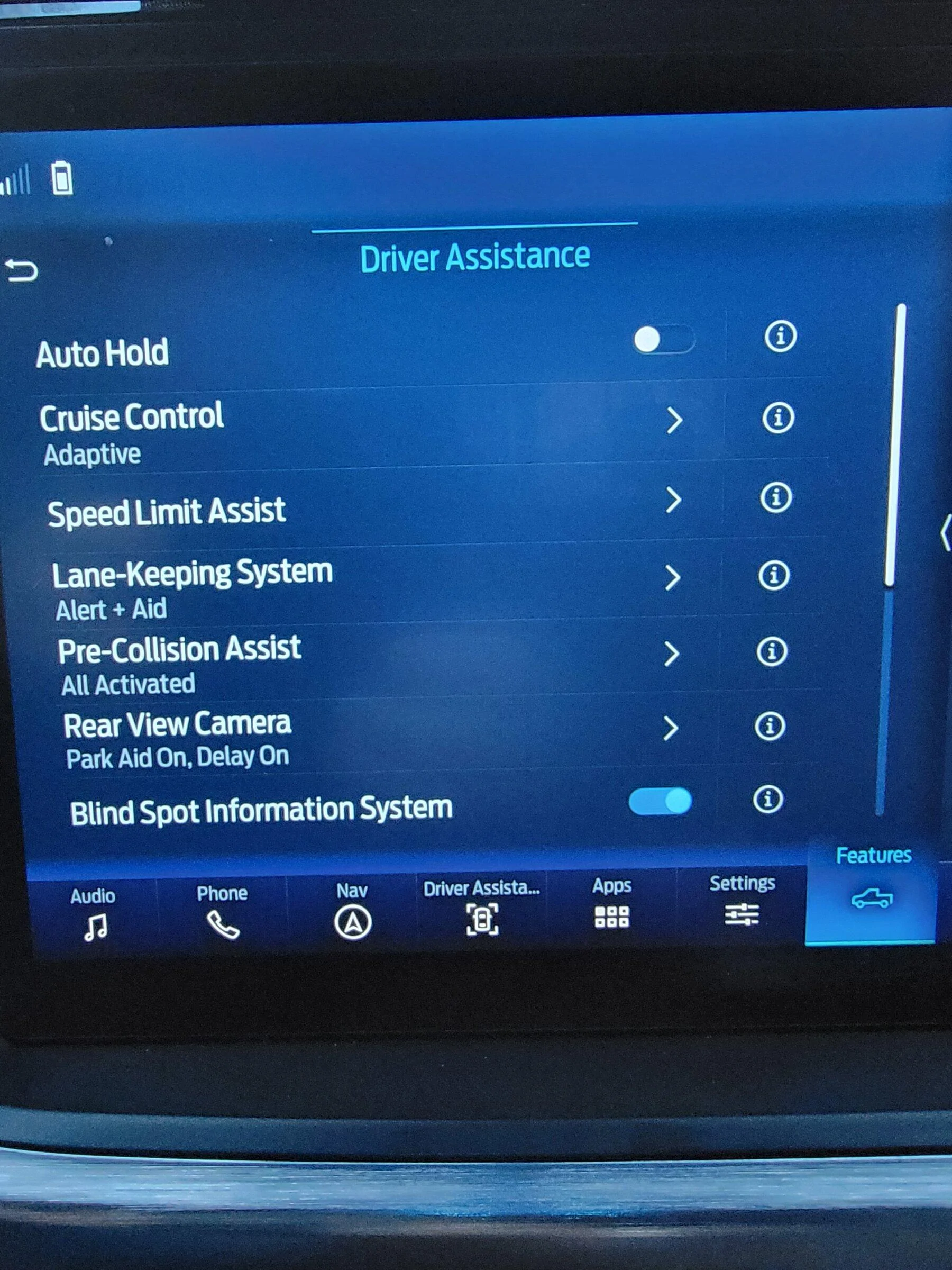

I just can't see to get the handsfee to work.
Thanks to all the folks on the ECR module progamming guide thread (https://www.f150gen14.com/forum/threads/ecu-module-programming-guide-using-fdrs.8249/unread) I was able to easily upgrade by Job 1 2021 F150 without much issue. Everything seems fine. Under Sync/About it shows the Handsfree valid through 10/2022. I even get prompts on the dash that Blue Cruise is available, however it never allows the handsfree option. It still requires my hands on the wheel. It does however monitor whether or not I am watching the road and warns when I do not.
At first I thought maybe for some reason the section of I65 I drive everyday was not on the approved Blue Cruise roads, but I did a trip on I64 today as well, with the same results. I have no errors, all the appropriate settings are enabled in Sync. All of the updates are applied with no issues. I have even reset Sync and FP just to rule everything out.
Any thoughts on what I might be missing?

Well, just save everyone asking to verify settings, maybe post pictures of all your sync settings and about screen.

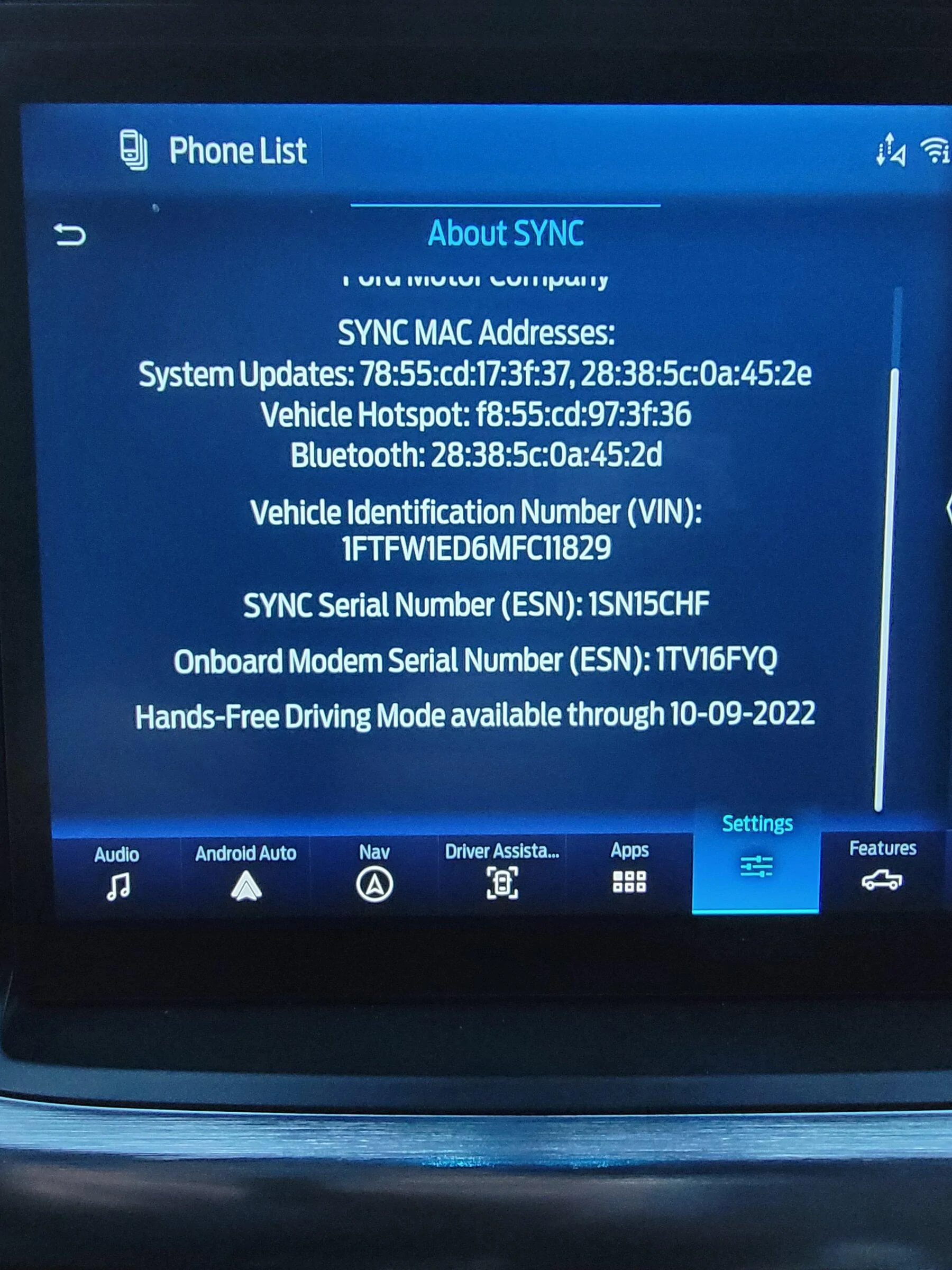

Good idea. Here you go.

That all looks good. It would be a pain in the butt to set everything back up, but I might try a reset on the APIM.

Looks like you aren’t truly active?
the date should be a year from when it was activated that date is a place holder? I may be wrong I don’t have BC but isn’t it suppose to update to march date?

You have lane centering on in the settings but have you tried activating it with the button on the wheel?
