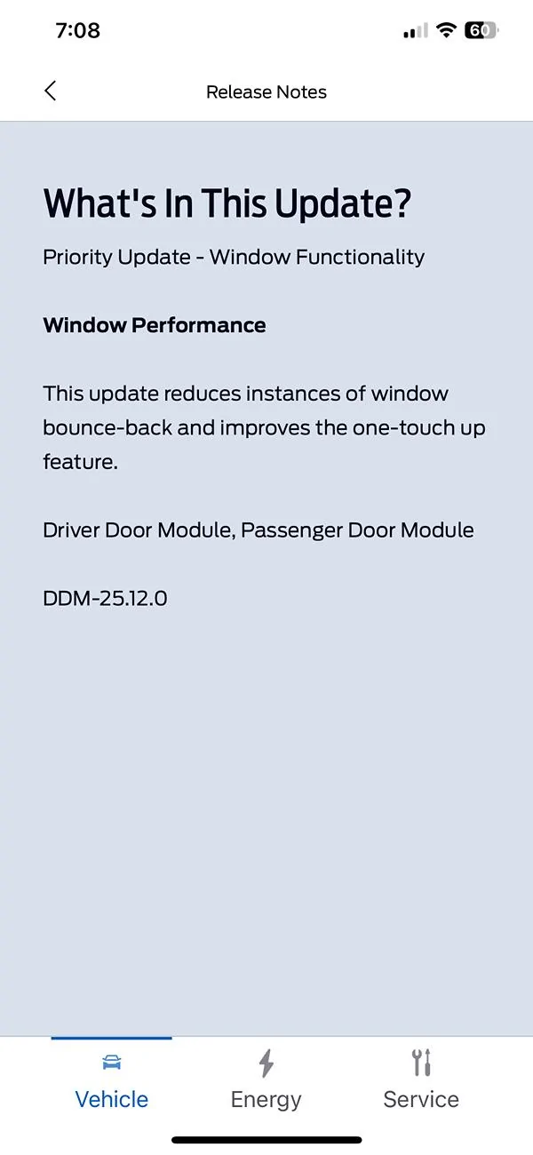

Do you keep track of your OTA updates, do you recall what you received around that time?
What is your most recent OTA update?
dserway
Jan 12, 2024
F150 Lightening 2022
Consultant
Yeah not sure it is set to automatically update now truck is in the shop. April 15th was this one:
Ford F-150 Lightning Blue Cruise Not Functioning IMG_2353
194
14,436
15,719
Good to see your truck is just about following the same deployment as mine, I got the above on 4/9.

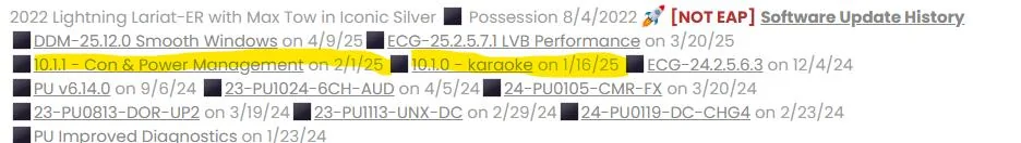

These are my most recent updates, note the ones around January & February 2025 in yellow below, not certain there is a correlation, because my Blue Cruise & Hands Free mode are working normally.
Ford F-150 Lightning Blue Cruise Not Functioning 1746919066076-z3
