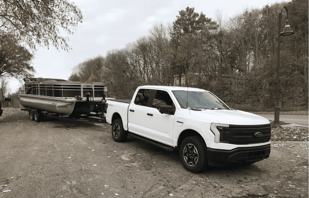

Have not pulled our 26' Bennington far enough to get good stats, but with the 21' Nautique wake boat, highway mileage is around 1.1 mi/kWh, less if its cold.
The truck pulls great. Walks right out of the lake with zero effort. With the weight of the truck and rear suspension, you will hardly know a 6000 lb boat is back there.
My only nit pick being I wish there was a button for engaging the locking rear differential easily on the boat ramp without having to dig in the menus to find it.

Ford F-150 Lightning Boat Towing Advice 1703733470377
