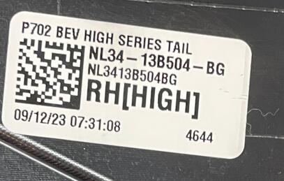

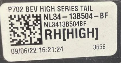

Well, now I'm seeing something interesting. The dealership websites are starting to list new tail light part numbers for both versions. The online catalog numbers originally ended with "B" for the Pro/XLT version, and "C" for the Platinum/Lariat version. Now it looks like there are "G" and "H" versions replacing the "B" and "C" versions.
I wonder if there is any functional difference.
So looking at this passenger lariat replacement lens, which looks correct visually, but part number is NL34-13B504-BG, emphasis on the BG
Anyone have any idea on this, not seeing anyone else talking about the part number
I think the last two digits are just newer versions of the same part, it's the middle part that is important. I put a BG in my '22.
Here is my '22 Lariat that I cracked (BF):
Ford F-150 Lightning Broken rear tail light (my fault) - instructions on how to move BIS sensor to new tail light 1738946961112-v0
And here is the replacement that I bought on eBay that works (BG):
Ford F-150 Lightning Broken rear tail light (my fault) - instructions on how to move BIS sensor to new tail light 1738947113819-63
The main thing is it should say BEV High Series. The XLT and Pro have Low Series.
