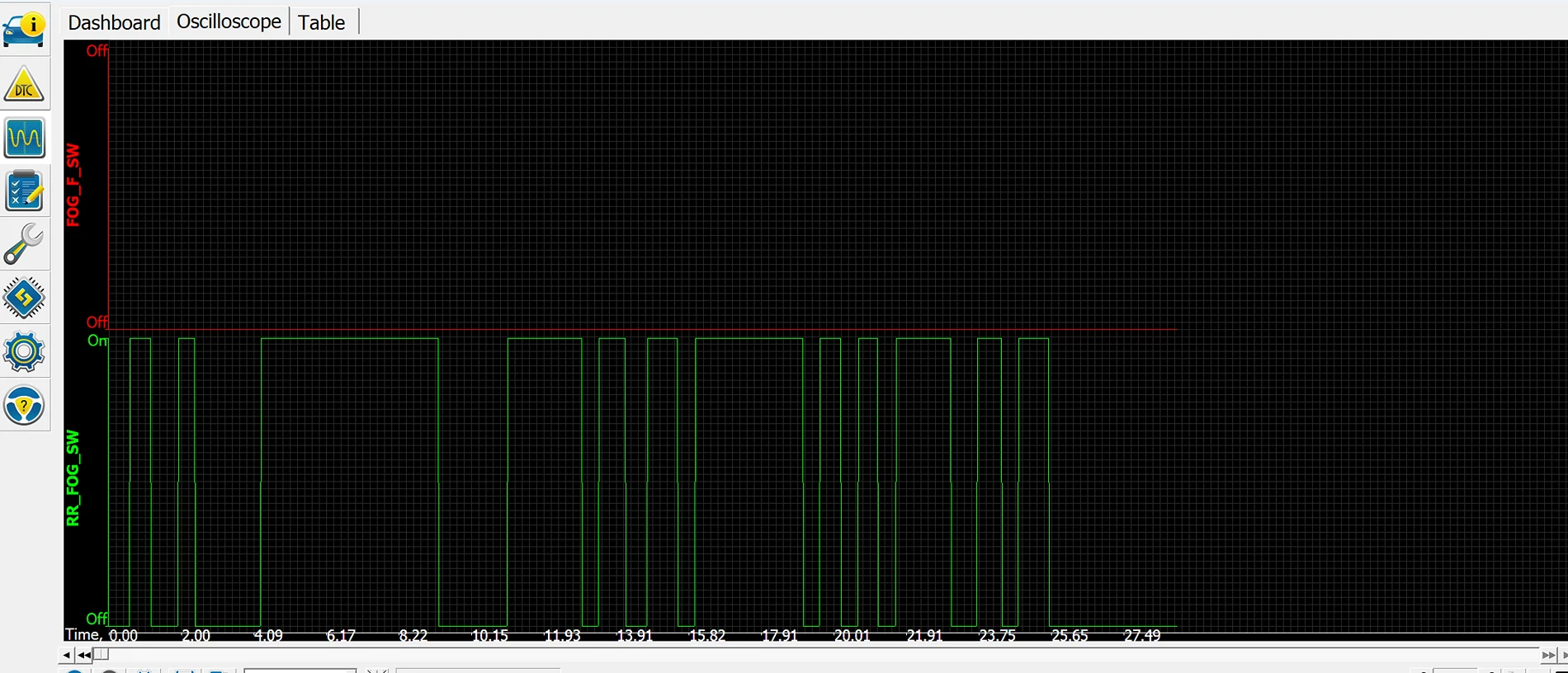

So I took the plunge and picked up a switch for factory-style front/rear fogs. My ultimate goal is to implement front-fogs in the lower grille as some others have done, but have it tied to the light switch.
So far, it's just the switch install, and some FORsacn tweaks, giving me front fog IPC telltale and auto-cancel for front fogs for when I actually install them. I will need to wire up a custom loom between front fogs and BCM -the factory manual seems to suggest it should work if I run the appropriate wires. (and relays)
The rear fog light switch and tell-tale have been enabled in FORscan, but they're not toggling on the IPC like the Front fog. Interestingly, I had a play yesterday evening with FORscan and was able to track the switch registering as a rear fog switch push (momentary only, so it showed ON when pushed and off when released).
Ford F-150 Lightning Built-in Fog Light Switch (Front/Rear) Installed Fog Rear Switch working
I was also able to send the IPC the correct CAN code via FORscan to turn the tell tale on and then off again, so if for some reason my plan of trying to get it working factory-style doesn't work, I can program something on the can bus to latch the rear fog and activate the tell tale, using an aftermarket relay if required.

Thanks all - I'm wondering if there's lessons to learn from our Bronco cousins. They do have the option to add rear fogs, and I'm wondering if the lack of tell-tale on the IPC for the Rear Fog is part of a code issue, or just because I don't have anything plugged into the right BCM circuit for this.
Given that the Rear Fogs use a PWM controlled circuit, I wonder if it's just seeing an open circuit and therefore not showing it. I did some more digging into the FORscan thread on this one - and I think it's going to be a while...

I did some more digging, and I am not 100% sure we can add the rear fog just from FORscan changes. What I need to do in order to be 100% sure is to order some pins to add the relevant pin connector on C2280C - which may only operate and latch if a load is detected on it. My current plan of action is to grab the right pins, then add a pin to C2280C (pin 25) and see if it's possible to drive a 12V load via what should be a FET driving that output pin. Since it's a FET, I'll have to make sure it's a small enough load to not cause issues.
In parallel, I'm going to capture the raw CAN/LIN bus traffic when the rear fog switch is pressed, which will tell us exactly what message the BCM is receiving. If the load test doesn't produce a latch, that CAN data will be the foundation for an ESP32-based middleware solution that can handle the latching logic independently of the BCM.
TLDR: Because the switch DOES register a rear fog switch press (but not a latch) that transmits on CAN/LIN and seems to arrive at the BCM, we can listen for that with a separate device - and then SEND the "illuminate the fog light dash icon/tell tale" to the IPC. We can also build some latching logic based on if the truck lights are on or not - which would be required to prevent the rear fogs coming on if we don't have the headlights on. That's a legal requirement in Europe that I'd like to mimic here.
