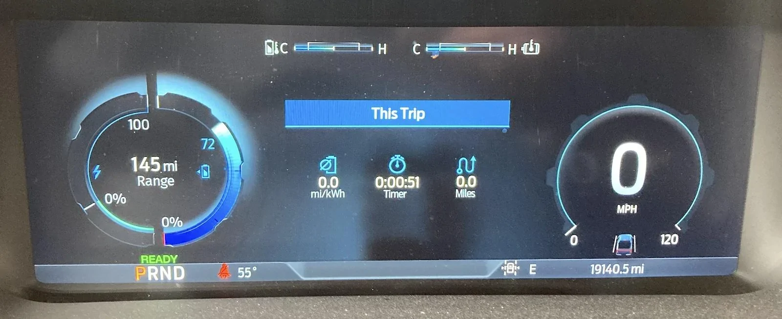

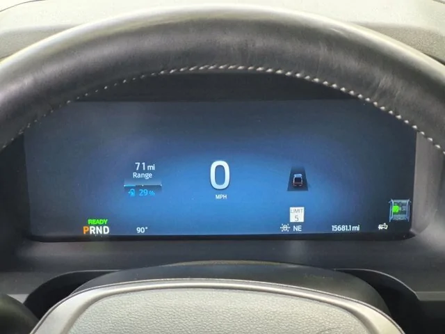

On the truck he found, what's up with the gauges? first pic is of the truck he is planning to buy, second is what mine looks like.
Ford F-150 Lightning Buying used, what to look out for? 1780487368118-3a
Ford F-150 Lightning Buying used, what to look out for? 1780487235651-t5
234
16,626
18,776
Calm mode, it's switchable.....
