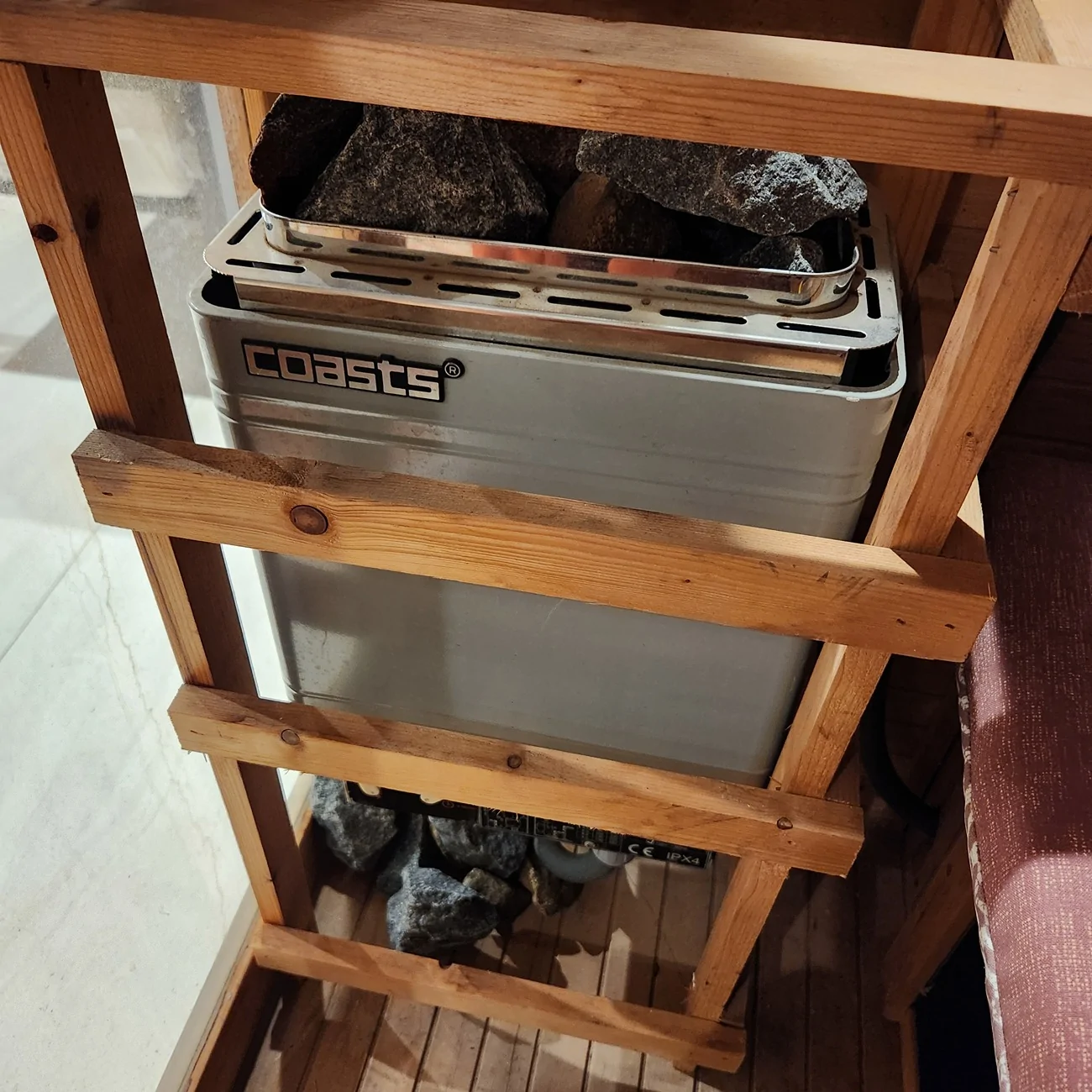

How are you determining your panel capacity? Just adding up the breakers isn’t the right way to do it, if you have the standard 200A power you should be fine. You can probably get an estimate from an electrician which would at least give you this info.
It doesn’t really matter if it is 120V or 230V, 30A is the same either way as far as your panel is concerned other than that the 230V takes two slots. You can probably free up a slot by using a double breaker for two of the 120V lines - but electrican help would be best because there are some possible small complications.

I take it the experts don't consider a sauna a continuous load and as long as one orange is less than two apples you're good to go ?
Calvin H-C
Calvin
Dec 15, 2022
334
309
I'll have to check the rating on our sauna's heater, but it is on a 30A circuit, which under the code can sustain a 24A continuous load (the 80% rule). That makes for 5760 watts at 240 volts. It's possible a sauna heater is not considered a continuous load as it cycles on and off plus it is only used for short durations, but let's assume so for worst case analysis.
Given that the ProPower 240 volt outlet is rated for 30A continuous, it should have no problem powering a similar sauna heater.

6000W @240v = 25A. The 240v outlet will handle it with no issue just don't run anything else on that circuit while the tub is running.
Ours has a 5KW heater which is a little over 20A and specifies a 30A circuit. Yours is likely similar as 5KW is a common size.
But a sauna is not a continuous load and thus not subject to the 80% rule. Mine takes 20 minutes to reach 170F, then cycles at about a 5 minute on / 5 minute off rate.
