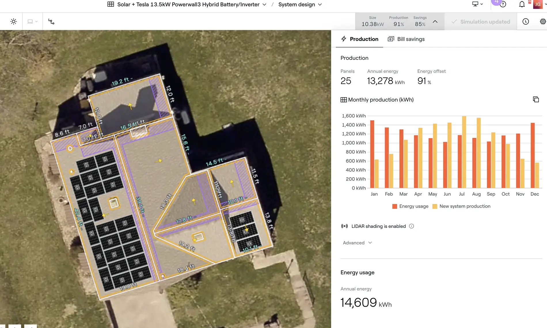

22 x 440W panels West facing roof. 3 x 440W panels on South facing roof. The other day, I saw 9kW/second output on a sunny day. Before that, the most I saw in Nov through Feb was 7.8 kW/second. Sun is getting stronger, and I expect I should hit peak soon enough.
On 3/8 and 3/9, I generated 42.3 and 40.5 kWh with my system. From March through end of October, I have NO shade on the roof. From Nov through Feb, I get some partial shade starting around 2:30pm to 3:30pm. It does cut production in half, so I've been thinking about lopping off the top of the trees that are responsible (pine trees).

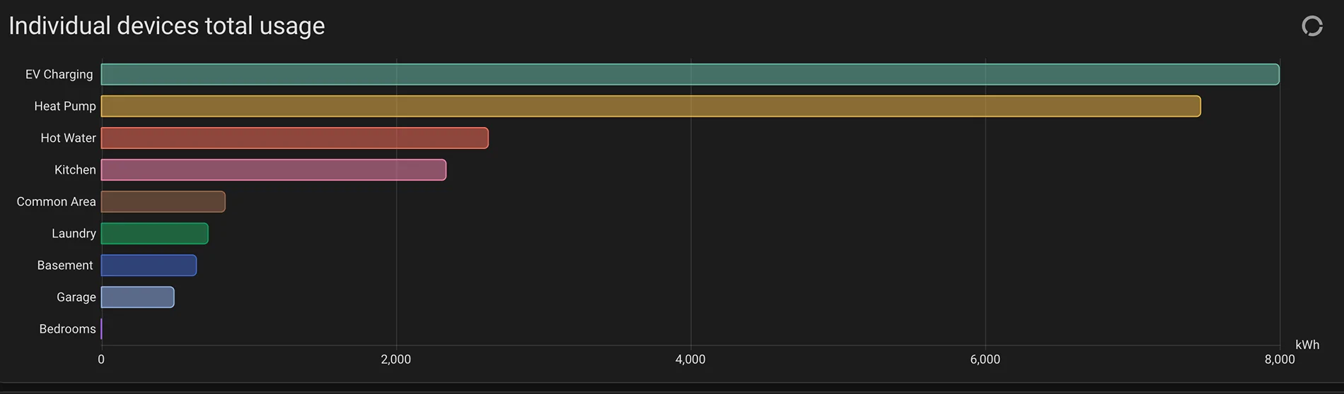

Well I have 25kWp of panels, no storage and produce roughly 26,000 kWh per year of energy with snow soiling, cloudy climate and shading.
I break even with an all electric house, geothermal heat pump (7500kWh/yr), and a Lightning and two Mach-Es (8000kWh/yr). I think you are fine unless you add more EVs or have electric heat.
Your system is more than double mine. Our heat is gas furnace, with our attic supplemented by a mini-split. Wow, your EV charging year energy usage is 80% of our current household usage. I can see why you have such a large system.

I believe they put our total usage at approx 14,609 kWh. We should produce 13,278kWh, for a 91% energy predicted energy offset. That's why I want MORE panels. By adding 10 more panels for a total of 4.4kW instant, I would hope my production jumps to 18,589kWh. I think between that and net metering, it should completely (or almost) offset at home EV charging
Not after you upgrade.
Sanity check, 8000kWh times an estimated fleet average of 3 mi/kWh is 24,000 niles. That 8000kWh is measured at the panel, more like 7200kWh in the batteries after charging losses.
3 miles / KWH is being VERY optimistic. The people who deal with seriously cold weather will drag the fleet average down a lot, but even here in southern California, my first year averaged just a hair over 2.3 mi / KWH.
You are correct about the 8000 KWH at the AC panel being ABOUT 7200 KWH to the batteries is about right.
I hope I am wrong but seems like the production estimates might be high for Pittsburgh. Similar latitude to me in the NY Finder Lakes, similar weather too. Mine are ground mounted so perfect south direction and optimal pitch, roof determines these values and likely less than optimal.
This Dec I did 571 kWh, same as they estimate for you and I clean , off the snow if the forecast is for a day of sun, 6 years of data the Dec range is 571-770 kWh. Hope they are accurate, I certainly know you can't have more cloudily weather than I do.
