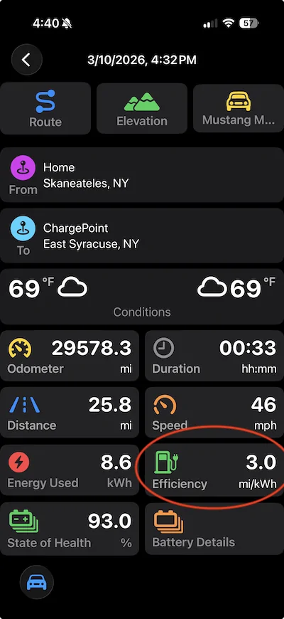

I have two Mach-Es in the mix so my fleet average is better but it was just a number picked for easy math. Also I wrote the app to know exactly how my Ford EVs perform. This was downhill, the return was 2.6 mi/kWh.

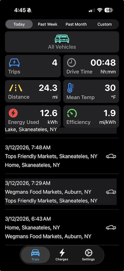

Today, in freezing temps, the Lightning is averaging 1.9 mi/kWh over 4 trips:
