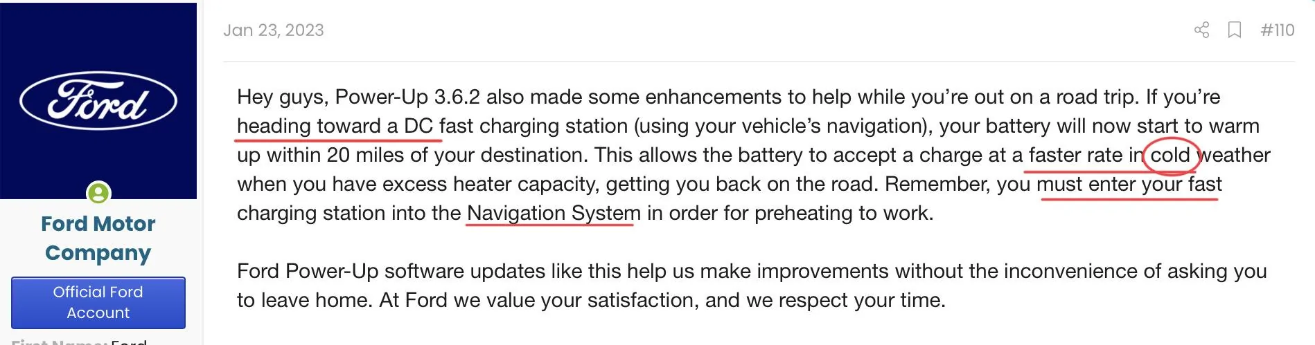

No, the only option is to use FordNav and point it to the DCFC (or a nearby one if heading to a SC).

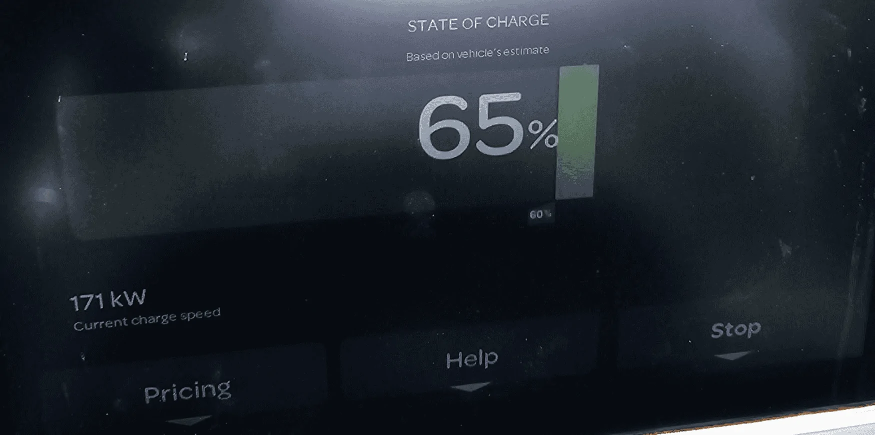

PARKED :No, at least from my experience in moderate New England summer, garaged away from sun. All the energy I see is related to cabin conditioning or topping off the battery if you don't have highly restrictive TOU time windows.
DRIVING: I've haven't done much hot weather tripping, but I had great charging curve performance a few weeks ago, using Ford navigation directly to an EA station in the Berkshires.
